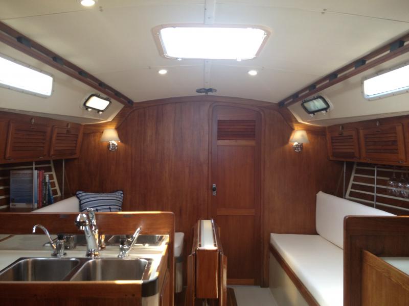

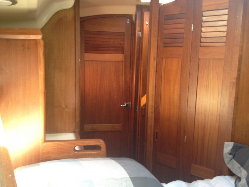

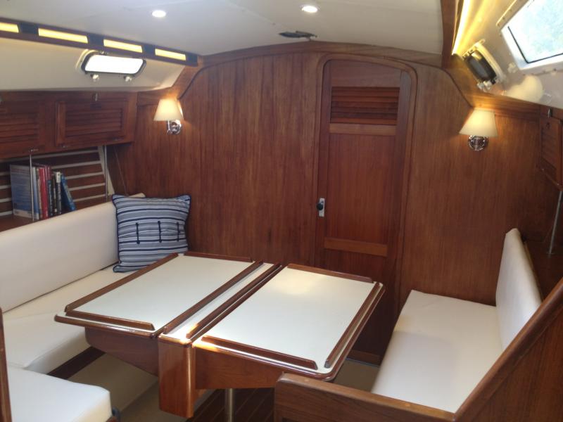

I'm a paint/finishing engineer and find this thread very interesting. Some good points here, I'd like to add a few.
I'd have to say that Shellac would not be my first thought when refinishing the interior of a sailboat but it's really not that bad of a choice. Much like teak oils, it’s very easily repaired and can re coated yearly if desired. I'd have to say it's a preference not a misapplication.
Just keep in mind that technology has moved on a long way since Shellac was the finish of choice. I'm sure it likely contributed to the invention of the coaster.
I used shellac as a sealer when I refinished my boat. It’s a great odor stopper. I used it for any unfinished wood. (under cushions, mattresses ETC ) It gets rid of the OLD boat smell without replacing the wood. Sealed the lazarettes (SP?)after I took a power washer to them. I also sealed the engine compartment before I re-installed the sound dampening material.

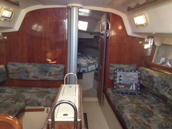

As for the original question about the gloss finish on the interior of an O’day. I think it is great as long as it was done well. You could easily apply a coat or two of “Epiphanes rubbed effect” over it to give it my favorite interior finish. See attachedhttp://www.jamestowndistributors.com/userportal/document.do?docId=959 A true rubbed effect look without the work. I used 2 to 3 coats of gloss under the Rubbed Effect varnish and got a great look. 7 coats would be that much better and a great look for a Clorox bottle type boat. (no slam on O’day, same goes for Hunter Jeanneau, Catalina, Beneteau etc.)
Here is a photo of my O'day with the Rubbed effect varnish. You could easily change the look of the boat you are considering with one or two coats. And I agree, Any well finished Teak (regardless of product) looks many times better than wood (like) product used on new boats. The best way to save resources is to make the best out of what we have. A tip of the hat to all of you.
