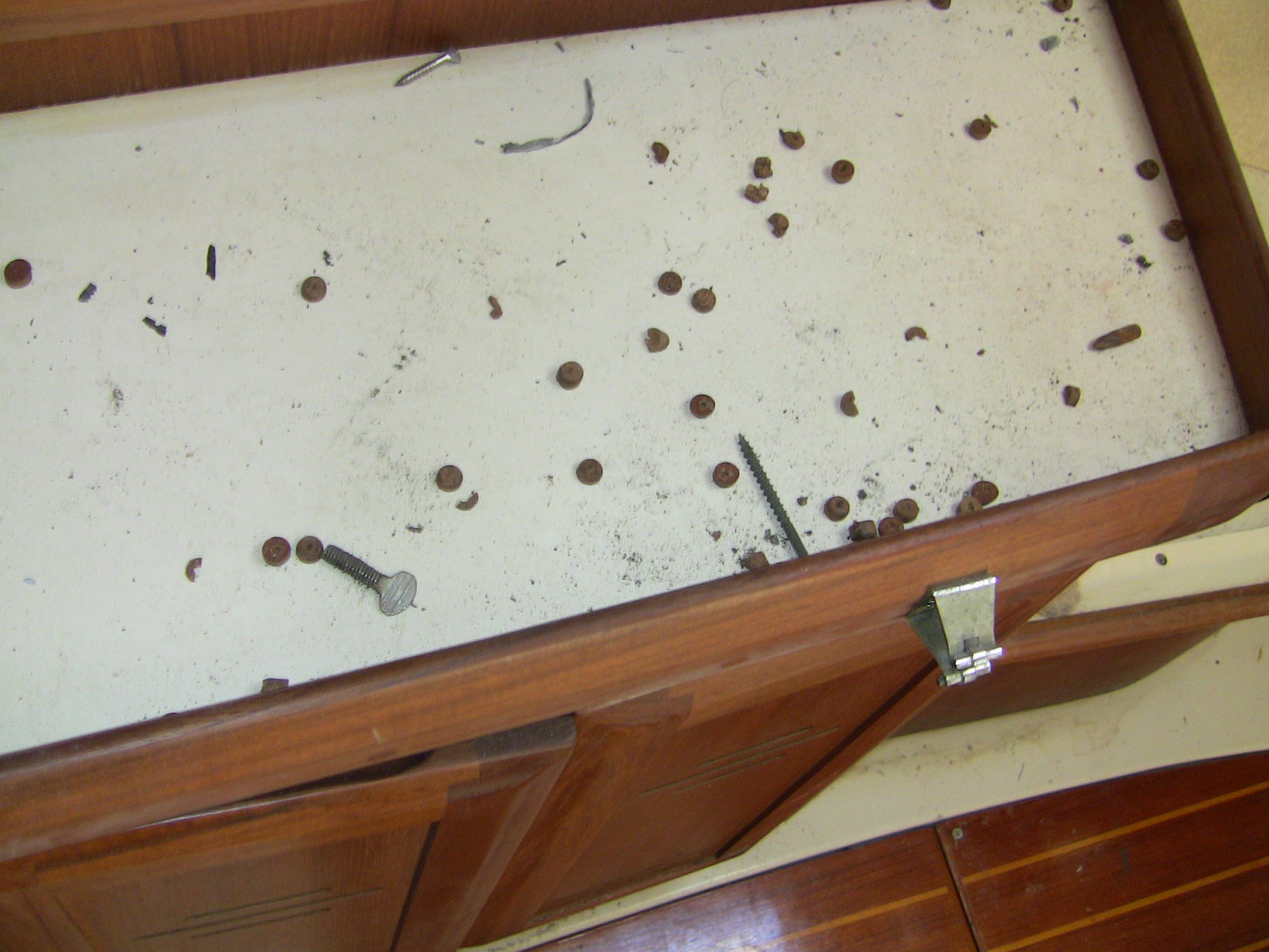

I've had to remove some screw hole bungs to do some work and have teak bungs to replace them.

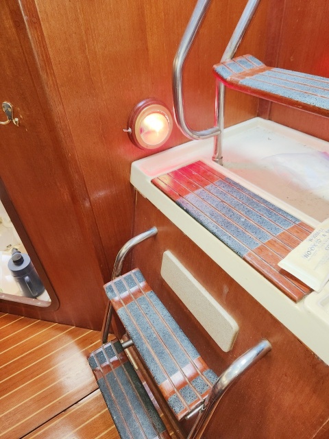

OK, @smokey73 , AKA Dan, I looked into my archives of random and often useless h40.5 notes, and I have found the products that I was told were used on my 1997 model. For your 1994, YMMV.
For the Floor: Dalys Profin Oil
For the walls and cabinets: Dalys Seafin Teak Oil
Both are available on Amazon

Thanks @Rich Stidger and @JamesG161 I used the Dalys Profin for the Cabin Sole and it came out great! I also used the Dalys Seafin to refresh the Cabin and that looks great too. However, the Seafin on the bare or sanded wood where the plugs will be installed is just a little too brown. I am experimenting with some stains and right now it looks like the Minwax Gunstock is very very close. Now I have to put several coats of the Seafin and see what the finished product looks like. I can adjust the color with a drop at a time of fruitwood or cherry stain if necessary. When I'm done I'll post results.
