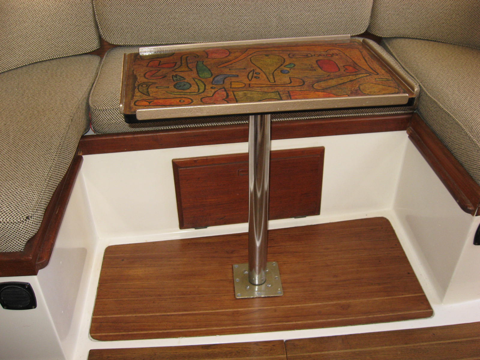

But in regards to your question in a general manner. Look for "out of the box" alternatives. With the mindset such as "It's Only a Table". Must be all sort of ways to mount it that are not destructive to the boat. Maybe only a few new hole/bolts/screws are necessary. Enough to make it secure but not to change the structural integrity of your boat. The table can be a removable feature. When not used for eating, or for the all guests to put their laptops/tablets/smartphones on, the surface also might be moved into a sleeping configuration.
Here is a picture of Hunter's 1980 table mounting setup for their 1980 Cherubini 36. Just a tube secured to the floor. (The table in the picture though is smaller which I made for my mostly day-sailing needs.) The larger original Hunter table is conveniently stowed in the forepeak. If I have some guests, I use that one. After dinner, the Hunter table sets into the spaces between the settees. I move the cushions around and the area becomes becomes a double bed.
To re-create Hunter's method on my boat: A couple of 1.5" hot dipped galvanized flanges bolted onto the floor. A couple of (say) 30" 1.5" piece of pipe to screw in or remove if not needed. Then on the underside of the table top, it doesn't take much to make an assembly that the table can just be dropped on to the pipes when the table is needed.
Of course, this arrangement won't stand up to people sitting along the edge or jumping around on it. But Hunter's design on my boat wouldn't tolerate that either!
Just some ideas.

Thanks for that idea. As I look into your photo, the berth that I see opposite was the original and you have added the extensions left and right? Great idea.
And since you are not cutting into the existing walls, you do no damage. Is that the general idea?

I've said this before but your boat is so clean!
Hello Jeff:
I am not exactly sure that your quote pertains to my input (rardiH36 4:55 pm last Friday). But if so, as I prefaced in that post, we don't have the same boat. What you see in my picture totally is Hunter's original configuration for their Cherubini 36 model. Only change is the smaller table that I cobbled together out a a large serving tray! The table's tube and it's matching floor fitting is OEM.
Alctel:
Thanks. The picture is the interior at its best several years ago. But over the past couple of years, although I haven't let it go completely, I haven't been as diligent about "keeping up appearances" as I used to be.
