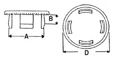

On one boat I had, I drilled holes with a hole saw big enough for a deep-well socket to pass thru. I put in plastic hole plugs from the hardware store to finish it off. Neat, simple, and inexpensive.
