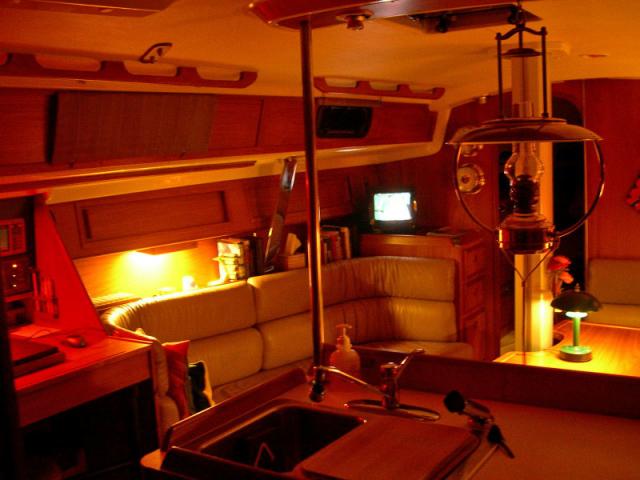

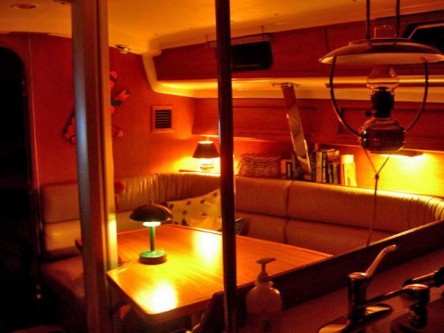

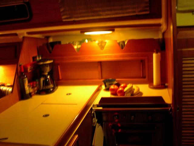

I don't know the interior configuration of your boat, but I offer our examples of interior lighting for ideas for your boat.
To make the boat more "livable" (we spend six months or more on our boat each summer) we installed Alpenglow units in the area under the side cabinets in the main cabin for reading and for general light (see attached pictures taken at night). The lights project a wide light area that provides light around the cabin and, being close to the seat has ample light for reading. Being under the cabinet, there was an easy way to route wire from the lighting circuit without having exposed wire.
We left the original lights alone as we found that we never use them any more.
Alpenglow also has kits so that you can replace old lamps or convert lamps to 12v compact bulbs. You will see two lamps that I converted from 110v to 12v. These are the one in the corner and the one on the table that we use when dinning.
Our boat had a 15 amp circuit breaker for cabin lights and more than adequate wire size for the addition of more lamps but this should be verified for each boat.
We have Sensibulbs in the aft bunks for reading but find the Alpenglow light color far more attractive in the main cabin.
Hope this helps or gives you some ideas.
