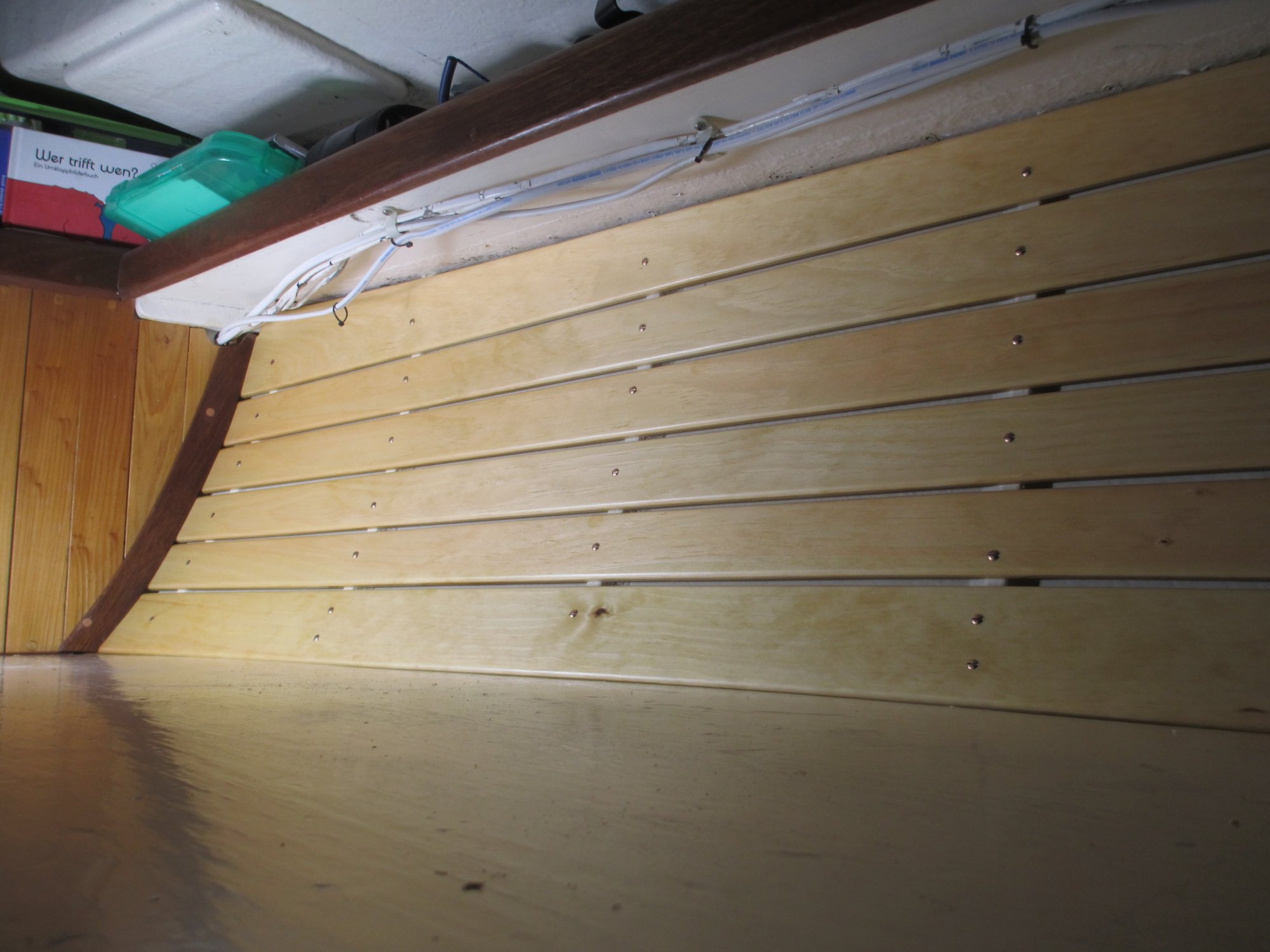

Is this material on the cabin sole? Or is it headliner or cabin sides?

Absolutely, that looks great!
I’d have to do the overhead too. I think it might be a little more than I want to tackle though. I was hoping to find something that could be rolled on, maybe like a rubberized coating. I’m not really sure what to do. I thought about pulling it all off and painting it, but I’m sure the glue used to put it on would look pretty bad. So having to remove it all would again be a big job.
but I agree, the wood slats look great and definitely would work.
thanks for the suggestion
