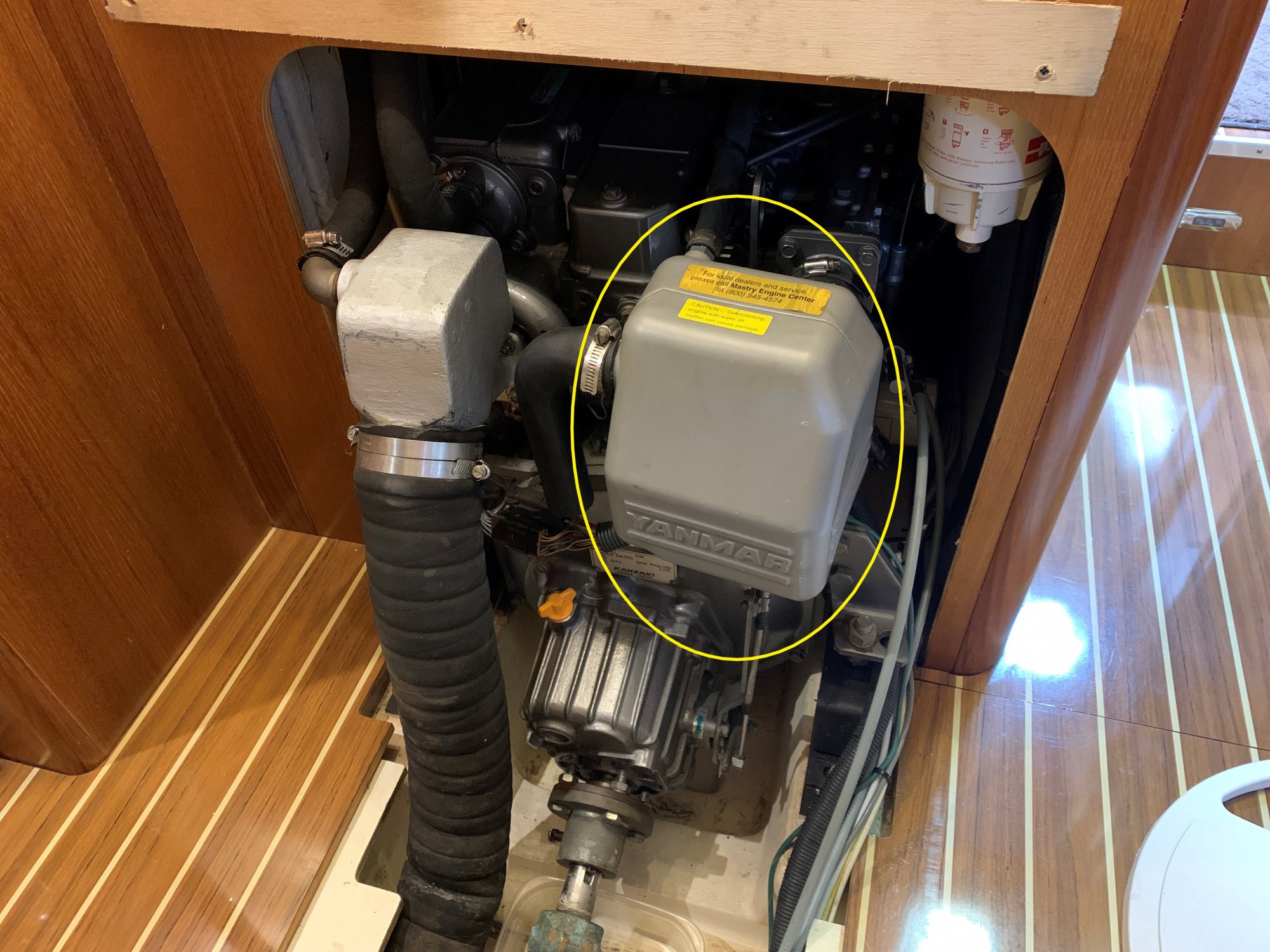

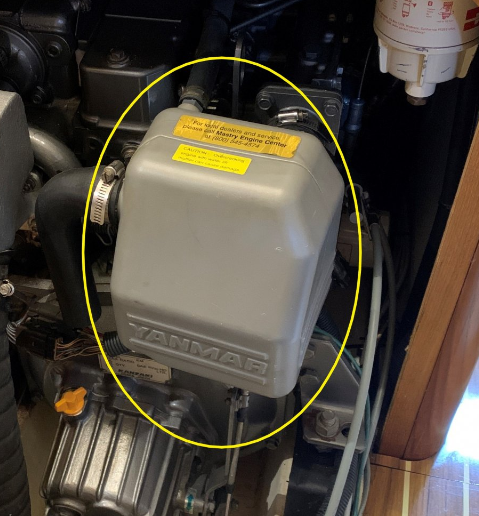

What maintenance is required for the intake silencer? 05H41DS Yanmar 56hp 4JH4E
What's inside there?

Check the archives for a 05H41DS Yanmar 56hp 4JH4E manual. I can only presume that's the air filter which does require some care and attention.
Now if that was mine, I'd have the hoses dis-connected and a borescope in there inside of a heart beat. But that's just me.

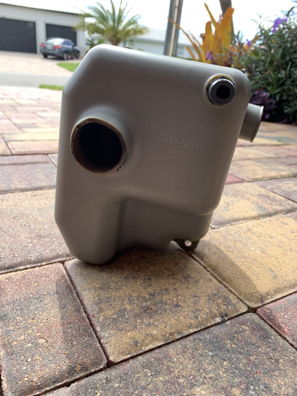

That is a complete mystery. No filter device of any kind is mentioned or shown.
If the air in your boat were ever dirty enough to accumulate sufficient dirt to restrict the air flow through the intake manifold, you would have to be motoring in desert dust storms. If you are, Stop That :angry: !
It sounds like dirty air is being fed to the cylinders and life goes on :facepalm:. At least until you have ring sealing problems.

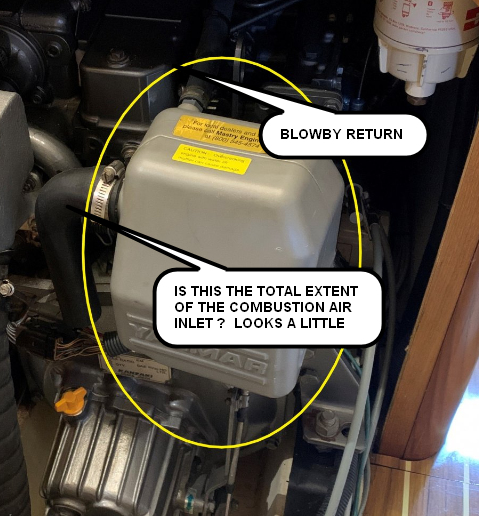

I wonder what the problem would be without the air silencer in place ? Is there some unknown filtration device in there after all ?
I know my comments here are as useful as a rubber crutch, but all I can see is to carefully remove the silencer/air filter and see what's in there. Please take pics if you can. This is actually quite interesting.

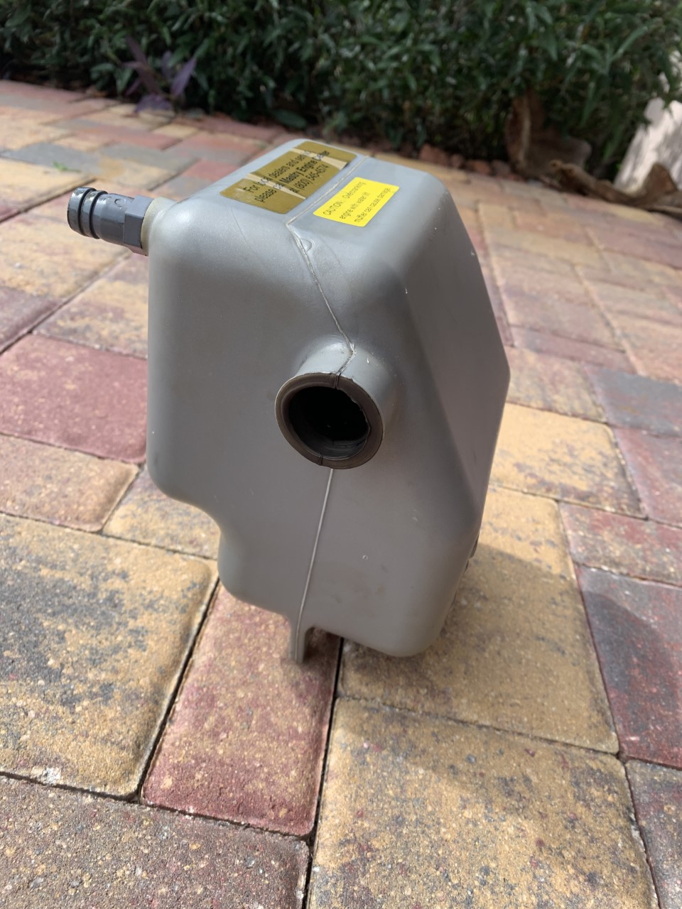

It's just an empty hollow plastic jug. There was a little motor oil blow back in there.

From what you've found with the removal of the box, if it were my engine, I'd be looking for a good quality (K&N) air filter. I know that the air filter on my little Yanmar 2GM20F acts as a MAJOR intake sound reducer when I run the engine without it. You may find the same with yours if you replace the empty bleach jug with a proper air filter. I think there's still a hose on the jug whose function is not clear.​
I choose to use an air filter primarily to eliminate any belt dust which always appears for a while after changing a belt.​

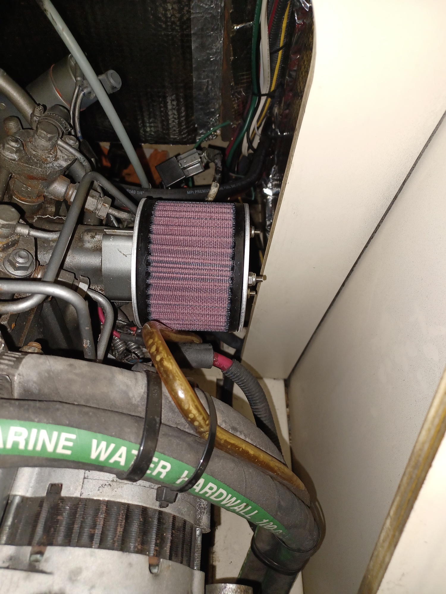

Dec 22, 2012
95
Hunter 27-3 103 Gables By The Sea
