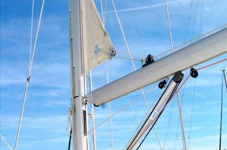

It's easy to see from the picture how side-loading might unfurl the mainsail in strong wind over two days. It would seem that you must either secure the internal roller so that it cannot rotate, and/or wrap the clew area around the mast and lash it to remove the surface area for the wind to push against. How is it done normally? Can you stop-off that line beneath the boom going into the mast to keep the roller from turning? Did that line part?

KG's picture is of the US Spar's setup, which I don't think can unfurl on its own. The furling line wraps around a line feeder directly connected to the foil. There should be no way for the furler to open unless the line parts.
I see the OP has a Hunter. Some Hunters have a different type of arrangement with a continuous line, which presumably could slip allowing the furler to open.

I find it odd that a mainsail would unfurl on its own. My furler line goes to a rope clutch and would have to break to unfurl.
I have a big code zero on a continuous line furler that should be MUCH easier to unfurl in big wind. I wrap the furler line around a cleat to prevent unfurling. Been thru a few 50k storms with no problems at all.

With a roller furling main (which has not much shape of it's own, you might argue that the depreciation isn't the same as a conventional main.
Aside from that: IF you have the main furled like that, with the furling line secured (with the stopper or cleat), it shouldn't unroll in the winds you described. You canvas would have disappeared before the main creeped out.

My sail was put away just as GK pictures shows ,the same as it's been a 100 times before, lines snug clutches down tight.

(Admittedly thread drifting) - So what failed allowing the main to unfurl? Given that configuration I don't see any way it could open itself. Given that we have a similar roller furling setup I'd hate to have ours open too if there's something that can be done to avoid it.

In order for the main to unfurl i) The line had to part; or ii) the clutch had to fail and the line had to pulled through; or, iii) the clew of the sail had to rip right at the exit to mast [where the sail is heavily reinforced]?

I have in mast furling - I can't see how the load on the small triangle area could cause a failure of the furling line or the rope clutch securing it. And IF the load could build to anything substantial I would expect the outhaul line or block to fail first leaving a small triangle flapping.
