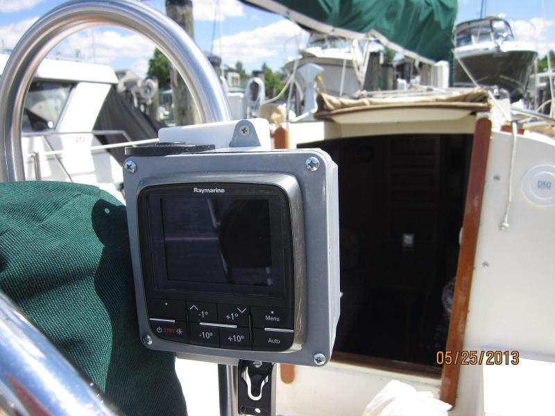

I got ripped off, mine cost $18. :) -pic
Probably because I had to order it online. Sure beats $300. I've had it on for a year now and it still looks new.

Where did you bring your wires in ...back or bottom?
Oct 9, 2008
1,742
Bristol 29.9 Dana Point

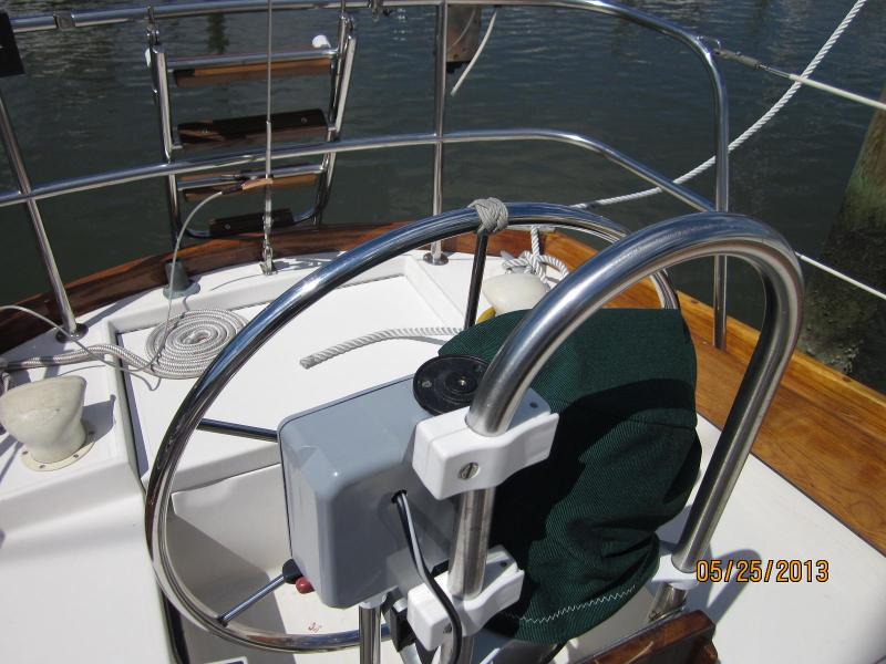

Back near the top, so that it was a straight shot to the instrument's connector. Filled the small void between the wire and the hole with silicone. Left a tiny opening to let air pass, as I also drilled a small hole on the bottom of the pod, to let any water out, should it enter. I removed the pod for winter and inspected the interior, no sign of water intrusion.
Edit: Found a pic of the rear

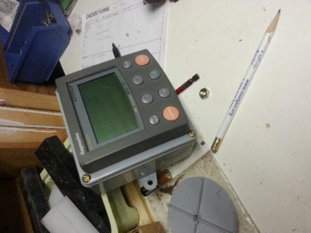

Please source these pods for us.
And, can they be painted?

They come from Home Depot and they are PVC outdoor weatherproof boxes
I actually got weatherproof inlets for the back

Mine is a Cantex. You can pick your size here:
http://www.cantexinc.com/Products/NM_Fittings_Accessories/Junction_Box/Cover.php
Then scan the internet for a retailer. I think mine is 5x5x2. But I can't remember without measuring. If you need the exact dimensions of the one I pictured, let me know and I'll check it when I'm on the boat this weekend.
Re: painting, it's PVC so should be paintable. It comes gray, which exactly matched my AP control head. The quality of the box is pretty good. Thick and strong PVC, rounded corners, gasket-sealed cover, and the finish is smooth and passable. It's not stunning, but it's good. It's quite amazing actually, considering the cost difference between it and the "marine" pods.
