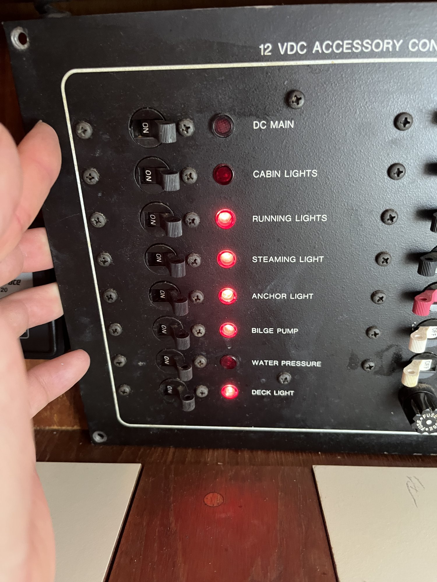

I’ve been racking my brain trying to find out why my DC main light won’t light up.
Power at the dock, charger is testing correct, batteries all have juice.
Did my light just burn out, everything works as it should. Hunter 34.

On my identical panel they are LEDs. Amazingly after 40 years they are all working.
That one is not.
On the AC side they are neons and also mostly still working.
10,257
I have had problems with bad connections on the AC side but since I replaced all of the indicators with LED's everything is OK.

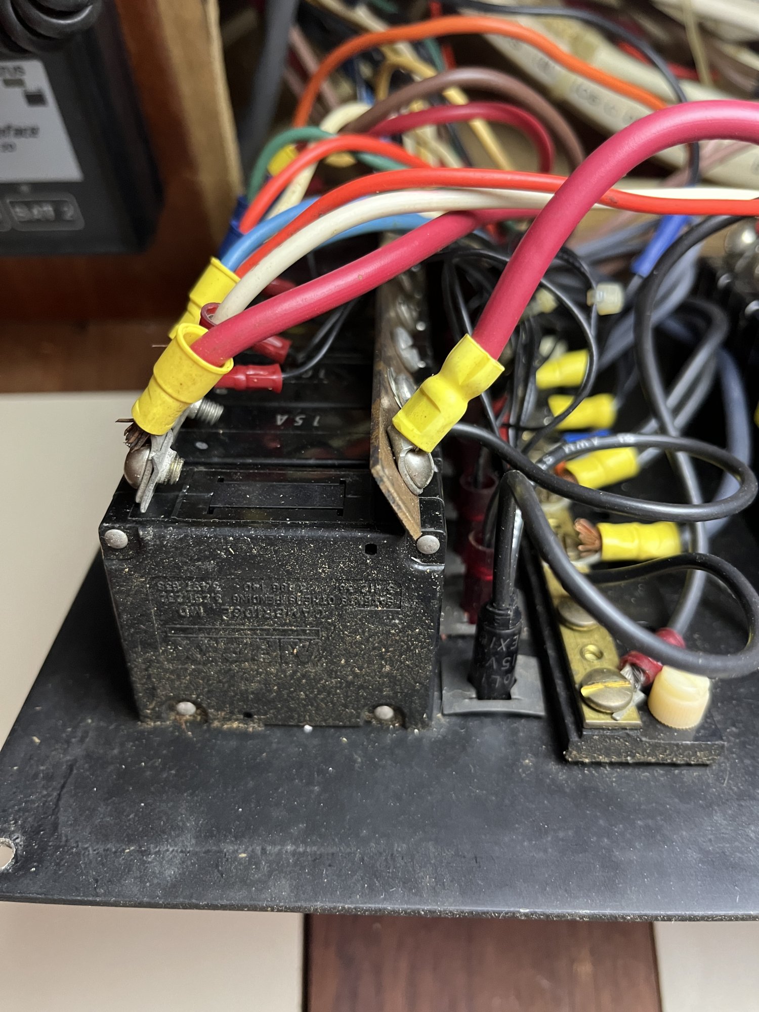

The DC Main light looks like one of the old original incandescent ones; I agree, probably burned out. The "Cabin Lights" one looks different, but it is strange that they are adjacent.. .. Connections would be highly suspect.. but if you can get a voltmeter on the light wires, you can troubleshoot it pretty easily.
