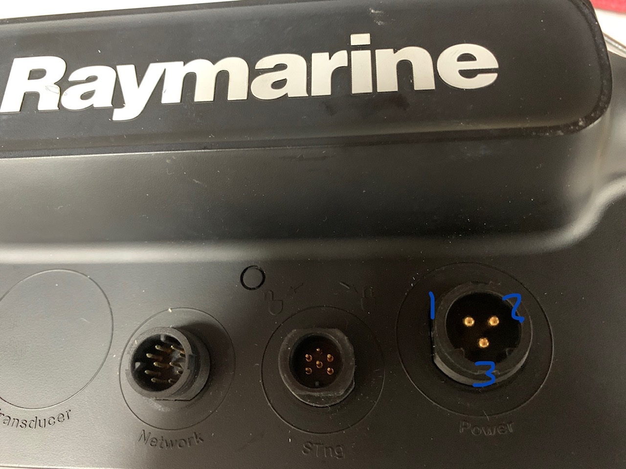

Anyone has the pinout of the top picture?
Pin 1 =
Pin 2 =
Pin 3 =
I would like to do some test but I don't want to reverse polarity.
Cable or unit would be great (my cable is in the boat 1 hour drive under a tarp full of snow...)
Thanks

What test do you want to do, resistance or voltage?
To check the voltage, disconnect the power cable from the unit, turn the power on, and measure the voltage across the pins. On 2 pins you will probably find voltage. Not sure about the 3rd pin. When measuring voltage there is no need to worry about polarity, if you get it backwards the voltage will read as a negative number, if it does, just reverse the leads.
Voltage measurement is passive, i.e., the meter simply reads the voltage across the pins and does not add any of its own power. Measuring resistance is active, the meter will apply a current across the circuit to measure the resistance, it is then possible to reverse the polarity. In some circuits this can be an issue in other circuits it doesn't matter.

Thanks for the explanation dlochner
If I would have acces to the boat and cable, it would be graet.
The problem is: "(my cable is in the boat 1 hour drive under a tarp full of snow...)"

If you want to power up the CP at home, you'll need a 12v power supple and a power cable. With those you could simulate a start by powering up the CP, then turning the power supply off and on quickly. My guess is you will have the same problem with dropped gps connections.
What kind of tests were you planning to do?

From : Raymarine a75 Installation And Operation Instructions Manual (464 pages)
1. Vessel power supply positive (+)
2. Vessel power supply negative (-)
3. In-line fuse (If your products power cable does
not have a built in fuse then an in-line fuse
should be fitted.)
4. Drain wire connected to vessel negative power
supply.
5. Product power cable
6. Vessel battery
I never have touched one of these but if I was going to check it I'd turn off the power then test the three pins against each other for 12 volts DC. find which two pins are shorted together while using the ohmmeter then turn the power back on and find which pin is 12 volts DC with the Volt meter. Watch the 12 volts remaining turned on while starting the engine if it goes off you will have a clue.
