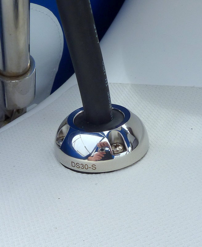

I just use a Scanstrut deck gland like this one. They are some of the best designed deck glands I have found. Just leave a bit of extra cable in the cabin so when, not if, you need to replace the coax PL-259 you just loosen the gland and pull up a few more inches of cable & re-terminate....

Looks like it's great quality.
Unfortunately it would still have the same problem I noted with the original perko outlet I had.
It's leaves a short length of cable flopping around above deck when the mast isn't rigged, and eventually (maybe decades admittedly) that rubber grommet would fail (looks available as a separate part for the scanstrut brand)
My boat already had a barrel connector between the 2 UHF male ends (I assume that other C22 were setup the same way) , so the thought is to simplify the whole thing and eliminate both the short length of cable above deck, and the cable outlet itself, by replacing them with a long bulkhead connector.
Unfortunately the ones with a plate, that we have found, are all to short.
I'm wondering if this method a bad idea ? Maybe that's why the selection is a bit thin, and the cable outlets/gland nuts are so common.

The Scanstrut units are nice, but one for the part number shown in Main Sail's pic, its about $45 average across a few online stores.
Mar 20, 2015
3,298
C&C 30 Mk1 Winnipeg
Hehe Try $76 CAD plus shipping from amazon.ca. And that's the plastic version.
