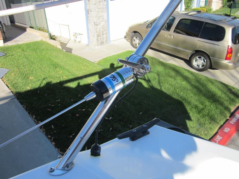

For what it's worth, I've found my base VHF radio in the cabin pretty useless, especially if I'm motoring. I just can't hear it,(too many years working around runways), so I always have a good handheld VHF in the cockpit. Tests I've conducted show that the range with the handheld on the ocean is further than I can see my buddy out on the ocean who was also using a handheld on his boat. My handhelds have both a rechargeable battery pack, and a battery pack that uses AA batteries. I always have a supply of AA batteries on board, so even if my my boat's batteries shoot craps, or the rechargeable battery packs die, I still have AA's. I'm also going with an antenna mounted on the stern pulpit. I don't have to remove it, or disconnect anything when trailering. Just fold it over and drive away. My coax cable will be continuous from base of the antenna to the back of the radio, with no connections through the deck. Again the range is further than you would think. And in the worst case situation arises, I also have a SPOT aboard for that situation.
