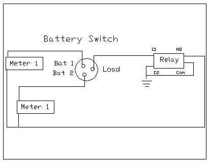

This is one possibility. The meters should have been labeled Meter 1 & Meter 2, rather than both being Meter 1. Sorry for the typo in the quick sketch

Easy to do with one double pole, single throw switch. Switch "ON" and ya see both meters, each reading its batery, switch "OFF" and both meters are out of the circuit. The little "V" in the circle is the voltmeter.. Not automatic, but if mounted by the batt selector you could turn it on when you turn the batt on if you wanted to see the volts that day. You could sub a Double pole, Single Throw relay for the switch and hook the relay coil to the "load" terminal. That way both meters would come on as soon as the big batt switch is turned "on".

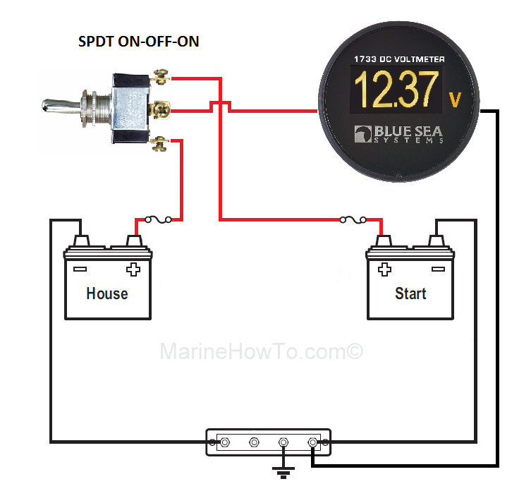

#1 For any reasonable accuracy of a volt meter, the meter should directly sense / be physically attached to the battery banks + & - terminals not at the battery switch. Otherwise you're not reading battery voltage, just random bus voltage, with all the voltage drop associated with the wiring & terminations and this is most often not an accurate representation of the actual battery terminal voltage.
#2 If you want both volt meter to come on when you fire up a 1/2/B switch then you will want a DPST 12V relay that is driven by the "C" post of the battery switch. The relay will increase the "on" consumption of the digital volt meters and you'll find average coil currents in excess of .075A.
#3 Beware of cheap Chinese voltmeters as the accuracy is all over the map. Remember every 10% of battery capacity is represented by roughly 0.1V change in voltage. For the best accuracy and "trend monitoring" you'll want a voltmeter that reads to the hundredths position (12.65) not just the tenths (12.6). Also, using volt meters to track battery bank SOC is difficult unless using it as a "stop discharge" guidance point. In other words, do not discharge your 12V bank below 12.2V at your average house loads.
#4 One of my favorite inexpensive volt meters is the Blue Sea 1733 DC Voltmeter. It draws just 15mA or 0.015A. If you want two of them this would be 0.03A. If you want two of them, plus a relay to drive them, then you're looking at 0.105A +.
#5 If you use one voltmeter, as in the diagram below, and you forgot and left it on, consumption looks like this:
0.015A X 24 Hours = 0.36 Ah per day or 2.52 Ah per week
#6 You are better off with one digital volt meter and a SPDT switch (momentary or fixed your choice). There's no dire need to know the voltage of a bank you're not actively using.
#7 Don't forget that each battery lead to the volt meter needs a fuse within 7" of each banks positive post.
The below diagram keeps it simple.

Reg, that file is a "PDF" so it should open with ADOBE Reader .. I agree with Maine Sail that if you want absolute accuracy, the meters should be hooked directly to the battery + instead of the 1-2-Both-OFF master switch, but I figured you could have a nice installation with one meter on either side of the master switch on the H-31.. You'd not get absolute accuracy but the volts drop in either leg should be about the same since the legs are symmetrical.. I would not use a relay in order to avoid the extra draw, I'd put the switch under or above the master so you could turn the meters on if you want to or leave them off..
On ours, I used momentary contact switches so I just press #1 or #2 when I'm looking at the meter. I have no parasitic current when I don't need to look at the meter. I installed a small fuse in case someone pushed both switches at once, but it's never been a problem. A small resistor (1 K or so) would also work to isolate the 2 button problem. I also verified meter accuracy against my calibrated Fluke.
