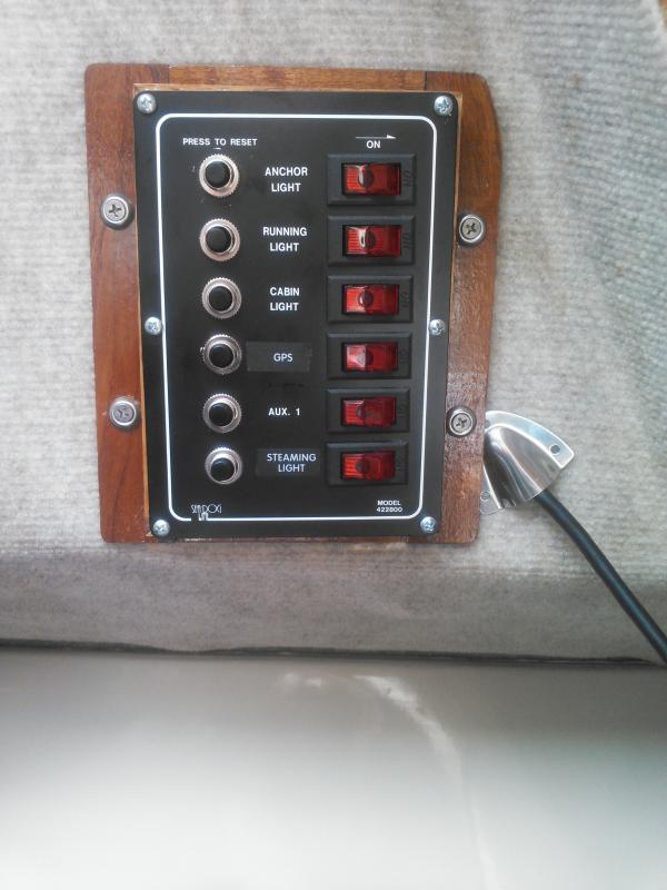

Thought about this a while, decided I didn`t want the weight and pulling and swinging on 3 scews and went to plan B. "B" is a bracket to slip down over the top of bottom hatchboard (extra one, only 6" tall) that holds the compass built into it.. the wire will come off of the side where it is installed, lay in the shelf area behind the stove, be long enough to reach. When not in use ,screen is stored away inside, wire is secured onto the bulkhead next to the switches ,up hi, away from stove, and can be moved away from stove even more if necessary when cooking.
In the photo you can see I drilled through the side bulkhead to route the wire into the back of the switchplate. I plugged into a 3 amp breaker (same as line fuse that came with the unit) and on the wire behind the bulkhead I put a plastic zip tie on tight so any pull on the wire is halted there, won`t pull against the plugs.
