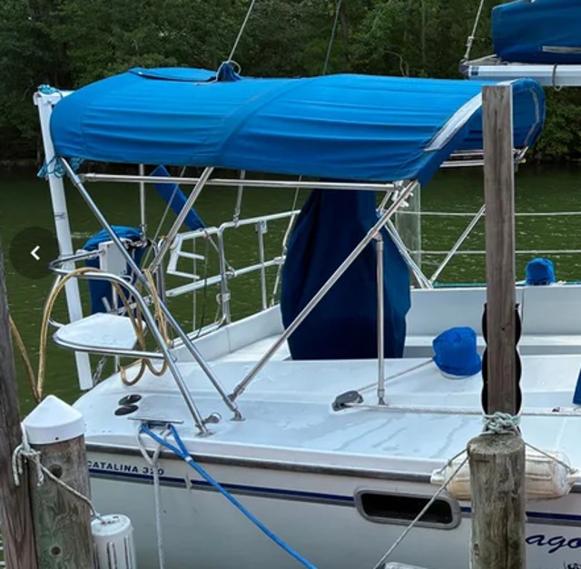

Not my picture, but that is the correct way to install bimini frame. Notice the upper "Y" frame? The backstay cables go in between the upper "Y' frame. I have tried to unscrew the frame screws that hold the frame together, but it's impossible because the screws are rusted. Same with tiny Allen screws. With the Allen wrench (L-shaped), I tried to unscrew, but the Allen wrench twisted. I think the frame is like 28 years old, but the stainless steel tubes (frames) are still in very good condition.

I can’t envision having to remove the backstay(s) to install the Bimini frame. If the
bimini canvas cover installation requires removal of the stay, I would have your local canvas person modify the canvas to include one or two zippers to facilitate the installation of the canvas. It’s too much of a hassle to remove stays just to install the Bimini canvas.
I have a bimini canvas with two holes (with zippers) for backstay cables. The canvas itself isn't the problem. The problem is the frame. How do you put backstay cables in between the upper "Y" frames (see the photograph)? I will try some penetrating oil spray (I have a can of Kroil penetrating oil spray somewhere in my garage) to loosen rusted screws in the frame, so I can separate the frame (disassemble). That way, the installation of the bimini frame will be much, much easier (the backstay cables will be in between the bimini frames).
