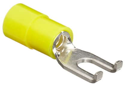

Flange Spade Terminal for the receptacles and panel.

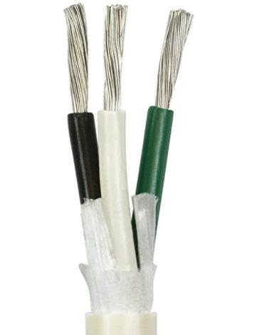

10/3 AWG Triplex AC Marine Wire for main feed from shore power to breaker.
I used 12/3 AWG stranded AC wire (bought from Ace hardware) for feed from the breaker to the receptacles.

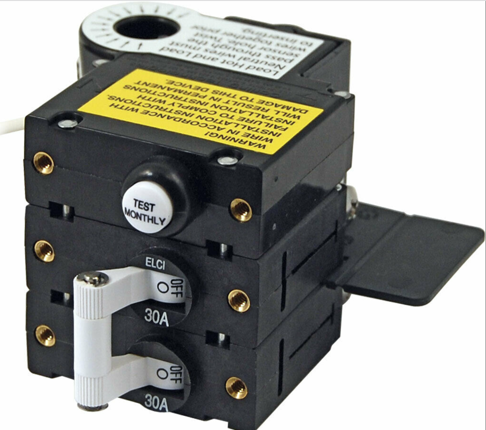

Thanks for the help. I just purchased an ECLI breaker to install in my panel. It takes up an extra breaker location and I happen to have one that is free. I am also going to rewire the ground to the engine. I have an outboard, but I never raise the motor out of the water. All my engine controls are in the cockpit including start and stop so I never bother raising it out of the water. Thanks again, see below for the picture of the breaker.
24,620
Looks like a nice one.
Size matters
Hope it fits.
