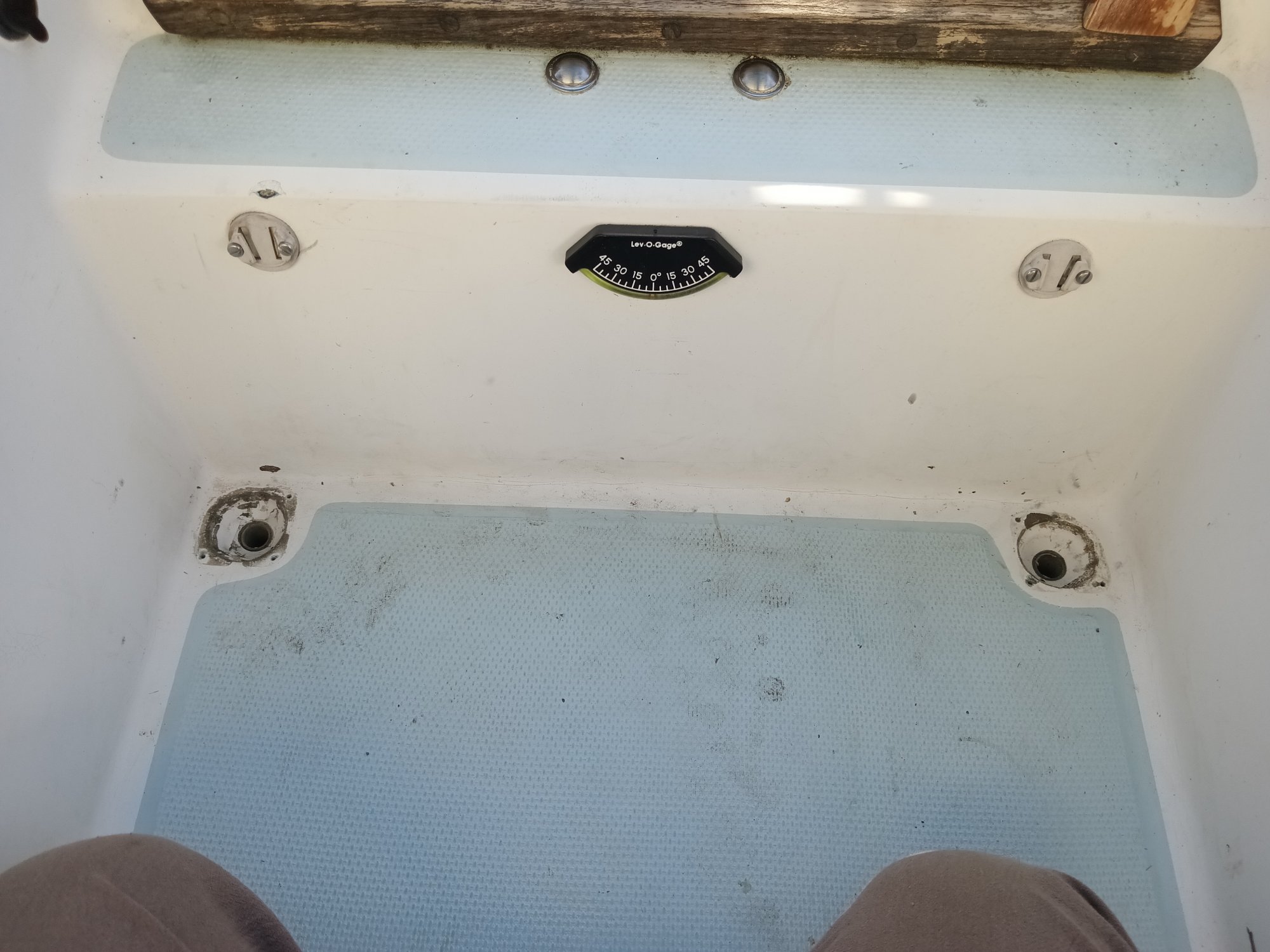

Hi all,
Downsizing from a Catalina 30, I've just bought a 1984 Catalina 22. Over time, I'm sure I'll have lots of questions, but for now: Before I put her back in the water, I'm installing the aft-scuppers available from Catalina Direct. They have a screw-in cap. Should I install with the cap on the outside (so I can only take off when I'm on the trailer), or on the inside (so if I'm going fast and want to let water out, I can take off from inside the cockpit)? Catalina Direct suggested putting on the outside, but I'm curious for experience of others. Thanks.

Thanks, good to know! Still makes sense to install for draining when pulling out of water. And, yes, I'm upgrading the forward scupper screens (PO just had easily-dislodged wire mesh there).
Sep 30, 2013
3,714
You will almost certainly never need to plug them. But since they have plugs, I suppose I'd at least retain the capability to quickly plug them when it matters, if it ever matters, by placing the plug end inboard. The only reason I have ever heard for plugging scuppers is to flood the cockpit and take a bath. :biggrin:

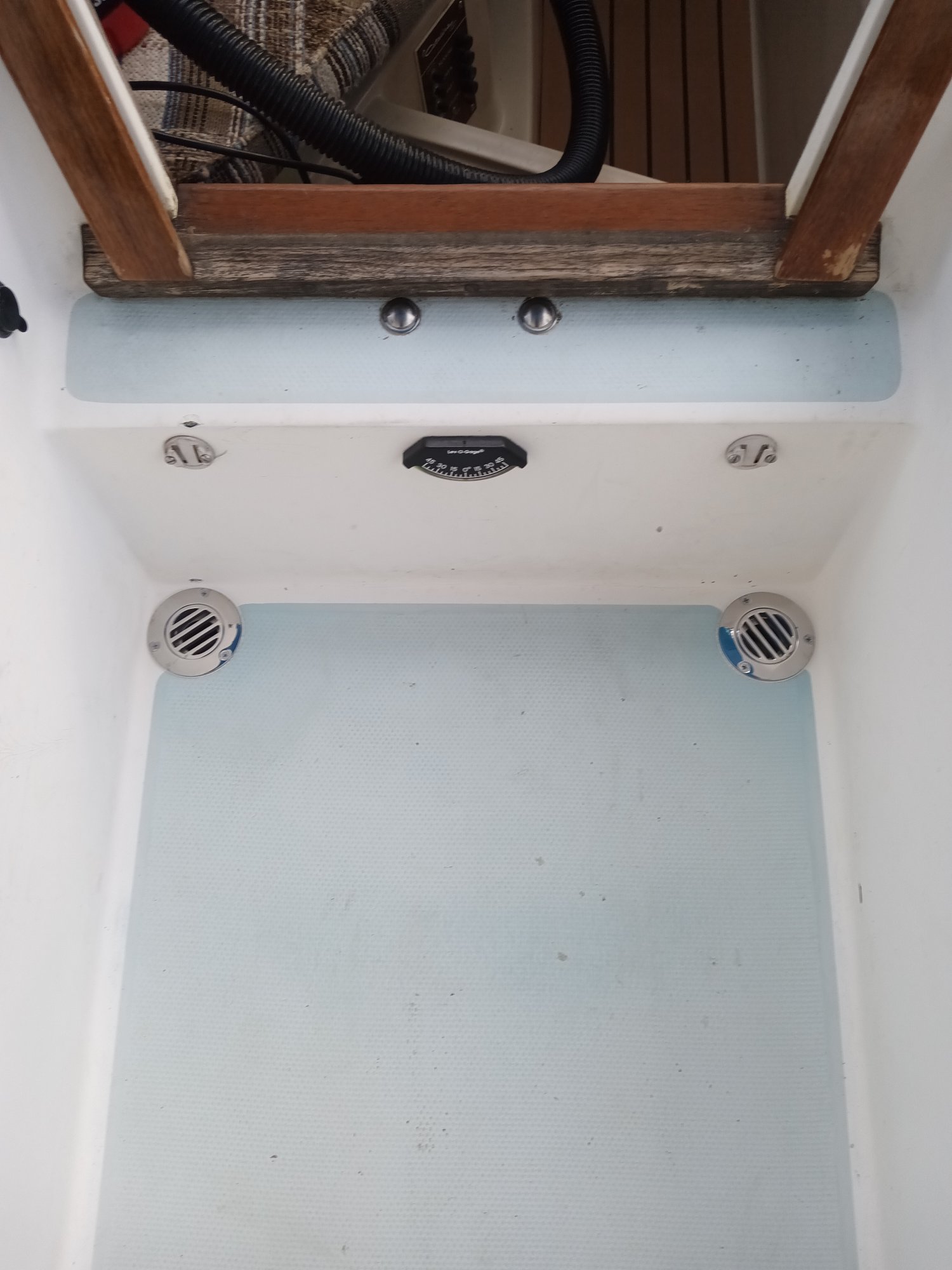

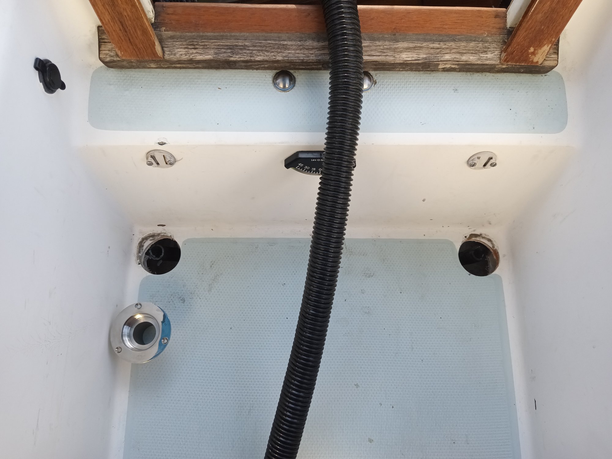

Just to close the loop: I installed them with the caps on the inside. My reasoning: If I ever got huge amounts of water in the cockpit (for example, hit by a wave; or, as @Gene Neill suggested, taking a bath), had the hatch boards in so the cabin didn't flood in that moment, and wanted to drain as fast as possible, having the caps accessible on the inside made more sense.
Also, installation note: The O.D. of the outer piece is 1.5" and the inner piece is 1.25". So initially I drilled different size holes from inside and outside transom. But I found I needed to drill 1.5" all the way through, as the length of the outer piece reached almost all the way through the transom.

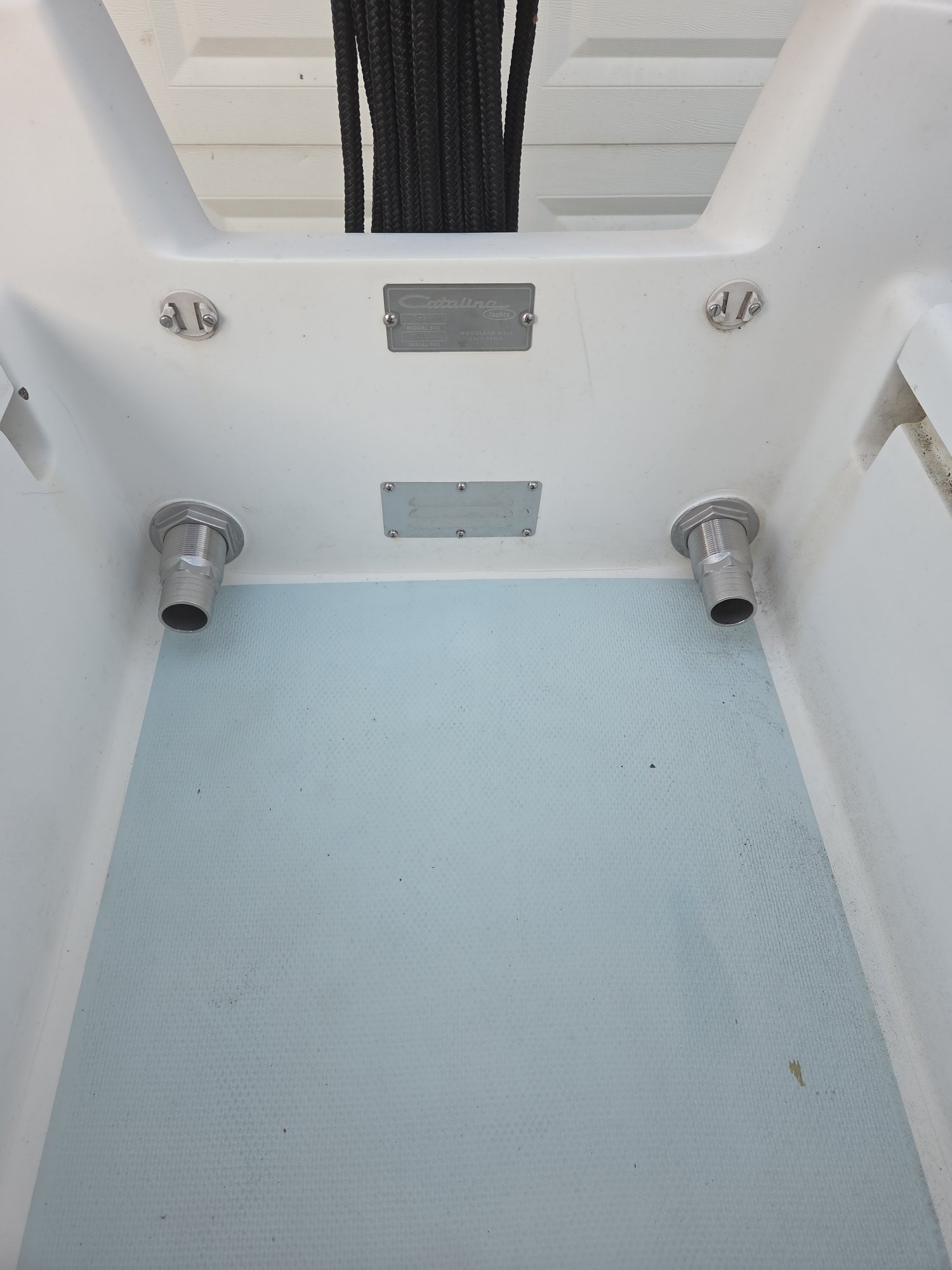

The original forward cockpit drains are only 3/4"...and converge to drain through the bottom of the boat....through a 3/4" through hull. I see all of this as potential liabilities.
So, I installed 1-1/2" drains..6de5f978-189c-4a88-b265-a1625d562d4f.jpg ea08fac6-6fec-447f-bf56-d67ff27af628.jpg
And ran them aft to drain through the transom...above the waterline..

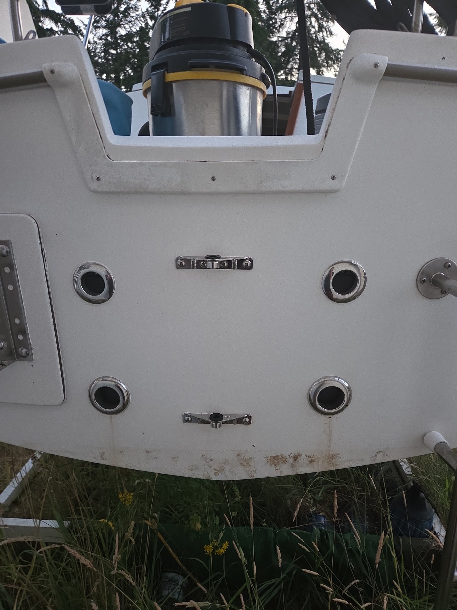

As you can see I also installed a pair of scuppers in the aft cockpit through the transom. I still need to trim off the excess on the inside...
