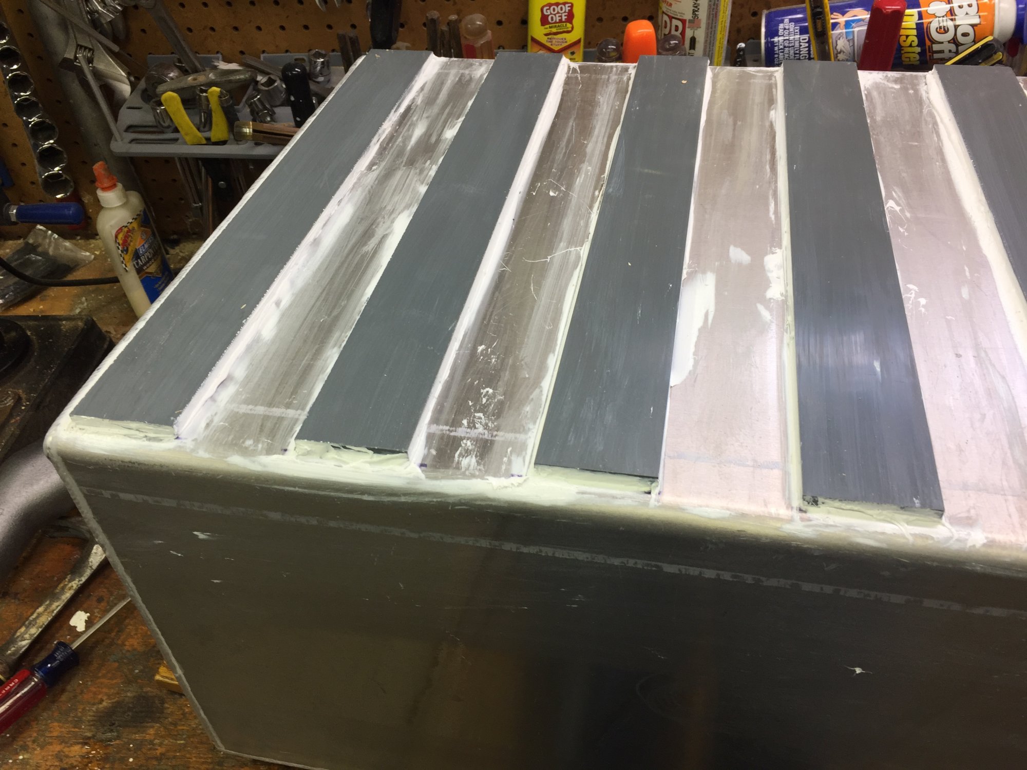

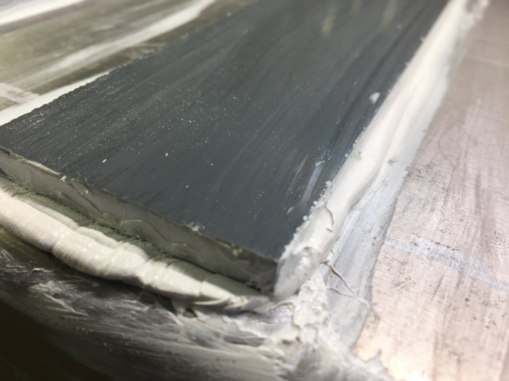

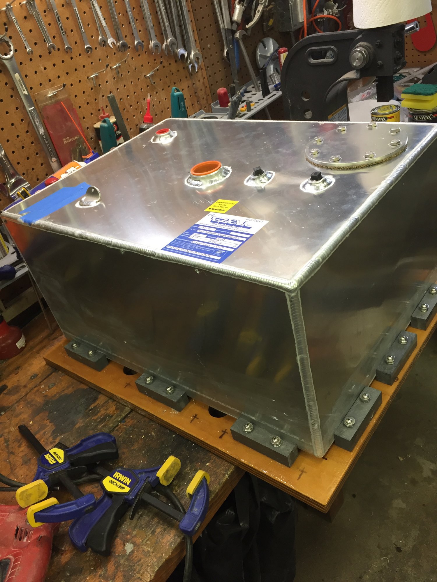

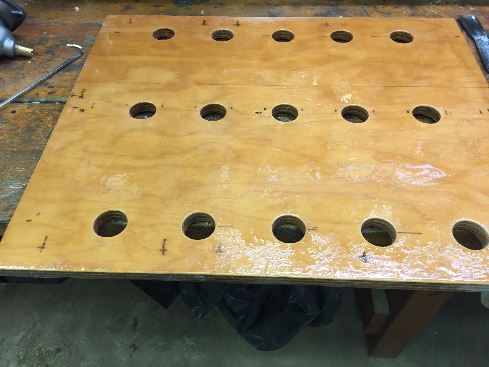

I had to research this a couple of years ago when my tank leaked and had to be replaced. I built a new base support out of 3/4" marine plywood which I covered with epoxy. Before covering I drilled large drain holes through the plywood. On the underside of the new aluminum tank I bonded pvc strips to keep the tank from ever being in contact with water. On the base I fastened PVC cleats to prevent lateral movement of the tank. I used an adjustable hold down strap to keep the tank from any vertical movement. Photos below:

Nice! How did you secure the plywood to the boat?
RoyS
Jun 3, 2012
1,742
The plywood was secured to the boat by fastening down to two existing stringers with screws. The hold down strap (not shown) also went around an existing fiberglass transverse panel just behind the tank.
