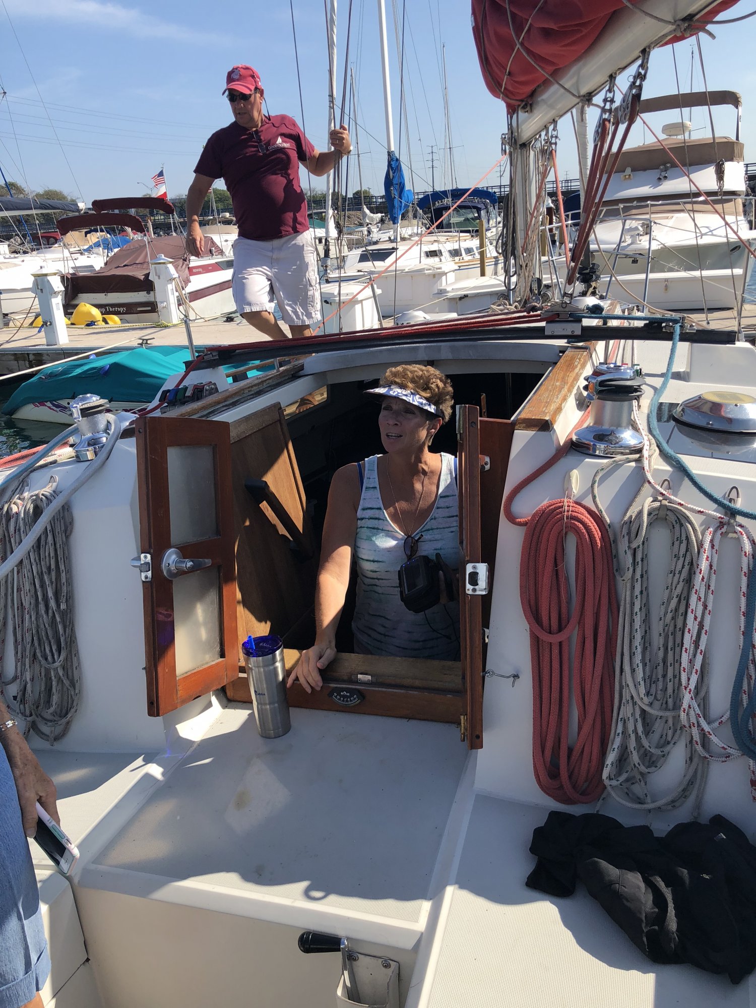

I don’t have a C-30, but on my O’Day 322, I have rope clutches on both sides of the companionway, including main halyard, spin halyard, etc.
I use some 3M gizmos to hold the lines when not in use. Once I raise the halyard, I will tidy things up and coil the halyard back in the rope holder. Photo will give you an idea how things look when stowed...

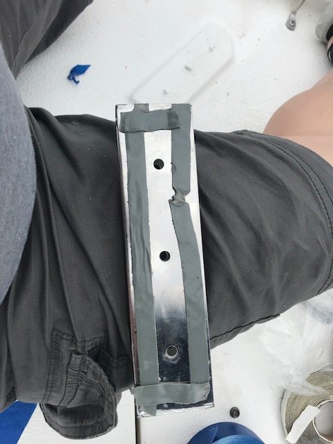

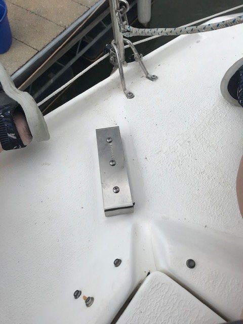

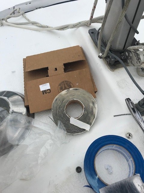

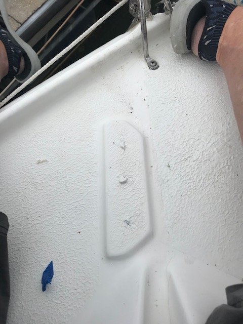

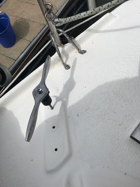

To answer your question about what to expect. If the Catalina's are similarly built to the Hunters, there will be an encapsulated aluminum plate in that raised section. You will need to drill and tap. I installed a three clutch and a triple deck organizer to port on mine. For some reason I did not take pics of the clutch install but here are pics of the organizer instal. The process is identical.

12,650
...I believe this is exactly what I will need to do. I've never used a tap before but I understand that the hole needs to be drilled with a bit having a slightly lower diameter. I already done the research on this and know what I need to do.
Yep! Go one size down on the drill bit from the size of bolt you are going to use but set the tap at the same size as the bolt. I got my tap set at Lowes. If you have watched a youtube or two, then you have probably seen the advice to make a 1/2 turn then back up 1/4 to break the burr off of the bit. That is probably needed for steel but for aluminum I have found I can just turn the tap and make the threads. I have installed a traveller, a deck organizer and a three rope clutch on my H26 and all of the tapping was super easy and straight forward. Don't over think it. I put a dab of 3M 4200 in the hole and then bedded the hardware with butyl tape and bolted it down. It is not hard or complicated and in the off-chance you do manage to bung out the hole, you can always through bolt as a plan-B... so don't stress about it.
