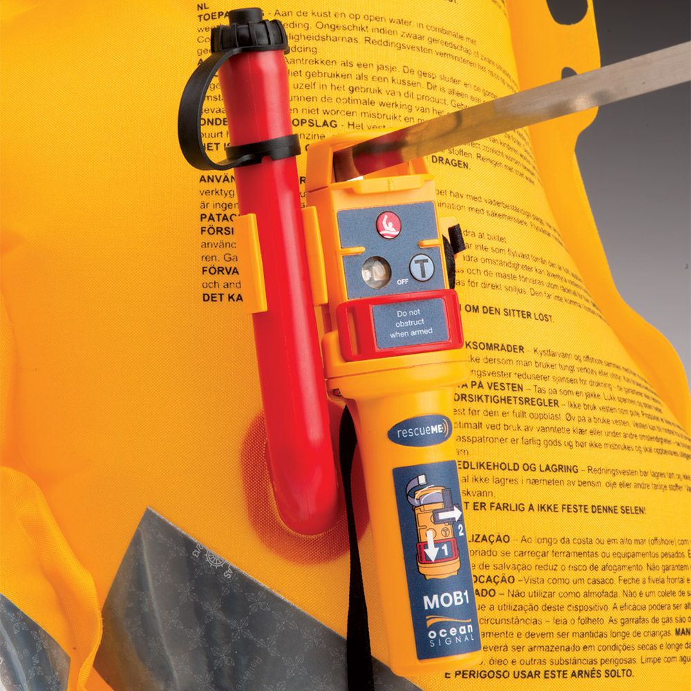

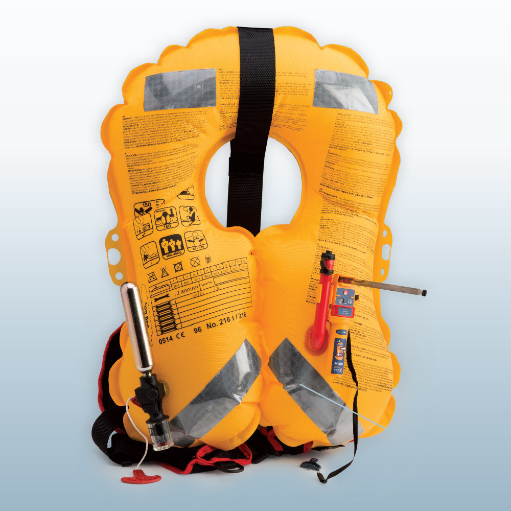

I have some concerns on this. Has anyone here installed the MOB1 on a vest?
The way I understand it, there's a ribbon that is pulled to activate the MOB1. One is to wrap this around the bladder so that when the vest inflates the ribbon is pulled.
On my vest the outside fabric of the vest is integral to the bladder, so the ribbon will be exposed when the vest is folded/deflated. I'm concerned that the ribbon could catch on something and the MOB1 could be activated accidentally.
Has anyone encountered this and solved it?

What brand of vest?
The two brands I'm familiar with (Mustang and TeamO) the bladder is separated from the vest. If the bladder and the jacket are fully connected, then I would look for an attachment point that will put pressure on the string when the bladder inflates, perhaps somewhere down by the zipper or the belt. That or look for different vest.

Thanks Dave. It's an Sospenders vest. It has an integrated harness. I have two of them. I'd rather solve this than spend on a new vest!
I just ordered re-arming kits, too, as one went off in the hanging locker on its own. The bobbin is supposed to be renewed annually for non-commercial applications.
One is set up for manual inflation, I'm searching for an auto cap, with no success so far. But I only need one vest for now.

What brand of vest?
Looking at this I think I can stitch the ribbon to the velcro at the edge of the vest so that when it inflates there will be sufficient pull to activate it.
