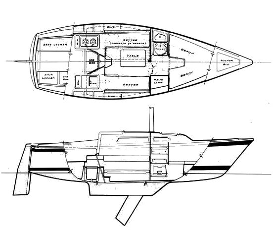

I have been toying with the idea of putting an electric motor inboard on my O'Day 23. I ran across a very good deal on a DCBL Mars motor and bought it. So now I need to start figuring out how to do it in earnest. As far as the motor and reduction gear, I have no issues fabricating mounts etc, as that is what I do for a living. I am a bit fuzzy where the prop shaft exits the hull, and also installing a cutlass bearing and support. I have looked at a site that had shaft logs made of bronze for sale as well as stuffing boxes. Do I just buy the shaft log , cut the hole and glass it in place?
On the cutlass support, I see they have those in bronze as well that have a flange on the hull side. Does that just get mounted on the hull and glassed around as well?
I have had a bit of difficulty locating this info, as most of the boats they are doing the write ups on have already had a ICE in place, so all that is already there.
I do not have the motor controller or throttle pot yet, nor batteries. Any thoughts on those.

Joe, an inboard Diesel will pretty much double or even triple the value of this boat. Cost that will never be recovered at resale time. Plus the difficulty of even getting hte engine in there. The only real acces to the area where an inboard would go is through the sail locker and I can tell you that it is tight even on the 25. I think that to even have room fore and aft to fit the engine, and shaft would require mounting the engine inside the icebox under the companionway. A few of the 23s of this vintage did come from the factory with inboards ,but those used the OMC Zephyr saildrive and had a hatch added in the cockpit sole for access. A saildrive (diesel, gas or Electric) would be the easiest way to add inboard power, but access to the area is still a problem.
My advice would be that the electric motor is still a small part of the expense of the entire installation, plus all the "Engineering" and design work to figure out the shaft angle and length, strut dimensions, shaft log and seal, batteries (figure i nthe weight too!), etc. If it were my boat, I would look into a good new outboard with electric start and remote controls in hte cockpit. Delusions of Grandeur? maybe...... but I'm willing to bet that the cost of a new outboard with electric start and remote controls will ultimately be LESS than the cost of completing the rigging and installation of that electric motor. The outboard and cotrols will also weigh a lot less than the motor, control setup and batteries.

I looked at the bottom of the hull today, as well as the space below the cockpit and think this will fit nicely. I did find some fiberglass shaft logs and I think this is the way to go, as well as a site the details how they installed it. The hardest part of this, for me, is going to be the fiberglass work (adding stringers for motor mounts and adding shaft log and cutlas strut.)
