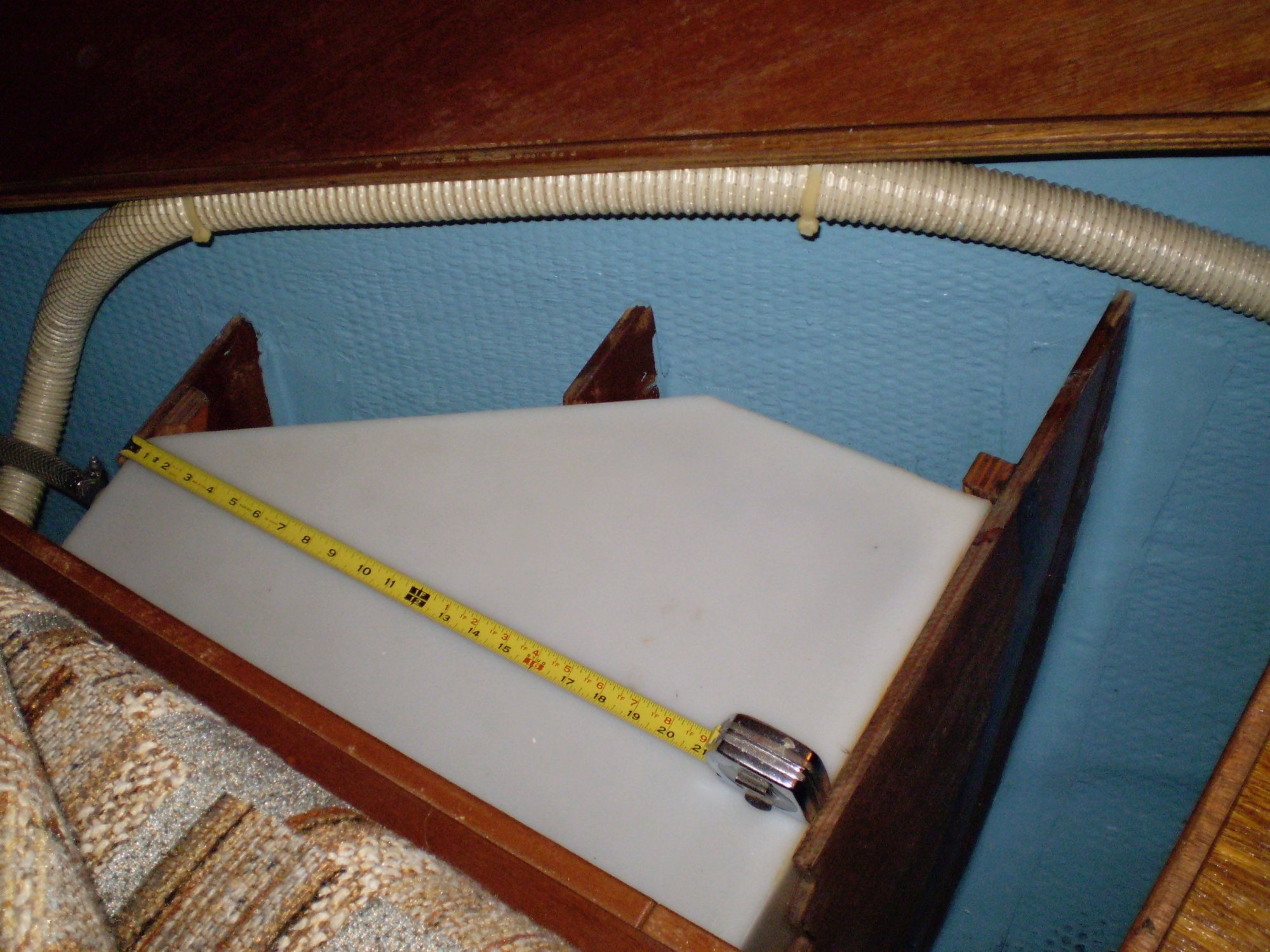

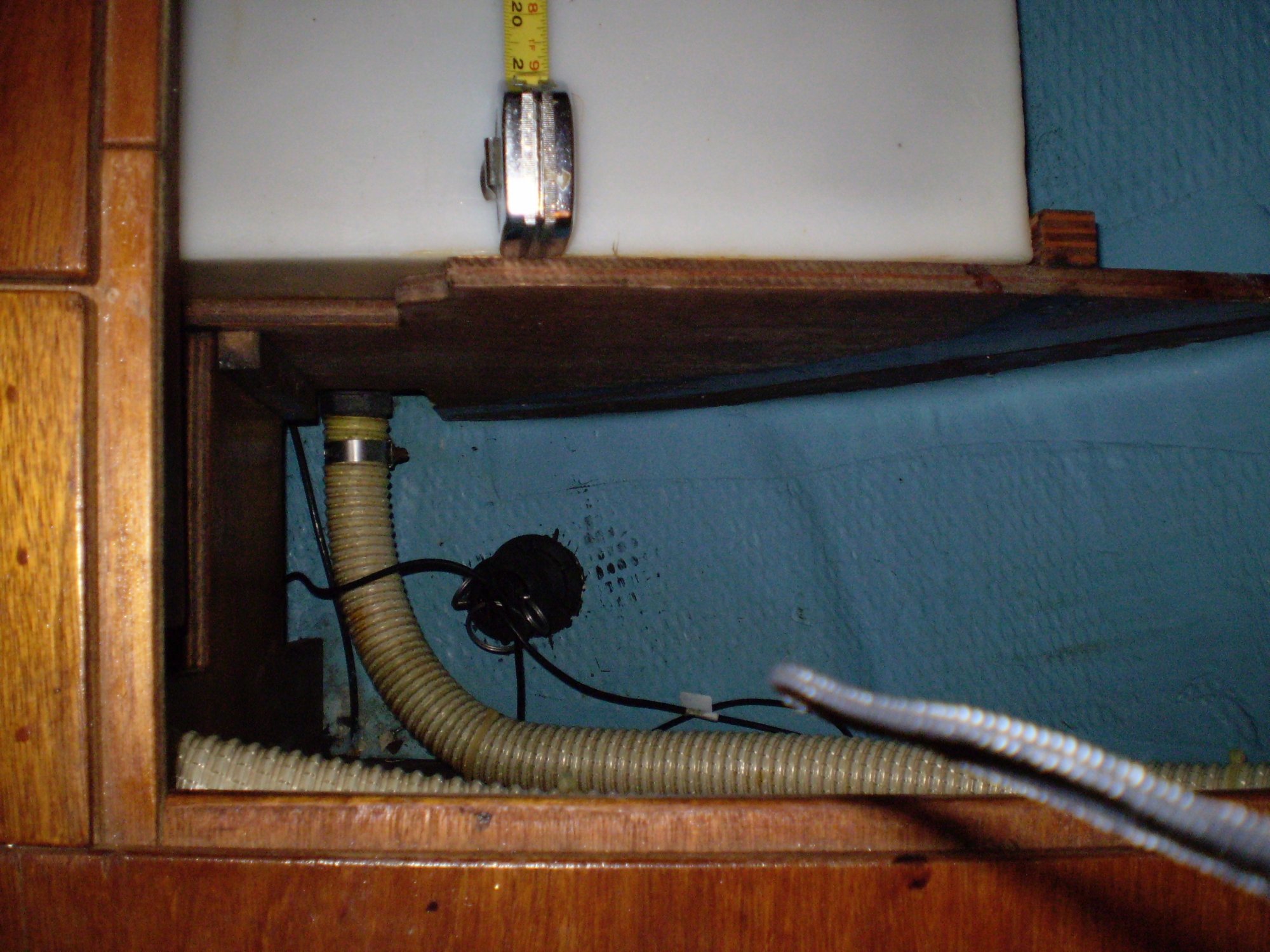

The attached photos shows how Sabre installed the holding tank in the my Sabre 30. It may be overkill, but that's how Sabre is about building boats. :)
The bulkheads Sabre installed help to stiffen the bow as well as restrain the holding tank. The hoses are state of the art 1981 hoses. :holding nose emoji:
The photo only shows half of the install. There is a longitudinal frame that sits on the bulkheads. this frame provides support for the V-Berth. I'm not sure what's under the tank as I did not remove the tank when I re-plumbed it. The upgrade is documented here:

DLochner: Thanks. Perhaps building up a box around the edges would be most secure, no straps needed then. But that becomes very challenging, as there is NO TOP ACCESS. On the O'Day 28, the v-berth is part of the floor pan. I had to cut a huuuge hole in the forward bulkhead to create access. Talk about a pucker moment... It looks like Sabre tabbed a slot into the hull, and the divider boards then drop in, or is the plywood directly tabbed to the hull?
13,981
The plywood bulkhead is tabbed to the hull. Sabres are mostly stick built, so bulkheads, knees, and floors are tabbed to the hull. O'Days are built with a fiberglass pan that sits in side the hull. For your install you might be able to use both methods, tab some supports and restraints to the hull or the pan.
