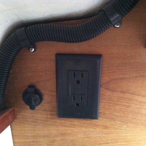

I decided to install gfi on my new (to me) 1984 37c. How hard can it be? Then I found that I need captive connectors. I can't find any gfi outlets that are compatible. They all have a small post and screws that do not screw out (by design). Grinding the posts are easy enough, but the freaking screws are making me nuts. Any know of any gfi outlets that may be compatible?

in the past for non marine use I've just kept unscrewing the side and ground screws - they get a bit stiff at the end but come out -- they go back in ok also. If that "bothers" you - an article on west marine web site states
Flanged spade terminal
For permanent termination when terminal screw is captive. ABYC recommends: “Terminal connectors shall be of the ring or captive spade types.” E-11.16.3.4 https://www.westmarine.com/WestAdvisor/Marine-Wire-Terminal-Tech-Specs​

bare wires on a switch in residential wiring is just fine - on a boat it doesn't meet ABYC standards. The side and ground screws are captive on most GFI's so spade terminals with the turned up ends of appropriate size meets ABYC standards according to that article.

On the boat, snip the ring terminal and bend it enough to fit over the screw. Tighten the screw, and make sure the ring has flattened under it.

I want to go with ring terminals and may try to clean the threads after I forceably remove the screw. If that doesn't work, I will try Ron20234's idea.

A captured fork terminal meets the marine standards just fine. You can also back out the screw & use rings. I do carry 8-32 & 10-32 dies in my bag to chase the screw threads before re-installing. Takes but a few seconds to use rings. I generally use hospital grade outlets & GFCI's with nickel plated wipes, not home center grade, unless the owner already bought them....
