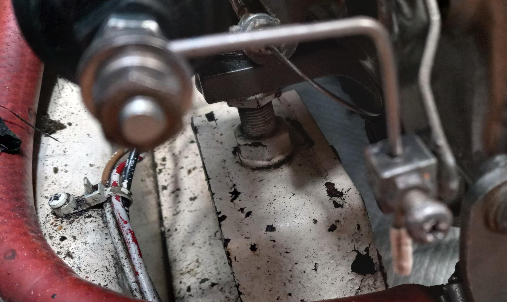

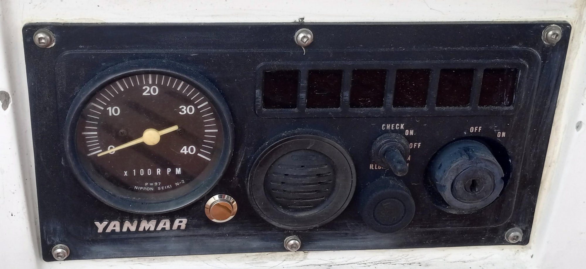

I did that conversion on my 3GM30F and it works fine. I attached a Trombetta P-610-B5V12 directly on the engine, using one of the bolts directly behing the cable attachment and connected a Stainless Steel rod to it, bent it and brought it to the actuator lever. That created a friction problem because of the rigidity of the rod going through the actuator swivel bronze attachment. So I tried different configurations but always had the friction issue. So, because of that friction problem which made it hard for the solenoid to pull the actuator and kill the engine, I finally wound up removing the rod from the bronze attachment and putting an eyelet in the end close to the bronze attachment. I then ran a short piece of SS wire from the eyelet to the actuator attachment. I had installed a nice button in the Yanmar panel as my new kill-switch but it did not have enough amp power so it shorted out ! Replaced it with a rubber covered truck starter button and now the system work perfectly. The pics were taken before I installed the SS wire and truck starter button. Running the wires is actually the worst part of the job. Good luck

Thanks! This is exactly the kind of explanation I need for set up. I assume your rubber truck starter button is the same as the start button that I have on my panel. I already have a spare that functions so that's good. Perhaps I can exchange the rubber cover for a different color. I might try a little more elegant solution for the bent rod. It looks like that might have a torqued force that could eventually fail, but perhaps I'm wrong about that.
