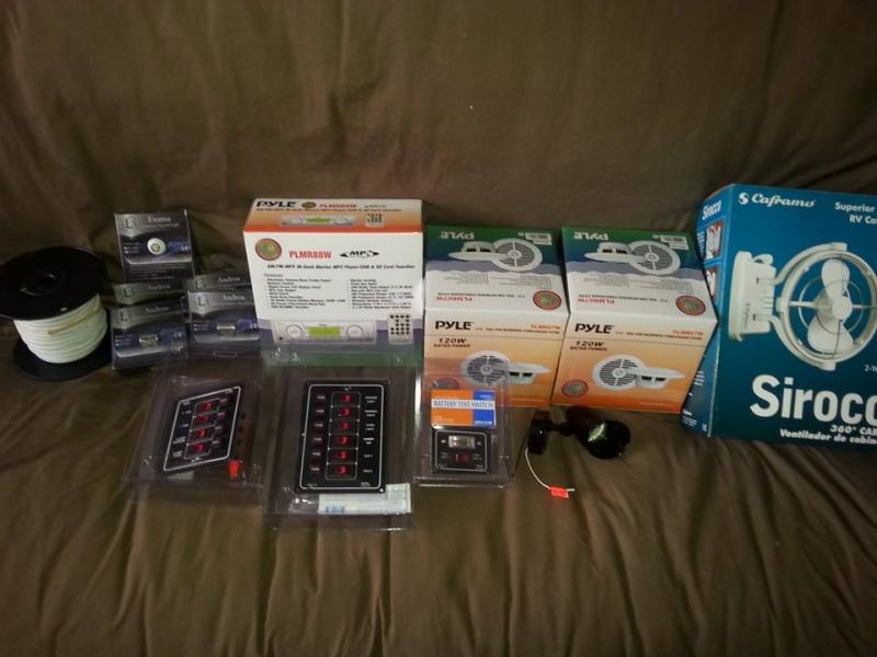

im getting together parts to install a new electrical system on my Mac26D... to replace the non-existent one... ill use 2 6v trojan t-105 batteries. now, for better weight distribution, i would like to install one under each settee. since they are run in series, is it a concern that the main positive lug will be closer to one battery than the main negative lug is to the other? for organization's sake, the battery switch and the main + and - lugs will all be in one area.
also, how do i connect my battery charger? since i essentially have one big 12v battery with 4 posts, the charger would connect to the - on one batt and + on the other, right?
