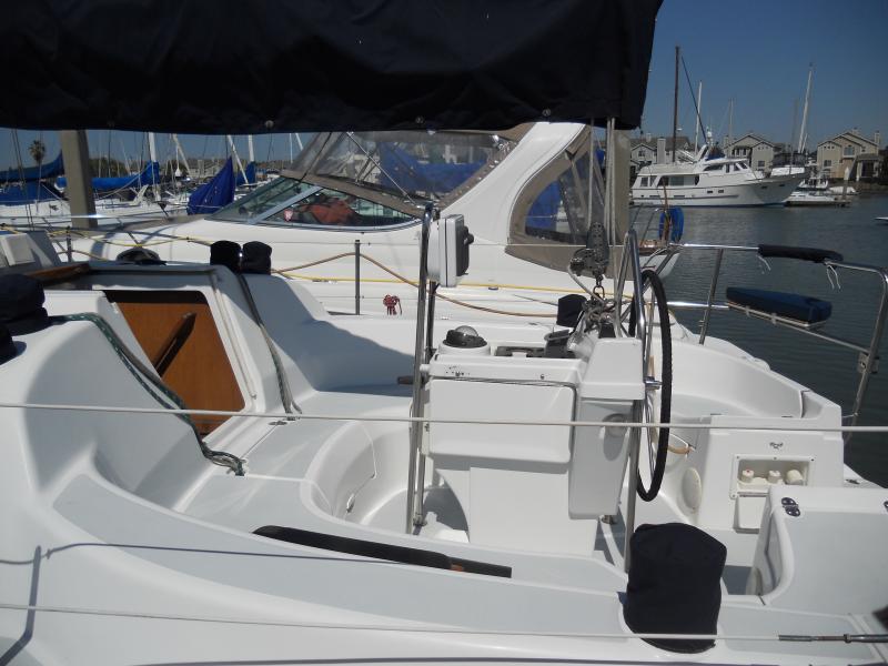

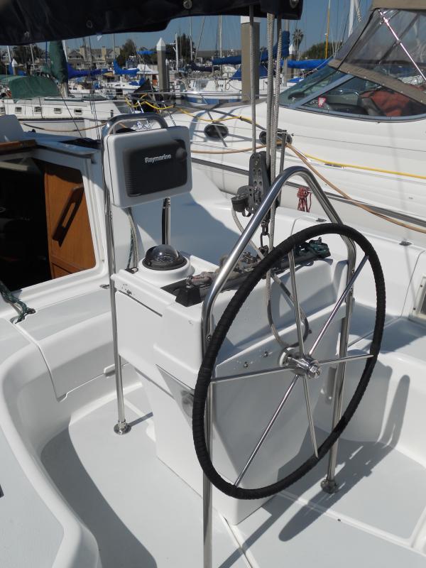

I have 1994 hunter 29.5 ,and I have some questions on installing the raymarine wheel drive ev-100 sensor core , the manual says it can be installed any ware on the boat and does not have to be center line on the boat,can anyone tell me were they have theirs installed ,and the acu 100,also the manual says you do not need a rudder sensor , but it is best to have one ?

Problem installing the wheel drive,the motor on the wheel drive is to long, it won't allow me to put the wheel on the shaft,with out hitting the pedestal ,any one else have this problem on the H29.5, and how did you solve it,extend the wheel shaft or drill hole in pedestal,different wheel drive ?
