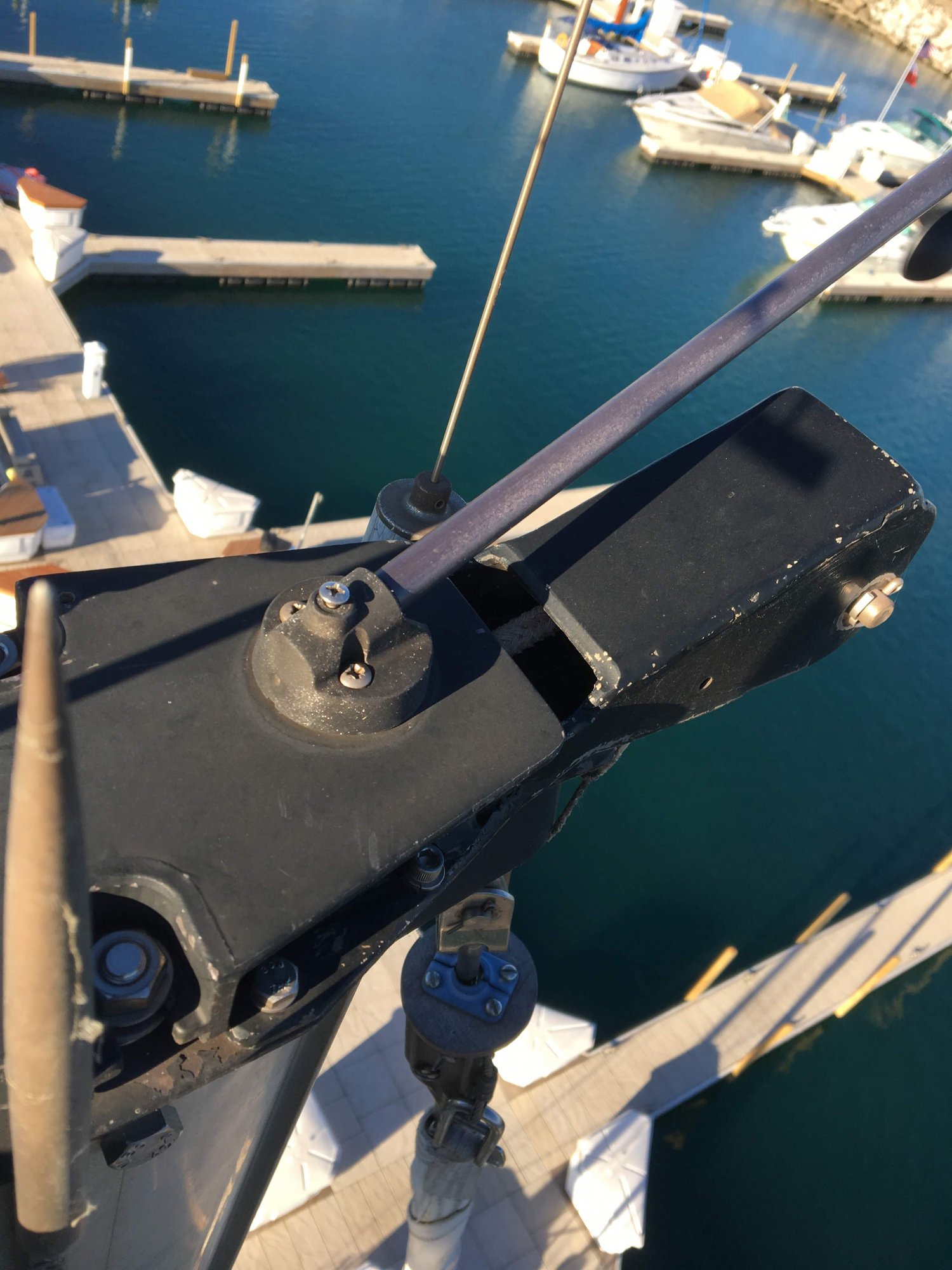

Not sure about your mast…on my O’Day 322, there is a big cap that would have to come off to access the top inside of the mast. This may give you an idea….but I have no idea what is on top of your mast.
You may be better running some sort of messenger line down the mast (paracord or something) with a length of bike chain or a stack nuts on the rope to help get it down the mast…then pull your cable with the messenger line…
You will also need to mount some sort of base for the anemometer (you can see it in my photo). That may require drilling and tapping the bolt holes…
If you can unstep the mast, that may be easier than trying to do these tasks suspended 37’ in the air, where you will have a hard time getting above the mast (unless the “lift” you are renting is a man-lift).
I was up on my mast last weekend to replace my windex light, install my windex and put my anemometer up for the season. I could not get my head above the mast….so everything had to be done by feel…above my head. No way I could have drilled and tapped holes in my mast head like that.
