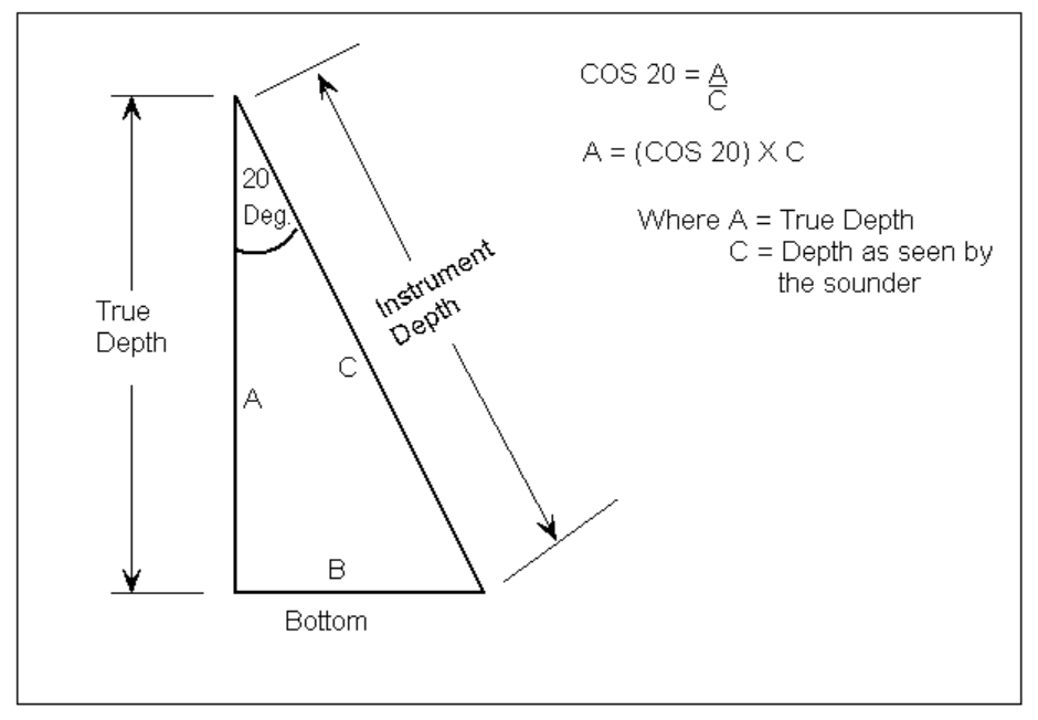

Nice catch @Mike Oldak . When you stop and see it in real life it's not that big a deal as long as the bottom is realtively horizontal.
IMO, a simpler way of looking at this error in depth is to go back to basic trig :
Just multiply what you're seeing on your depth instrument by the cosine of the angle of your transducer face to horizontal (which never changes) and you'll have your true depth, in this example COS 20° = 0.94.
And that assumes a worst case scenario of your transducer’s acoustics being perfectly directional. Airmar’s DST800 installation instructions say “Best performance on hull deadrise angle through 7°. Accommodates up to a 22° deadrise angle.” I’d take that to mean the signal transmission and detection operate in a 7 degree cone, so you can subtract 7 degrees from the actual deadrise in your cosine calculation (if all transducers have a similar beam pattern).
The OP’s case is probably on the more extreme end of installation locations. 22 degrees in one axis and 17 in the other is a net deflection of about 27 degrees (according to my friendly AI helper). Subtracting 7 degrees for a transducer’s acoustic cone leaves us with a 20 degree angle to compensate for (when the boat isn’t heeling). The OP has a Hunter 34 in the Chesapeake, so he probably has a shoal draft of 4.25 feet. The transducer is probably mounted 1.25 feet below the surface. So when the boat is aground an ideally installed transducer will read 3’, but an uncompensated transducer would read 3.2’. I suppose there probably aren’t too many anchorages or channels where that 3 inches is going to make all the difference, but I guess if you can be more precise why not try to.

I would expect basic trigonometry would apply.
Genuinely curious if there is something special beyond that.
A finer point on the original problem.
However, I still wonder why on a 34' Hunter with a likely larger flatter area on the bottom than my H-310 (wider beam), the OP could not find a flatter location for mounting the transducer :
This area of my hull is nearly dead flat and there are numerous other areas just as flat for locating an in hull transducer should I ever need to.
I guess you had to be there to appreciate the full extent of the problem.

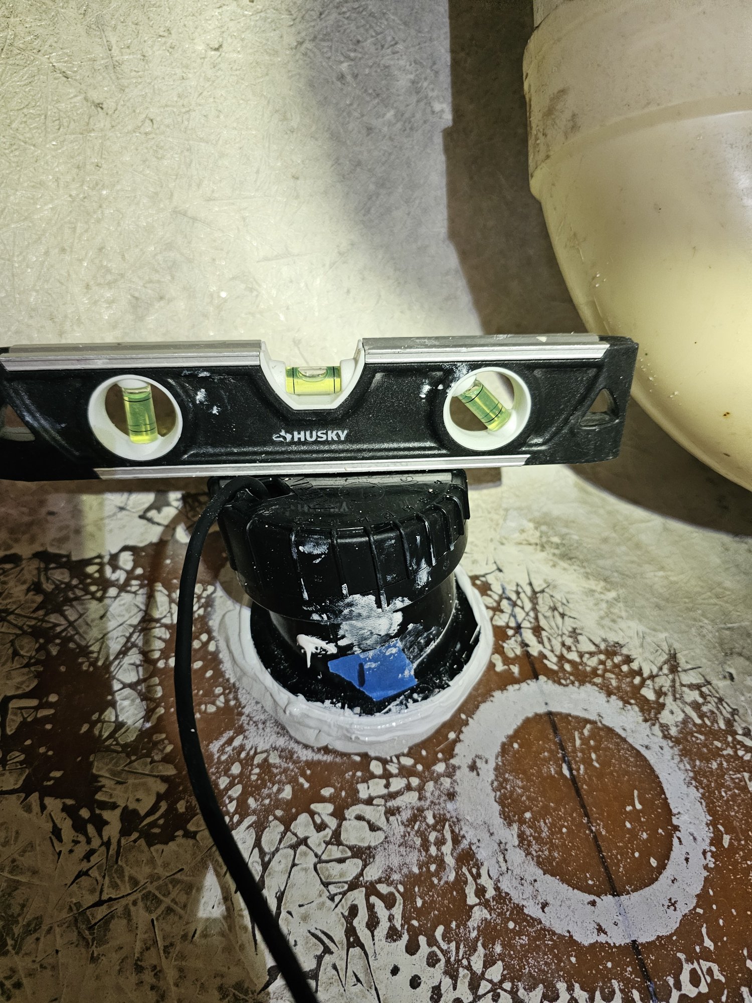

PART 2 CHANGE OF PLANS
While I have had success before with in-hull transducers, and had gotten good readings on the mooring (after 3 install attempts and using a water filled baggie to find a good spot on the hull), when we went for a cruise it really wasn't satisfactory at all. Apparently a Fortier 26 hull was either too thick or had a solid core.
A call to Raymarine provided the same response that I had received years ago on an auto pilot that didn't work on my boat. UNBELIEVABLY in this day and age they said "fill a warranty claim and we could pay the difference for a different transducer" since the fortier 26 has both a swim platform and tabs (unlike my H34) placing a transom mounted transducer was somewhat problematic. SO we are opting to have a thru hull installed next takeout.
