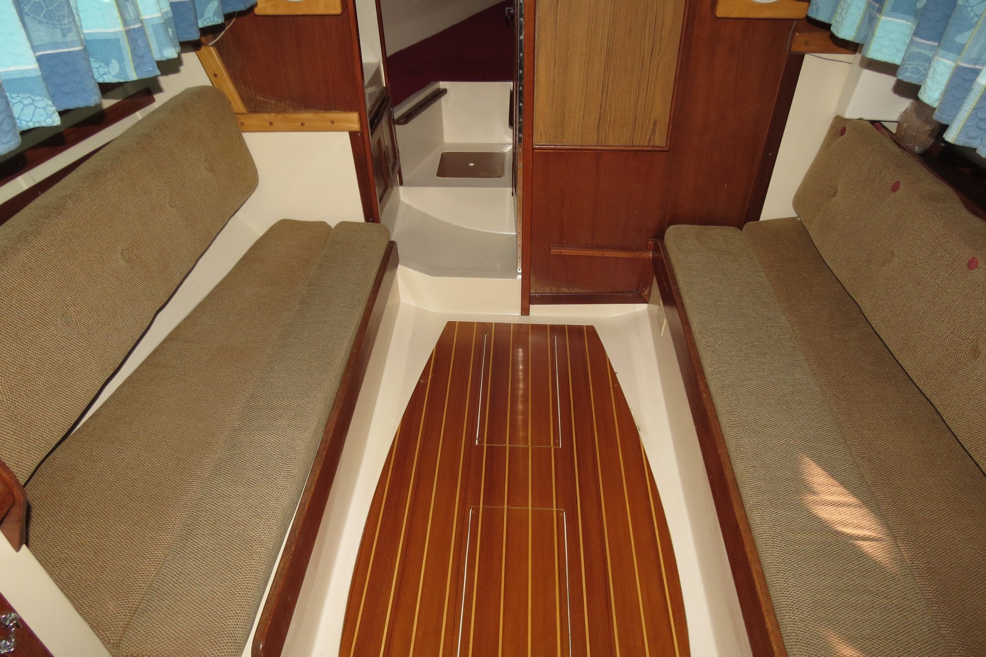

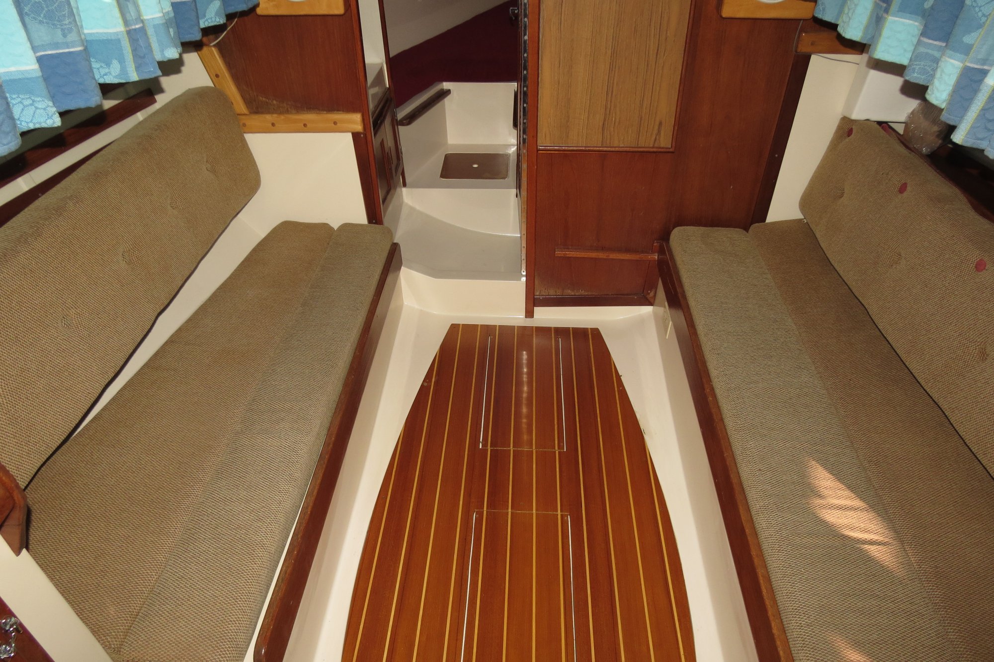

The most classic and best look is a teak & holly wood floor. I replaced mine on my Starwind 27 a few years ago, just before selling the boat. You can try all kinds of alternative methods, but in the end each one will look like a compromise. I bought a 4' x 8' plywood sheet from a wood products wholesaler in Bethlehem PA. They don't deliver ... I had to drive out and get the sheet. The sales department said they wouldn't cut it, but when I went to the warehouse to pick it up, they made 2 basic cuts that didn't affect my install and helped fit it in the car. I came with my own circular saw in case I had to cut it in the parking lot.
It wasn't cheap ... it was a little over $200 for the sheet, if I remember correctly. I don't toss around my nickels like they are manhole covers (to bastardize one of Mike Ditka's famous sayings about George Halas - you could look it up) so in my opinion, this is not very much money that you need to spend to make your cabin sole look the best it can look. If you have a nice boat (which you do), treat her right!
I had the old floor to use as a template and it would be easiest if you have an old floor to use for a template. This is not difficult woodwork if you can use a jig saw. Mine was simple to do in just one piece. The floor in my Catalina 320 is a more intricate shape and the teak and holly flooring was installed in pieces, so that looks just fine, too, if you have to piece it together in sections.
The flooring in my Catalina is laid over a floor pan that is recessed to accept the wood flooring. I don't know what you have under your carpet so the first step is to remove the carpet and see what is underneath. It will probably determine the thickness of material that you will need to buy. Here's a picture of my install. In the picture, I laid down the cutouts for the bilge openings to fill the openings. As you can see on the side edges, the kerfs from the cuts left too much gap, so I eventually made new bilge covers from the left-over material to make better fitting bilge covers. I had enough material left over from the 4' x 8' to make separate bilge covers and other panels that I wanted to make.
I'm pretty sure I got my material from Eastern Engineered Wood Products in Bethlehem, PA. That's not too far for you to drive out and get, I assume. Since they typically deal in huge shipments, they don't cater to people who want individual sheets, but at the time I bought mine, they said they get enough of these requests that if you are willing to drive out, they can provide it. I assume that you have enough woodwork in your Catalina, that it would look out of place if you did some other substitute product.

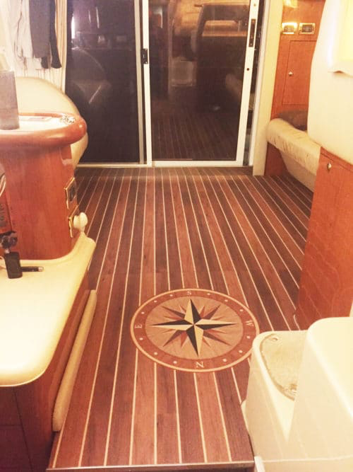

That is a good product. Only challenge is the glue used to laminate the ply is sometimes water soluble. Not an issue in a house with a roof over head on dry land. In a marine environment, on the floor of a boat :yikes:. A bit more risky. Not a boat sinking issue, but should you get an onboard flood you may be replacing some or all of the sole (boat floor). A product like Hydrotek, is typically made with more ply's per inch. Specifically they say that the plywood is "Virtually free of any core voids, high quality core veneers, and Phenolic resin reduces the chance for the panel to delaminate."
What types of criteria should you consider about a boat floor?
As you think about what you want for your boat, keep in mind there are several features your cabin sole must-have.
  • A solid and stable surface that allows for walking and standing.
  • A higher level of durability. Since flooring installation in a boat is a cumbersome task, you preferably want a material that will last several decades.
  • Anti-slip technology. This is one space that is going to be wet a lot! The last thing you want is for someone to slip and fall.
What you do is your choice. The size of your boat kitty you can expend, and how much time and effort you choose to invest.
This is just an image, not my boat.

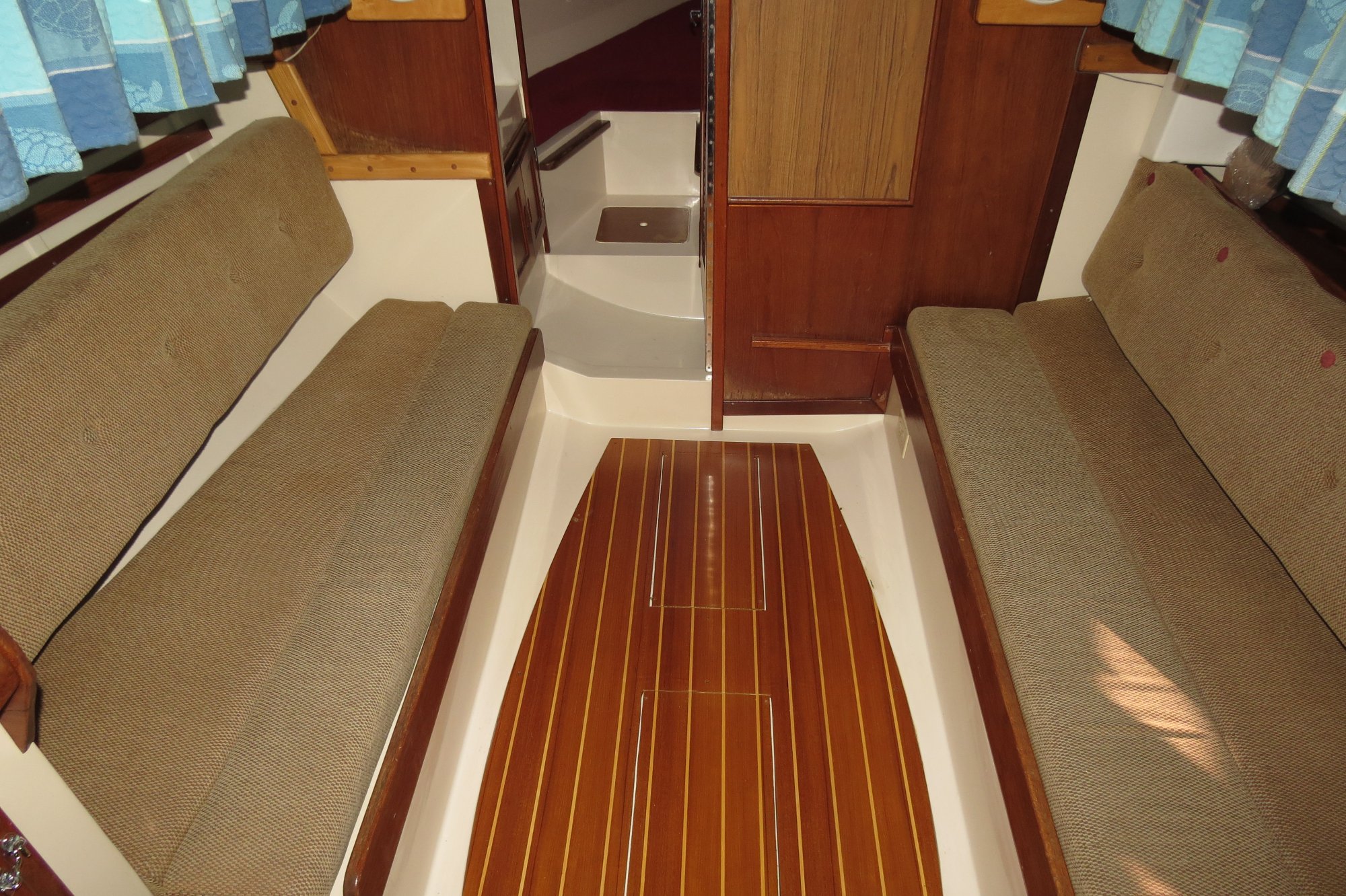

Wow your floor looks Rich!!!!. thank you for your imput
