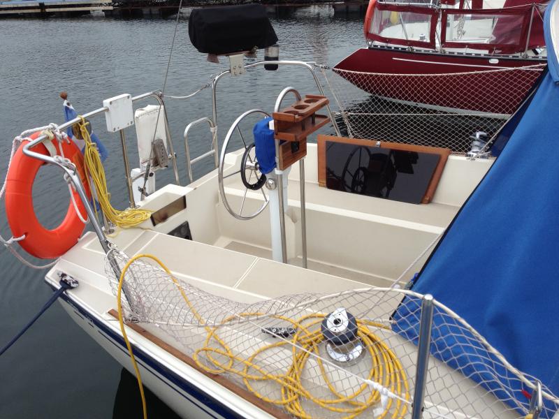

I own a 1987 Oday 272, equipped with a Wheel, and I consider removing it to install a tiller.

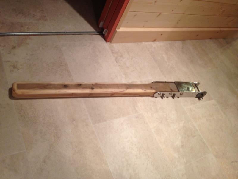

The previous owner kept a short tiller (picture) as a spare, in the case a cable would break in the system, so I have the connecting part.
What is the "perfect" size and shape of tiller for an Oday 272 ? I saw 46" somewhere, but it looks a bit too long. What do owners recommend ?

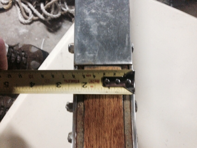

I measured the stainless steel connecting part between the rudder and the tiller.
The tiller must be 2" wide by 1"1/2 high at the "root".

Your picture shows a rudder head that looks identical to mine. I will check my tiller tomorrow and let you know. 46" sounds pretty good, though.

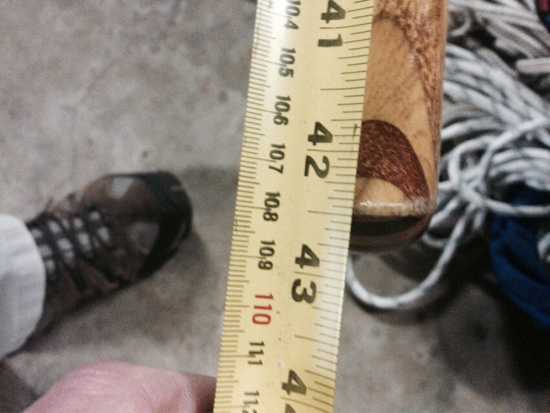

Here are the measurements:
Looks like 42 1/2" for the tiller.

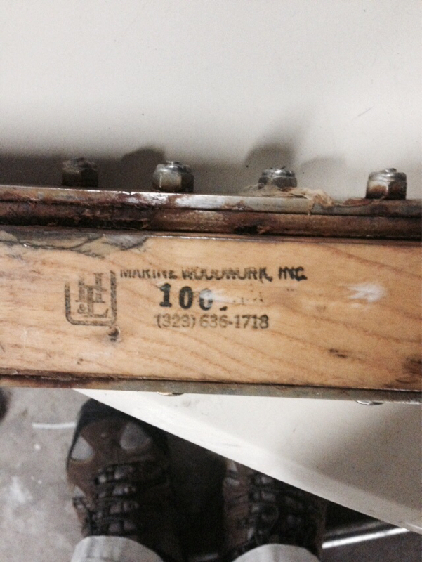

I did find a phone number stamped on the bottom:
Here is the measurement of the rudder head:

Thank you very much for this information. I think I have the same rudder head. 42 1/2 seems a good choice, due to the big area of the rudder (not too short, not too long !).

The wheel is nice looking and is very easy to set so the boat keeps its direction in moderate winds (using the brake). The pedestal gives support for the GPS (I have a Montana 600), the compass and a few cans...
On the other hand, it takes half the cockpit, which is boring, and not only at the anchor: When I sail alone, tacking is not easy due to the position of the wheel in respect to the genoa winches... Also the backstay is always a nuisance.
But it is true that removing the wheel and associated gear to install a tiller is far easier than the opposite, as Apex says !
