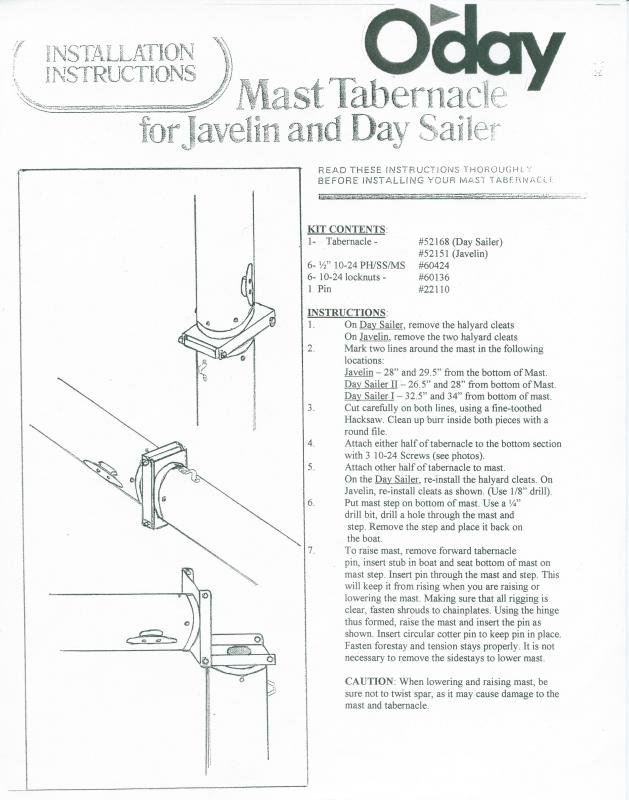

I just bought a Daysailer 17 and am amazed to find that the mast is stepped through the cuddy cabin to the sole. Has anyone ever cut the mast where it enters the cuddy and installed a tabernacle there to make stepping the mast a one-person job like all other dinghies?
Jun 2, 2004
1,956
Oday Day Sailer Wareham, MA
Not only have many owners (but not me!) made that modification, but it was a factory option until O'DAY changed to a tabernacle as standard in around 1983. Parts (ie. a kit w/instructions) are available from D&R Marine, www.drmarine.com might be best to call Rudy at D&R for advice and to be sure he sends you the instructions with the parts. (508) 644-3001 (I actually have a copy of his instructions, even though I'm in no hurry to modify my mast yet). I keep my DS II on a mooring for the Summer, so I step the mast in the Spring on launch day and unstep in the Fall when I haul out.

I have found a hinge-like piece made by a company that recognized the problem of a mast that steps through the cuddy to the sole. the mast is cut about six inches above the cuddy and the part fits into the lower part and into the mast with a pin connecting them so that it can be lowered and removed. that way nothing is changed in position and the balance is not changed. Thanks for your input.
Jun 2, 2004
1,956

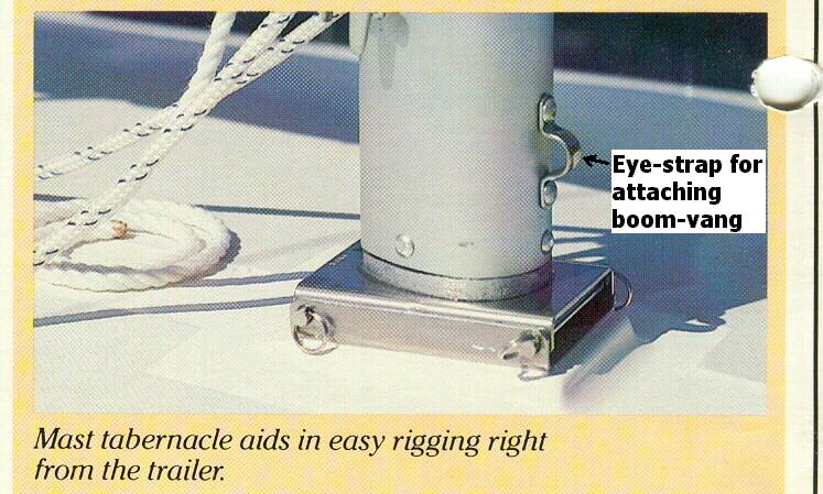

Joe, essentially O'DAY did that around 1982 when they made the hinged mast standard. I like the simplicity of the spliced-in hinge like I show in my posting above, but think that I'd mount it lower than O'DAY suggested so that the lower part of the hinge would rest close enough to the top of the cuddy to slightly compress a rubber/foam gasket or a bead of RTV caulk. The DS has a reenforced "ring" around the opening in the cuddy top where the mast goes through, so a wood or Starboard block would need to be routed out to accomodate that. We have pretty strict Class Rules about these things, so anyone who races or wants to keep the boat "Class-Legal" needs to keep those rules in mind. The hinge is certainly allowed, but I'd be leery about just how much I'd modify things.

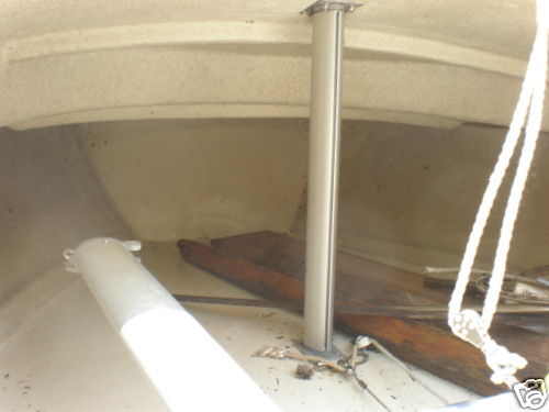

When O'DAY made the hinge standard they eliminated the hole in the cuddy top and molded in a flat area for the hinge. They still used a section of mast extrusion as a support under the mast step, but it was not removable anymore.
