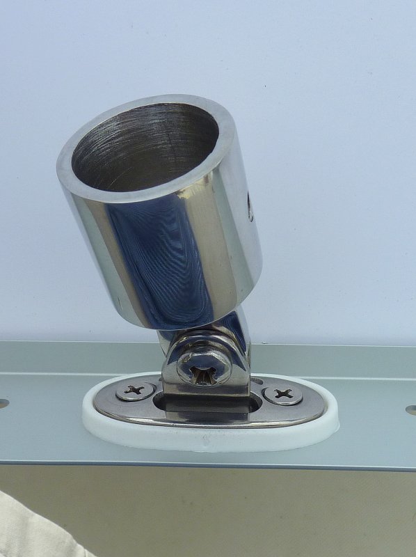

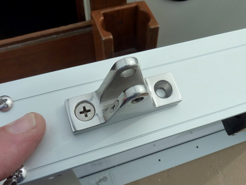

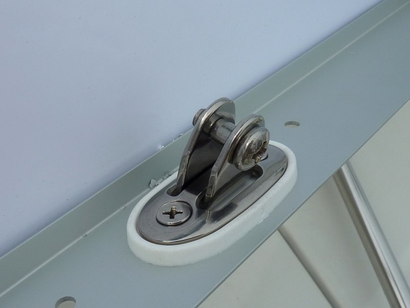

Followed this DIY and have the hardware coming on its way...I actually ordered my GV-4 today and realized the company is out of Boston so shipping was only $5...
Have not ordered my panel yet as I am not sure what to go with...I'm leaning towards this panel from Amazon though.
The hardware for installing it in this manner comes out to be pretty expensive as these stainless steel parts end up costing quite a bit...Ordered mine from Defender.com...I did however skip out the "flip-flop hinged deck" piece as first of all, I could not find it anywhere and second, I will just used a regular hinge fitting like this one to save a few bucks...

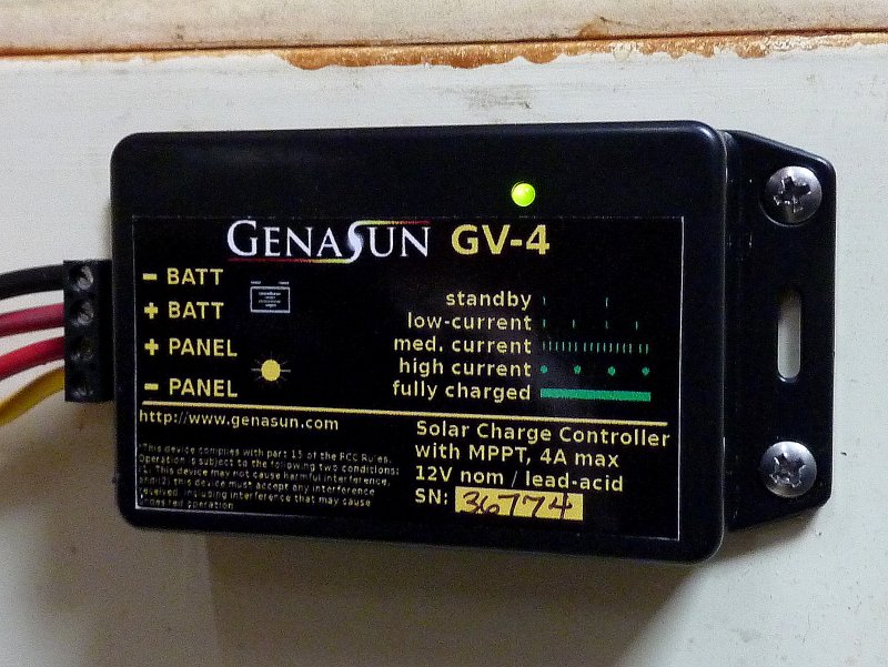

Thanks for your informative post, Maine Sail. Questions:
1. Do you use the genasun gv-4 with AGM batteries?
2. Do you ever use a bus bar (like the Blue Seas dualbar) instead of a combiner to "parallel" two panels, i.e., down below near the controller? By small panels, I mean two 40 watt panels.
Feb 6, 1998
11,723
1. Do you use the genasun GV-4 with AGM batteries?
Yes the GV-4, and the other sizes, can be used with AGM's. If you have special charge voltages you want they will also sell you a custom programmed version. Be sure the controller can handle your 80 watts. The GV-4 is the smallest and can only do panels up to 50W. You'd need the GV-10 for 80 watts..
I don't use a "combiner" to combine two panels as it is not an appropriate use. The combiner is only to combine two battery banks when charging voltages are present.
For your panels simply wiring them in parallel would be the best option. If your panels have good old fashioned junction boxes, a very good option to look for when buying panels, it is easiset to "parallel" the panels inside the j-box before running to the batteries. If paralleling panels they should ideally be the same make/model..
