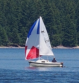

I looked hard at the Selden. I decided too build a similar rig using an aluminum pipe tube (2" diameter, thick walled) and the stainless bow fitting with a welded tube that let the pipe slip through it. I kept the length to about 4 ft. This put the sprit out in front of the bow and maintained most of the sprit on the foredeck which I secured to the hard point in the foredeck.
Here is a look at the assym I had made on my Montgomery 15.

I couldn't justify the price tag on our C-22, and did a similar design myself (link is to the first post - several more follow). If I did it again, I'd probably use carbon instead of aluminum.

Good point. My understanding is that it's pretty standard to add a bobstay to the Selden for a code zero (higher load than a downwind asym). But that's just gleaned from Internet research - I haven't seen it in practice.
Beautiful!
Do you have any pics of the build?
