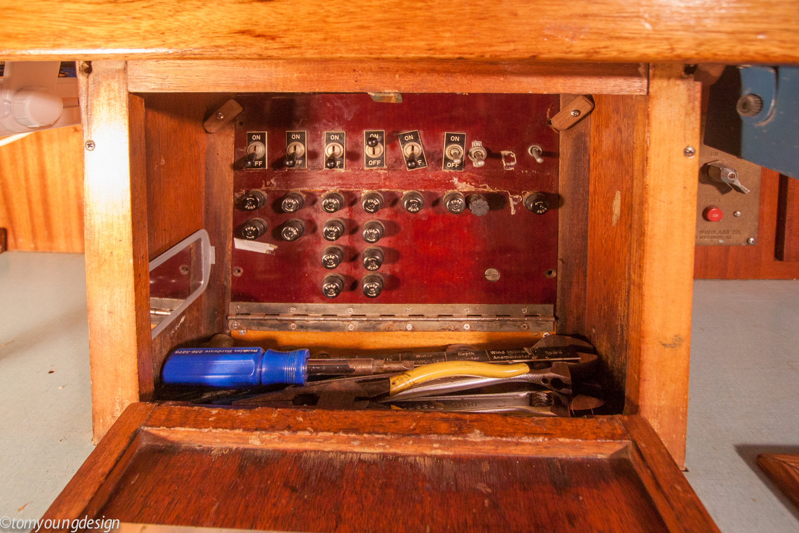

The DC switch panel on CHRISTMAS - a 1961 Challenger - is original. I've considered replacing it in the past, but always with other more pressing projects, I've left it alone.
Mainly because, it works fine (amazingly,...).

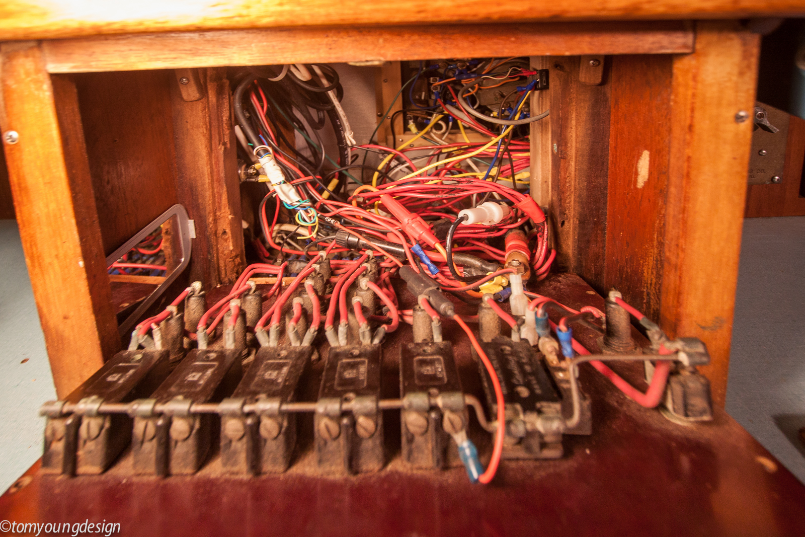

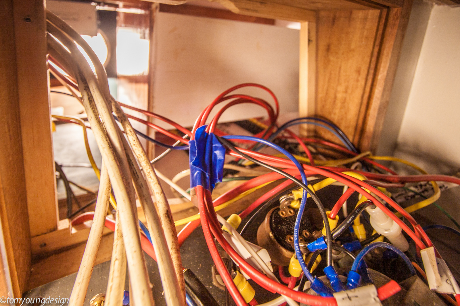

The glaring problems aside; multiple connections on both the + - power posts, inline fuses, mind boggling heaps of wires, it's interesting to see how standards have changed since 1961.
The main unfused feed comes into the panel on the right and the + is distributed via a stiff exposed copper wire, to the switches. As well as connected with copper bands around the exposed wire, plus the connections are soldered.
All switches were STDP (single throw, double pole). Some of these STDP switches divide individual circuits - as many as 4 circuits on one switch - that have devices with independent switches such as cabin lights, or navigation and mast wiring, which have their own switches in the cockpit.
The feed and terminals are still exposed, and not fused at this point.
Through the STDP switches, the individual circuits are sent off the switch terminals (some with 2 ring terminals on one screw - to create 4 circuits), to individual soldered SFE fuse holders mounted in the panel. The feeds - finally fuse protected - then connect onto standard terminal strips (invisible under the spaghetti), and run to various devices.

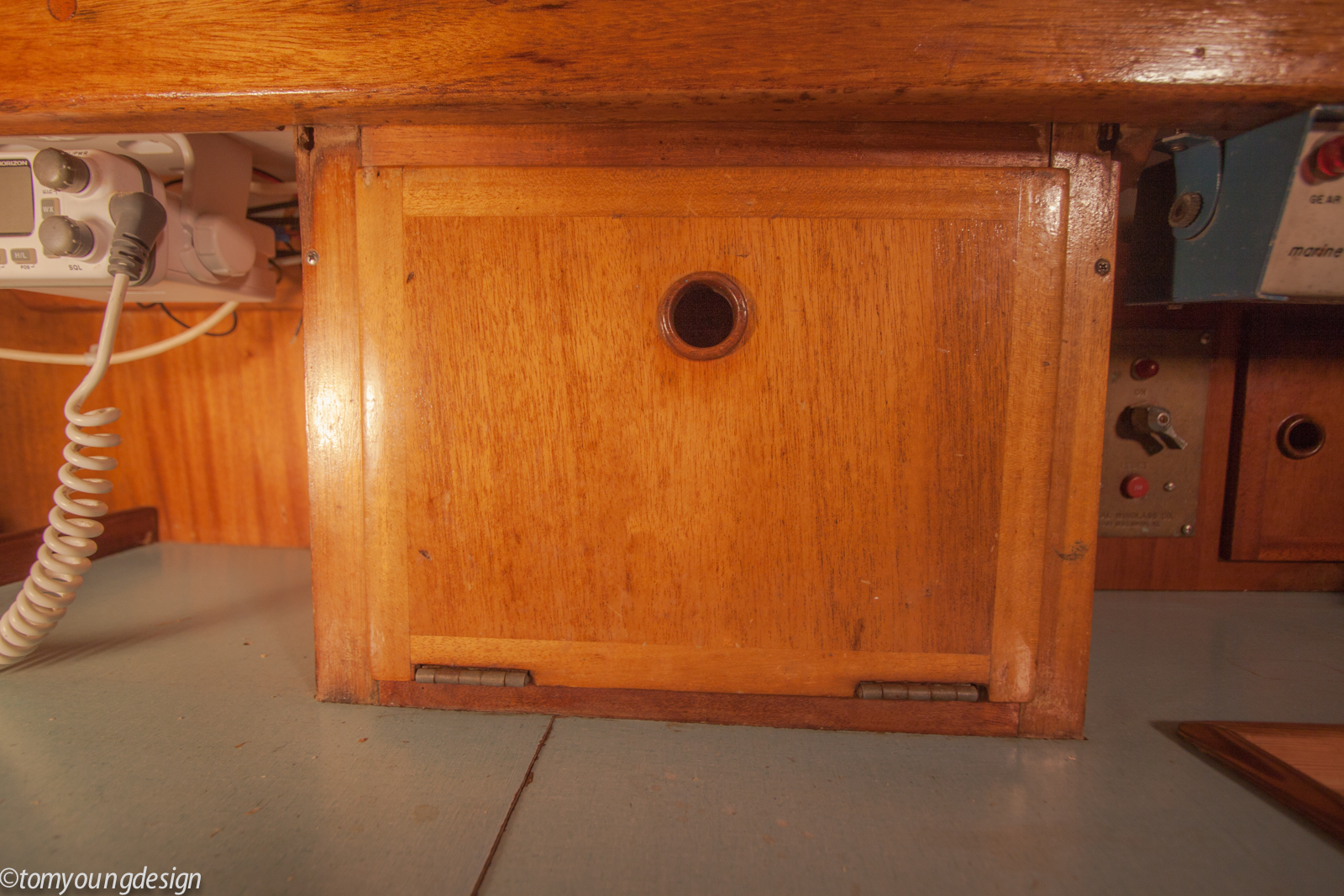

I haven't any pressing projects on Xmas, so this winter I'm replacing the panel. The panel is well used up.
The simplest solution would be to buy a generic breaker panel. As I plan to keep the enclosure that hides the panel (I especially appreciate the space to store a few most used tools, a knife etc. in the storage forward), options were limited to stock panels that would fit inside.
I'd spend 1k in parts and end up with a panel with too few circuit capability, and have to put another fuse block, somewhere.

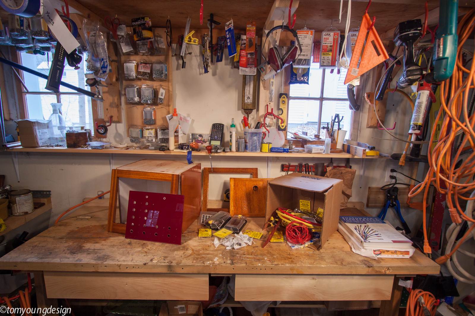

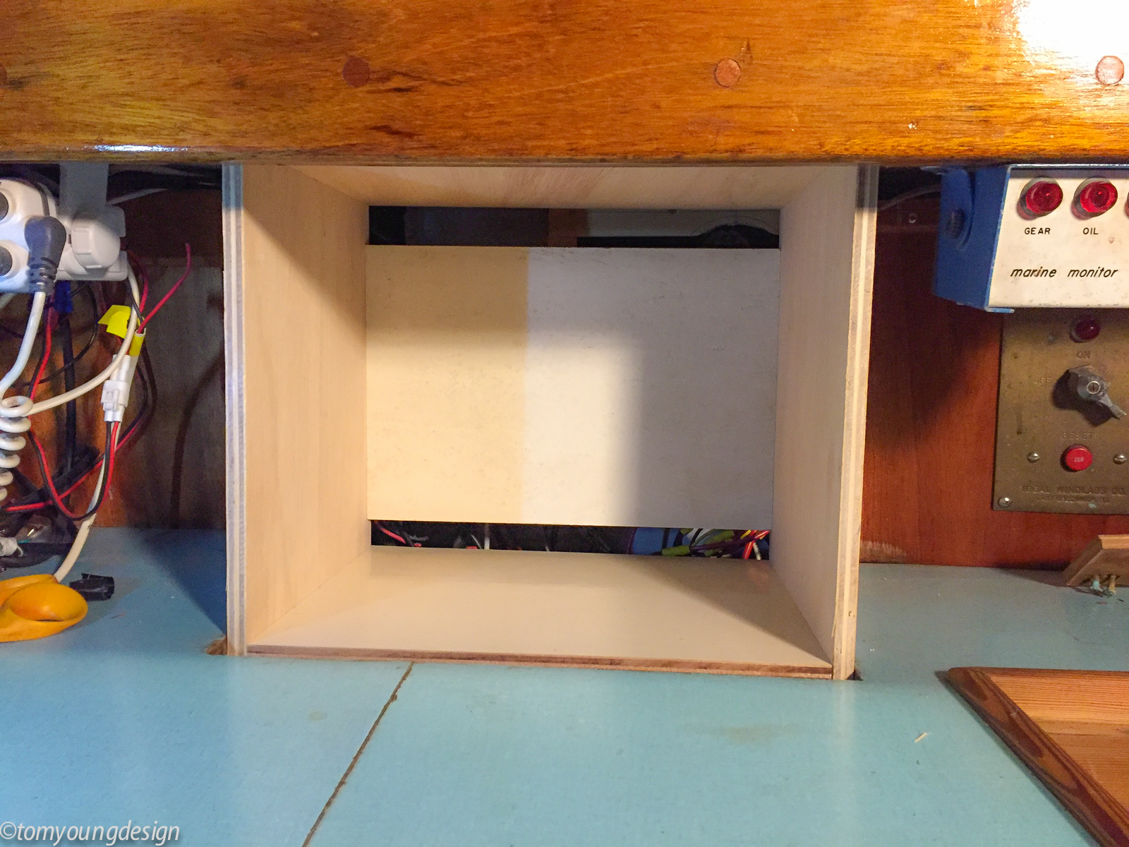

Having decided to keep the original cabinetry, I promptly tore the cabinet out, in pieces.
Restoring the cabinet carcass would have been more work than building a new one. I'd restore the door that was built by the Danish craftsmen at the Poul Molich yard in 1960, and replace the rest.

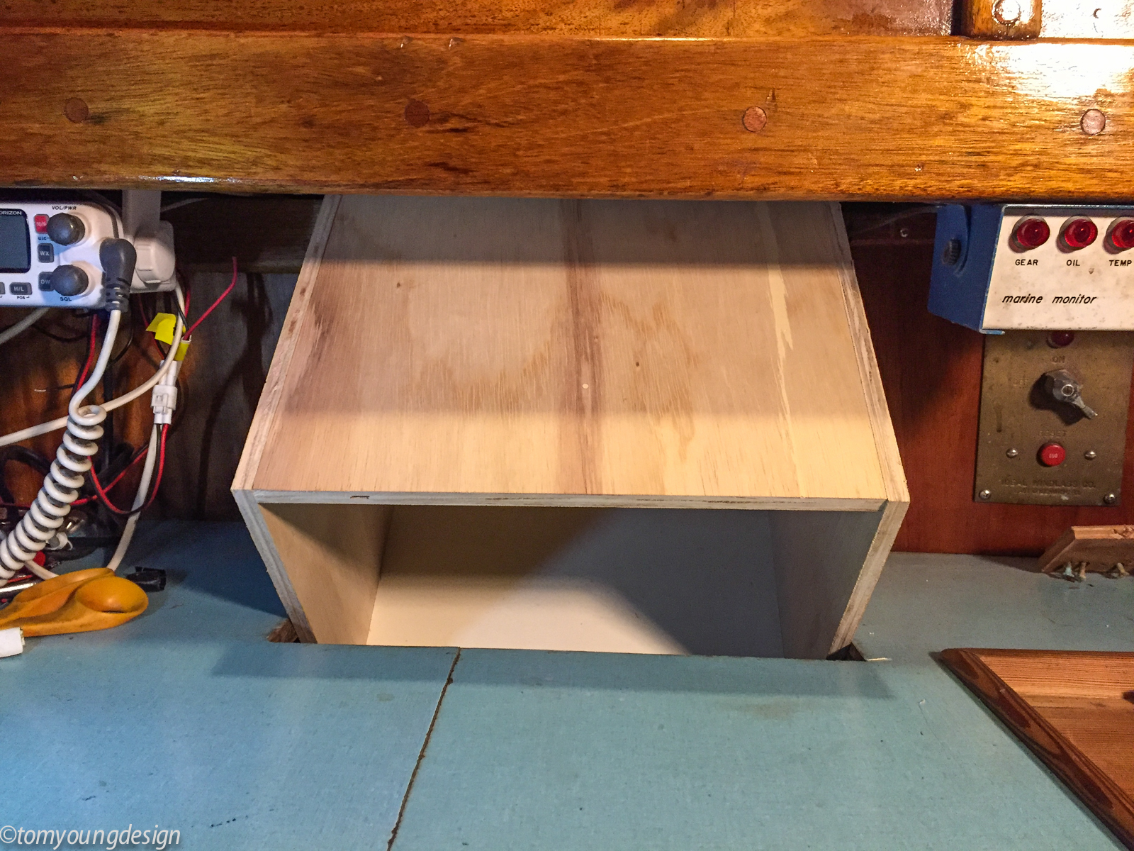

With wires snipped and everything torn out, I built a duplicate of the "box".

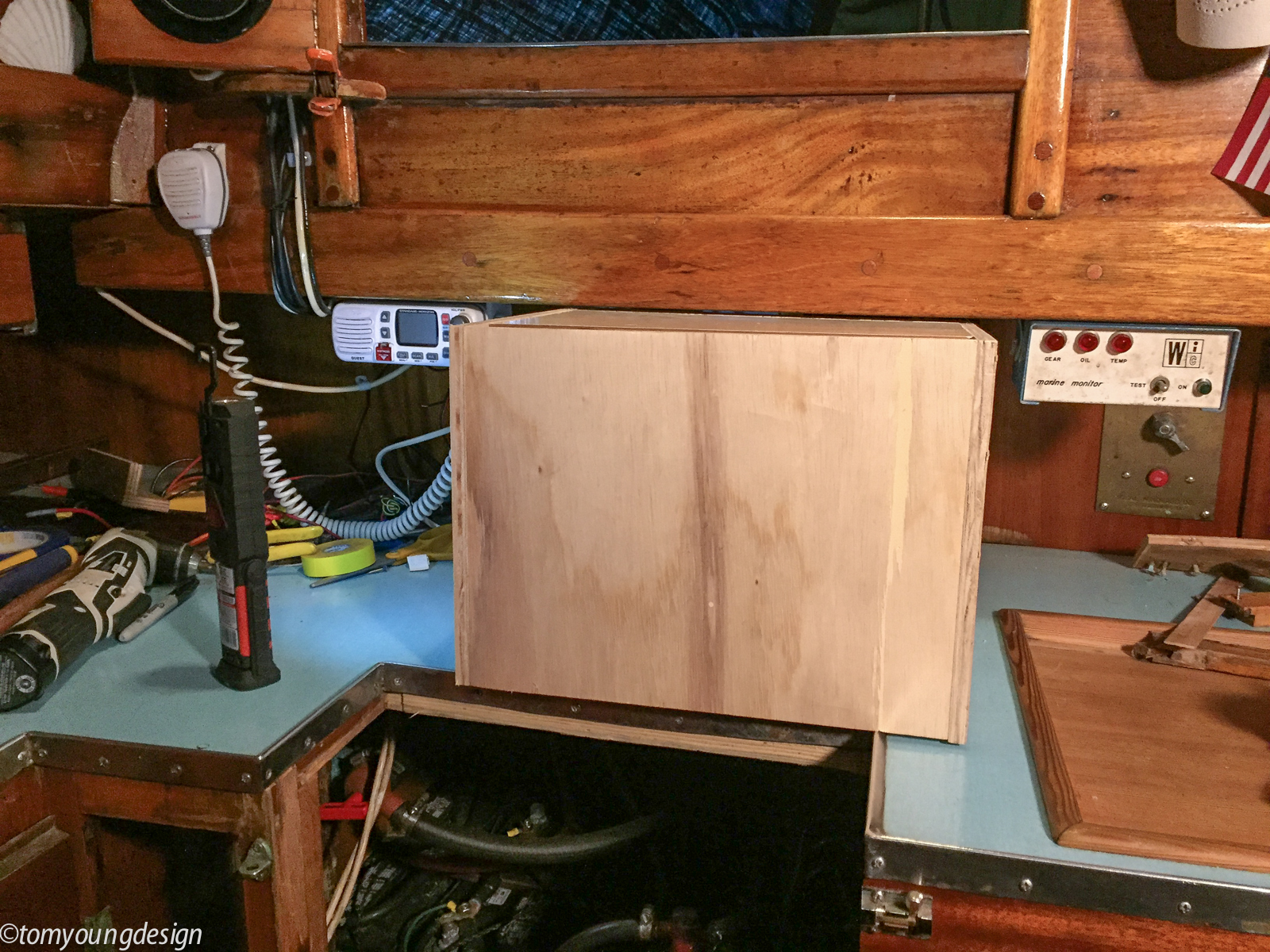

Then returned to the boat to see if it would fit as planned: It will have to slide under the bridge deck,...
....rotate into the cut out in the countertop,...
...rise up to the bridge deck, and Bob's your uncle.
Fitting as original, the piece allows the galley counter top to be removed(in 2 pieces) for major access below.
Satisfied, I took the box home to complete, at my leisure, in a warm shop.

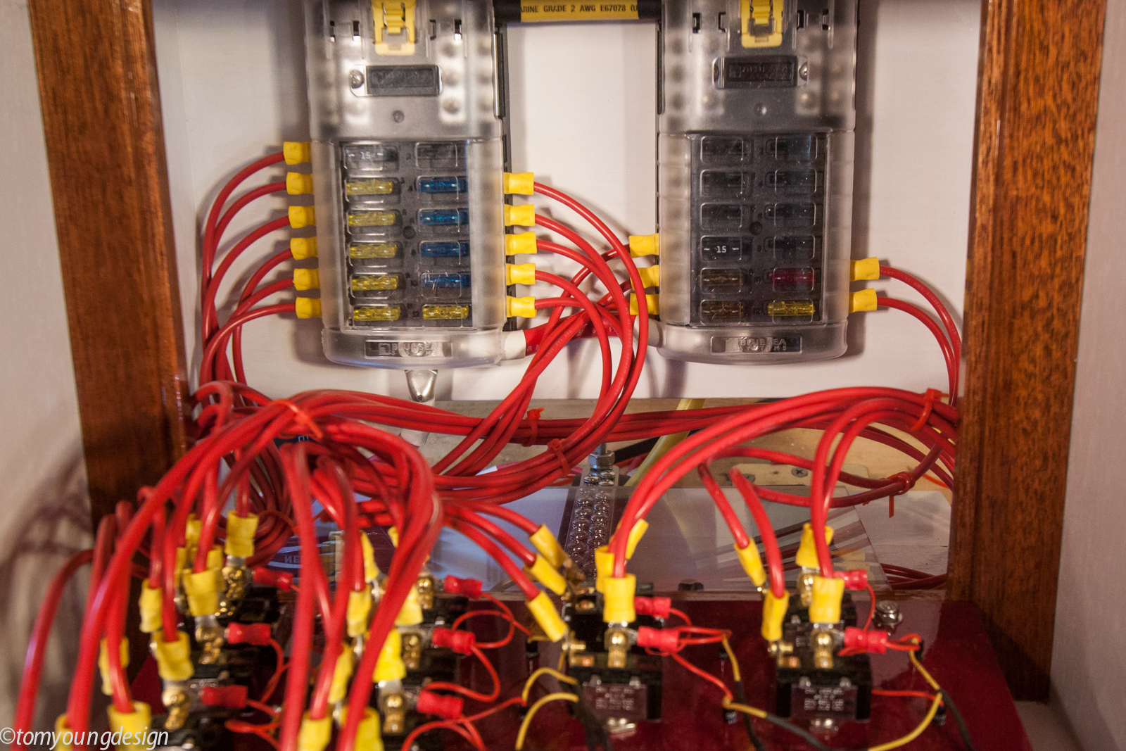

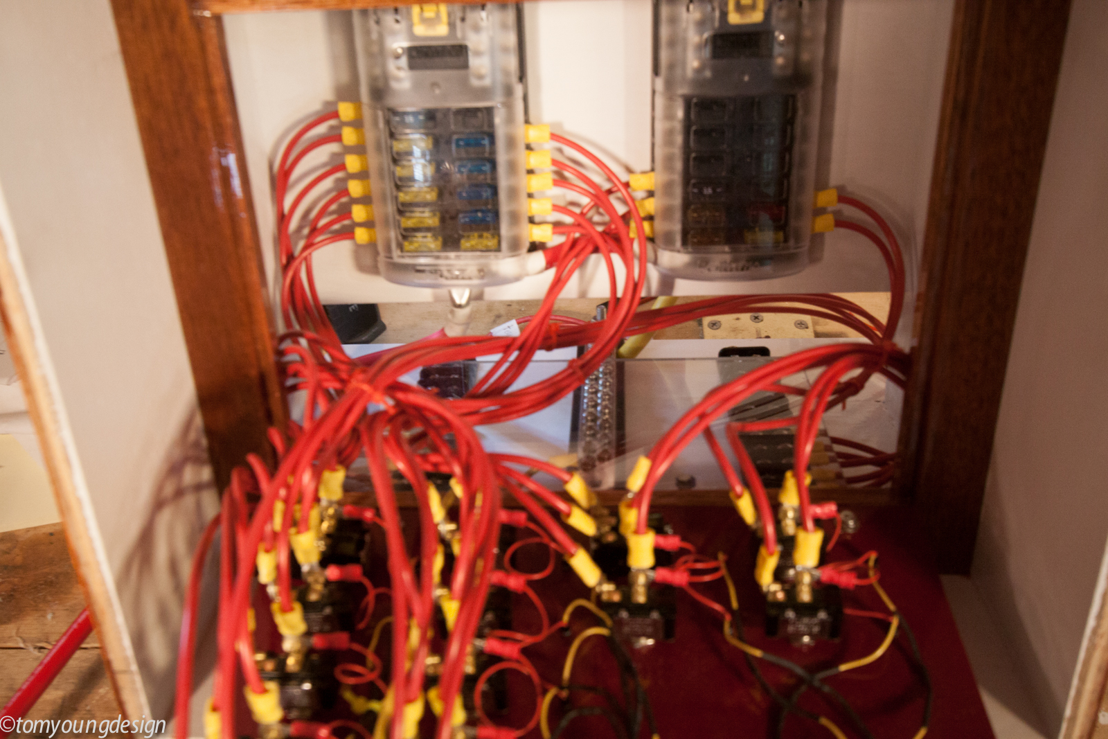

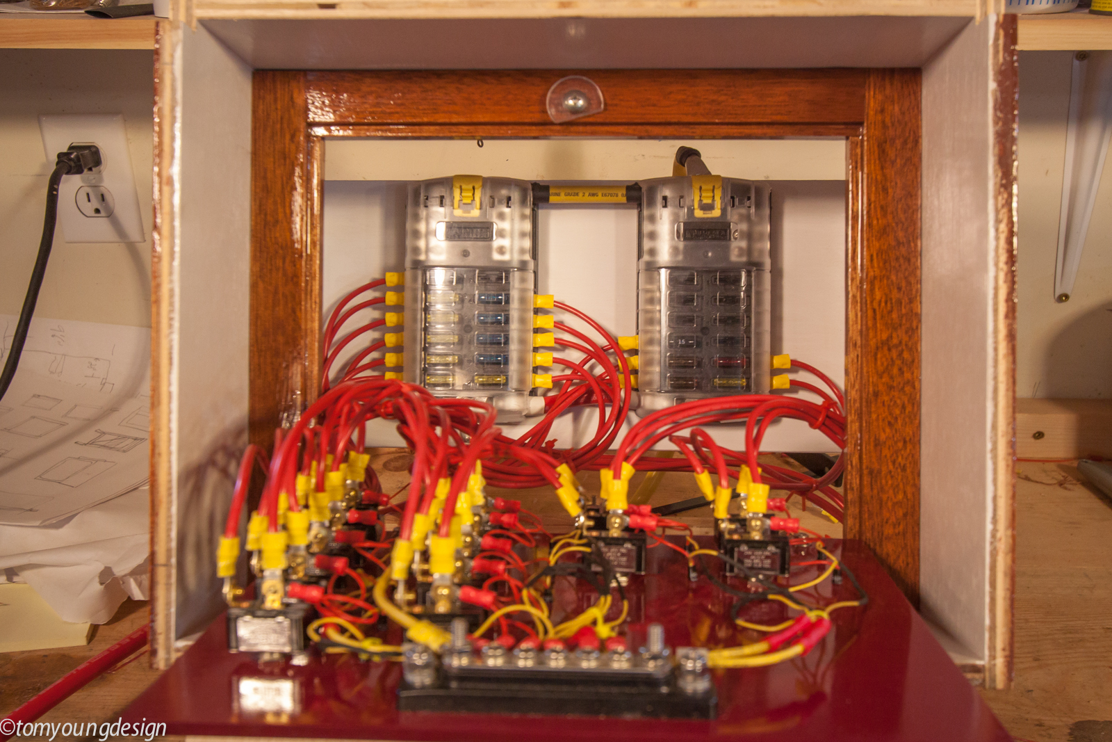

I opted to install LED indicator lights on each switch. This turned out to be a challenge. Fiddly 26 gauge wires and parts.
First, how to crimp the little (26 gauge by looks) wires. Research showed several methods. Mainesail had a great article on using correct sized terminals and crimper. I needed to be compact with a small - buss bar mounted on the panel. Plus, combining wires on terminals would shrink my required space on the buss bar.
In the end, I opted to use (18-22) terminals; either doubling up wires, or folding it back on itself.
ABYC standards I could find do not prohibit doubling or folding back, but they have strength requirements. So I went with these methods followed by a sharp 'tug' to test each terminal. The indicator lights were wired first to keep the small wires close to the new switch panel and tested.
My boats DC power is simple. A small (2-GRP 27) house bank and a separate starting battery. The two can't be connected. The house runs off it's own switch and 1/0 AWG.
Blueseas 5026 fuse blocks fit well in the small deep space I had to work with. The ST fuses, easy to read and spot, will be a nice change from the old fuses. In reality, I've had to change perhaps 3 or 4 fuses in 30+ years of fused boat electrics. Still a confined space, it's much improved over the old.
Once the box is installed, a 2 AWG will run 2' from the main switch to the fuse blocks. I plan to put a 100 amp fuse on the house bank switch(batteries lack space over for fusing on posts). The 2', 2 AWG neutral from the house bank, will connect to the lower buss bar and then to the fuse blocks.
With the 2 AWG wire size, tests have shown there is no detectable voltage drop between house bank and new terminals.
Result: 14 toggle switches (2 STDP*), wired with 12 AWG, supply 16 fused-switched, circuits available at the new terminal strips in the bottom of the box, better visible here:
I used 2, 12 position Blueseas terminal blocks (outer) and one 20 position neutral buss bar in the center.
I didn't like the folded wires resting (chafing) on these terminal blocks so I fit a piece of 1/4" polycarbonate between, better visible in this photo. The easily removable piece has two holes that fit on two SS bolted posts. Wires from switch to terminals run outboard of plastic piece.
The boats many feeds for devices (lights, instruments, etc), come into the open back of the box, and run in the 2 channels between terminal strips, beneath the plastic piece. The feeds are then connect to their adjacent and designated, + - #8 screw terminals.
All the hardware on the 2 AWG side is rated at 100 amp or higher. From the fuse blocks, the hardware is rated at 20 amp or higher. In practice, most of the circuits will be fused at lower amperage because of the lines wire size connected at the terminal strips.
About 5 of my circuits will be 24 hour(devices with own switch), and connect directly to the Blueseas fuse blocks.
I'll end up with 3 spare, wired - switched circuits, 4-5 empty 24 hour circuits, and space on the panel face for ?
All the work has been done on a bench at a comfortable height, in a warm shop. The box is about ready to install and make the connections to the new terminal blocks. I'll post the installed photos,...in warmer weather.
Note: (2DPST*) one double pole feeds two separate cabin light circuits, another feeds 2, 12VDC sockets, each 20amp fused.
Note2: ST fuses in photos are for testing. In reality they will be different amperage.

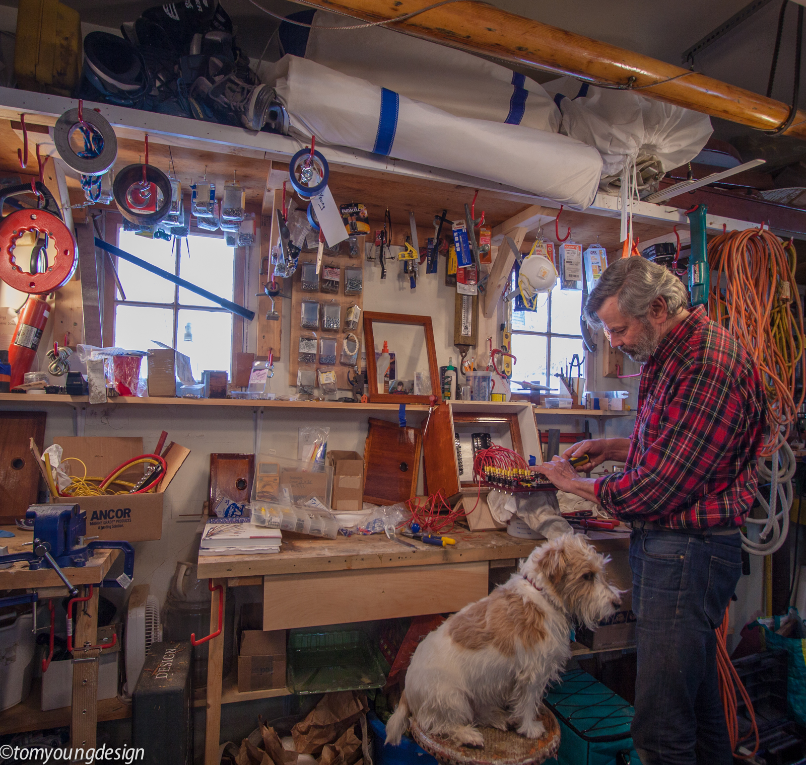

I think you're right, Jon. I should have led with this photo: One of our old Jacks was fascinated watching my daughter clean the circuit board on an old VHF that got dowsed with salt water.

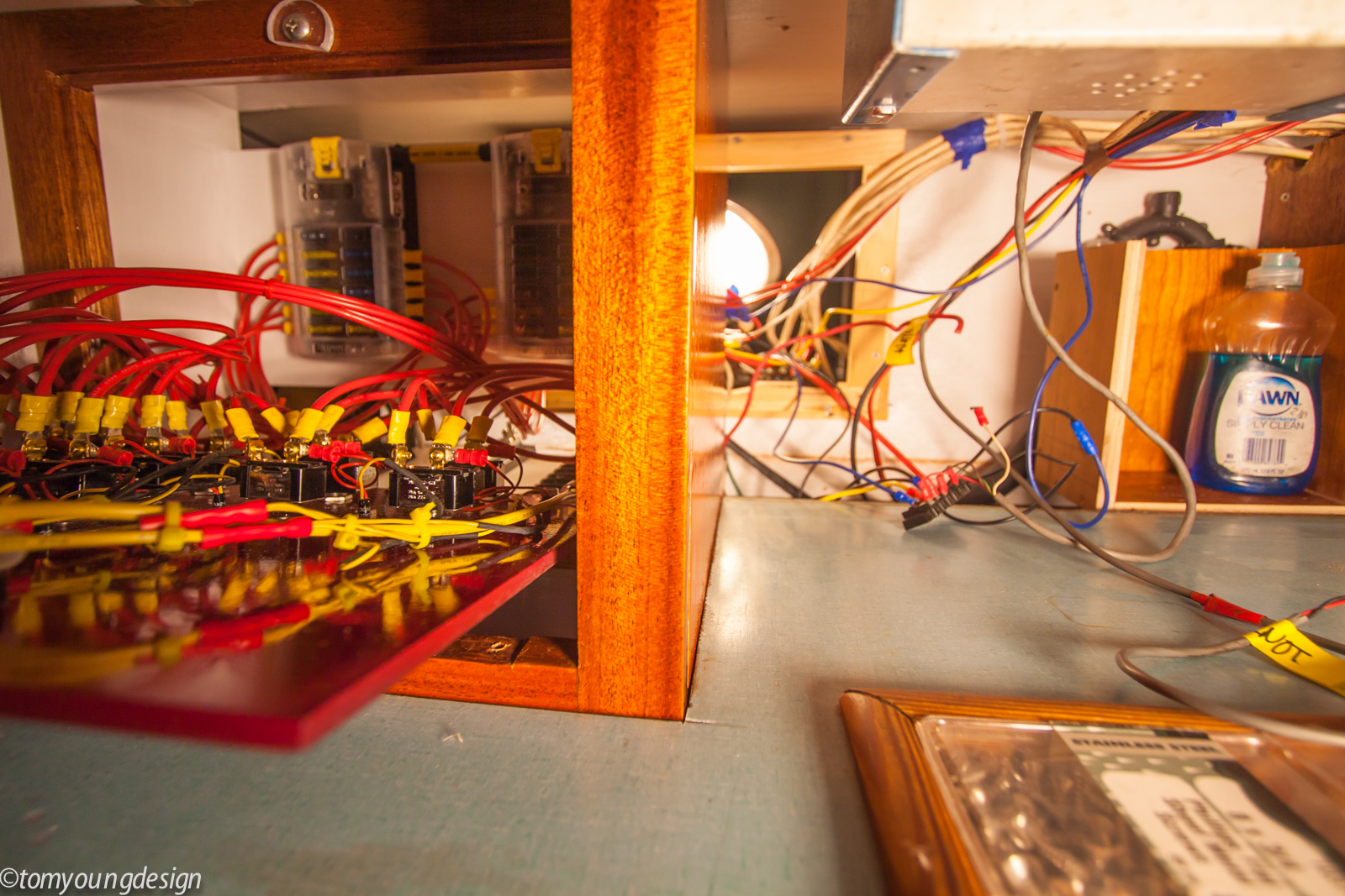

A string of warm days enticed me to spend a few hours getting the 'box' installed in the boat. With the main panel folded down and the engine panel opened in the cockpit (plus a removable panel to the port side), there is decent access.
Here is the view of the back of the box from the cockpit.
The manhole in the cockpit sole is handy for work like this. You have a place to stand (in the manhole), while you work wires from the cockpit(this work would be murder without it).
And a place to stand in the cabin to work from this side. I'll be making many, many trips between these two stations.
Even in an electrically simple boat like mine, there are a lot of wires! It's good to unravel the 50+ year old braids,...no dreadlocks, of old and new wiring.
Then there are those wires that I curiously marked with a "?", last fall, to trace.
I'm gathering up parts -again - for the final installation.

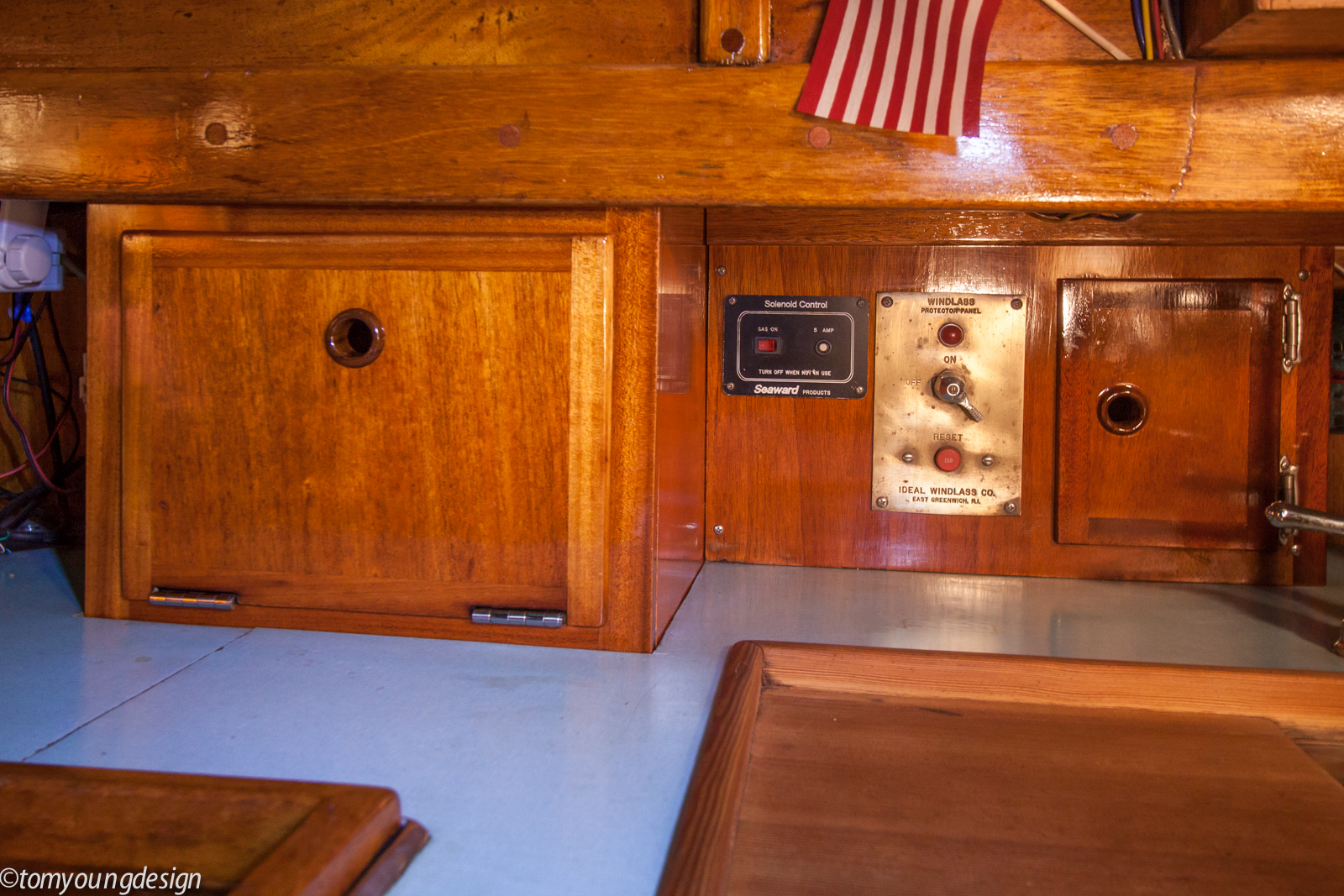

The restored switch panel cabinet, is back in the boat. The old one was really beat.
I love to do restoration work. The cabinet door is the original 1961, stripped and re-finished. The new cabinet face frame is built with mortise and tenon corners, just like the original. The mahogany is reclaimed from my old cockpit. It's beautiful old wood and matches well. The 'box' I cheaped out on. It's standard Luan plywood underlayment. I stained it with Interlux Chris Craft red filler stain, and then varnished. I wouldn't have used it if was more visible but I'm amazed how good the cheap plywood looks. The panel next to it (removable for access) got a couple coats of varnish.

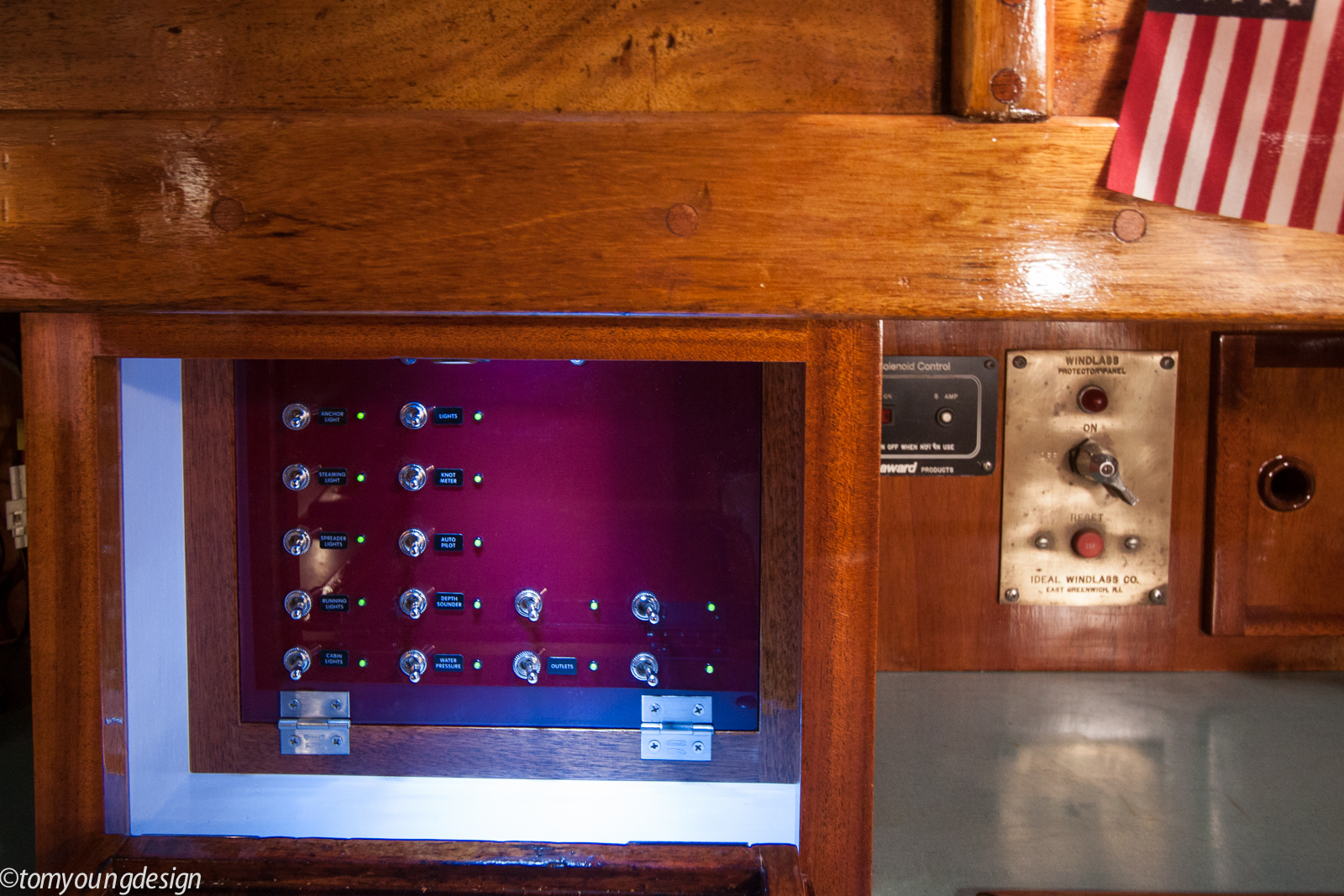

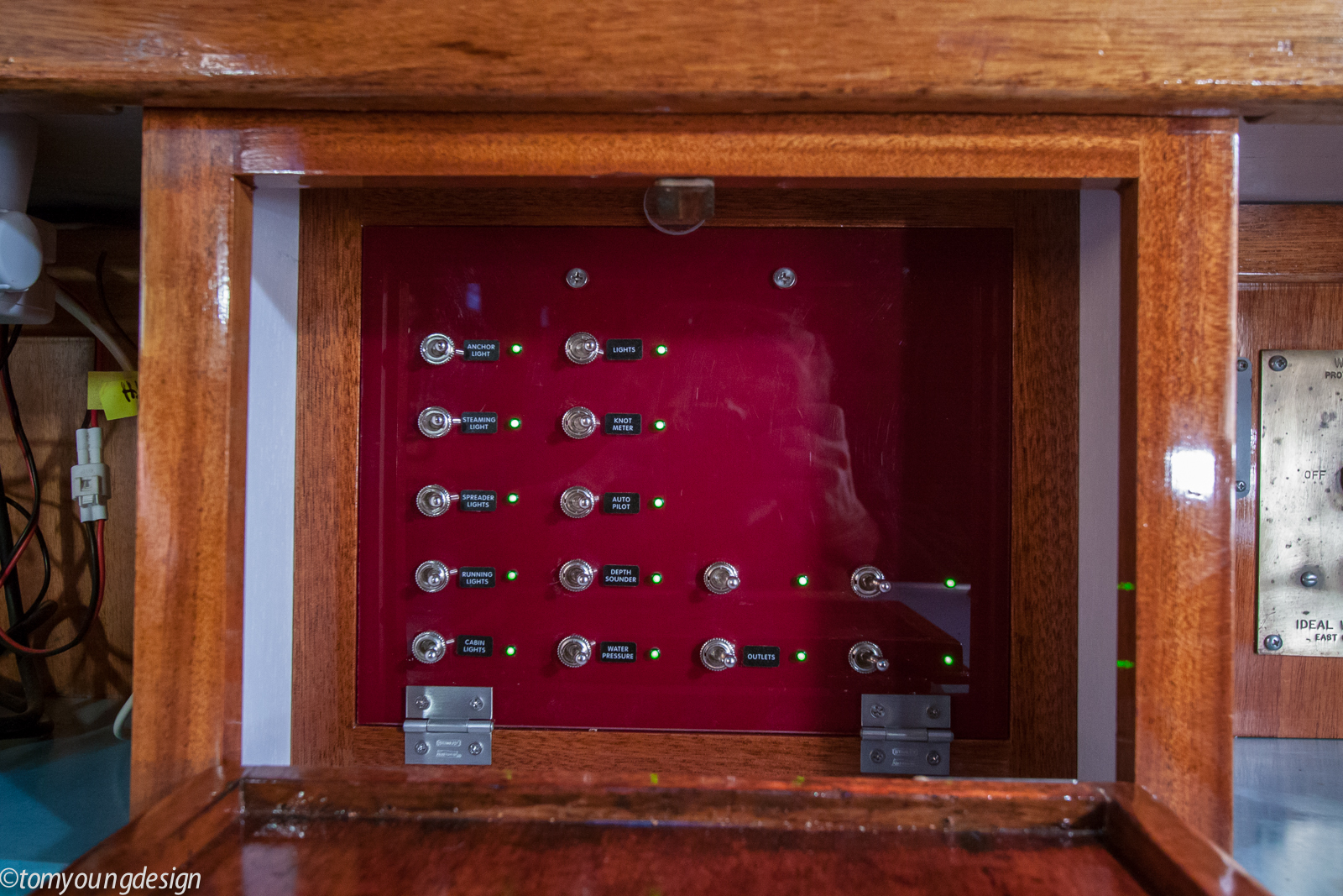

The new switch panel (drum roll,...)
The boat is tucked under a green tarp and all the lighting for photos is with LED work lights. It gives a purple cast to the photos.
I taped a small LED worklight inside the top to see if a small light might help. It really turned purple! I've got one on order as well as some for the engine room. A few more circuits to connect, and done.
