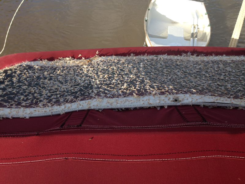

You mean like this? no big deal- they brush right off. I'd rather deal with this than chance getting clobbered by a guy in a skiff who was NOT looking up.

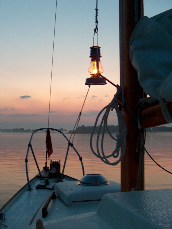

"COLREGS say 360º white visible at 1NM. I've been told a kerosene lantern meets that spec."
Used to use a kero light. Pain in the rear. Have ton carry LOTS of fuel- gallons on a prolonged cruise, as in weeks and months
I now use an LED light- MUCH simpler, and much brighter
Your boat, your choice.
But I've never heard of a case where a sailboat was hit at anchor, and certainly not where the hitter claimed they could not see the mast-mounted anchor light. At approaching distances the actual angle between the deck height and mast height is actually quite small. You don't have to look up to see it.
