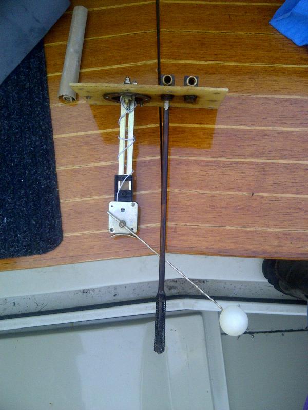

Anyone have some experience on installing a dip stick into the access cover of fibreglass diesel fuel tank?
The 30 US Gal (113 litre) fuel tank on our LM 28 has a new sender but it does not seem to be “linear”. I dropped in 36 litres and it indicated over half-of-a-tank. When I added another 50 litres it went to about 90 percent.
Anyone ever do such an install and willing to share thier advice?
Below are pics of the tank’s access cover through which I’d like to install cover for a dip stick hole. on pic is the cover on he tank and the other is the fibreglass cover on profile

Although my gage appears to work, and provides me a fair representation of the fuel in the tank. I have a 1" dowel that I've marked in 2 gal increments for my tank. Learned this one from my dad who never had a fuel gauge on any of his boats.
Just make sure the dowel is long enough that it can't fall into the tank and file notches in the dowel for the increment markers.

I have round tank and a dipstick.
The previous owner 'calibrated' the stick by adding fuel one gallon at a time, dropping the stick in, and making small notches for each gallon added. He then painted each notch with nail polish.
Works like a charm. I have the advantage that my fuel filler goes straight down into my tank so no extra holes needed in the tank.

It would be much easier to calibrate the gauge based on actual gallons in the tank. This is pretty easy if you know the tanks capacity.
#1 Drain tank
#2 Fill tank at 25% of capacity increments.
#3 Your first mark on the gauge glass will be 1/4 tank. A Sharpie or paint marker works well.
#4 Your second mark on the gauge will be 1/2 tank
#5 Your third mark will be 3/4 of a tank
#6 The last mark will be full.
#7 If you really want to get fancy you can take the gauge apart and make a new gauge face with your custom marks on it.

Thanks all for the input.
The dip stick may be a winter project but MaineSail's Sharpie System can be done tomorrow.
At the start of the season fuel tank was pumped clean and wiped clean. http://forums.sbo.sailboatowners.com/showthread.php?t=154184 I took a picture of the fuel gage after the first 36 litres were added and then when an additional 50 litres were added.
These photos will give me the 36/113 mark or about 1/3 mark and the 86/113 mark or 3/4 mark. Just need to find the photos!
