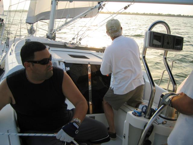

Late this summer I installed a set of doors I purchased from this site on my Catalina 310.
All in all, I was very happy with the outcome. One thing I did discover was that the companionway is not square, i.e. asymetrical. On side was a little longer in length. Also, the door top is not bevelled as the hatch boards are. If you trace your boards, on one side, they come a little long and you will have to sand them to make them fit.
The instructions were good and included a DVD.
Although many may find them pricey and yes, you could probably make a set for a lot less,... in my case, I don't have the time or the skill to produce a comparable product.
