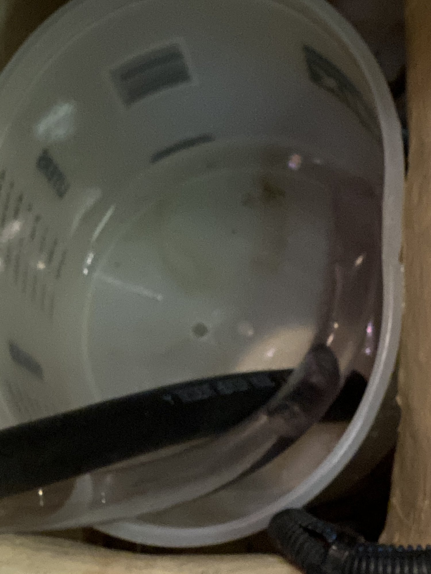

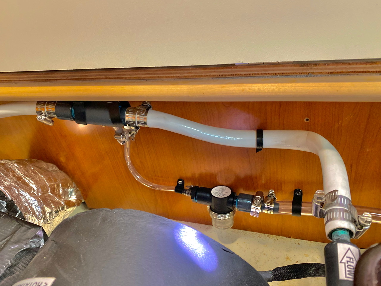

Just finished installing a Marvair CR330 Condensation Removal Kit for my Dometic 16k a/c unit on my 2009 H36. 1 hour and $139 from Defender. Half the price of the Mermaid Condensator. No more emptying gallons of a/c condensation from my bilge capture bucket, or having it end up in the bilge if I get lazy or forgetful. Very easy to install and silent. Will replace bucket with sealed Tupperware container with access holes in lid for a/c pan drain and evacuator hose. Gotta love a dry bilge.
