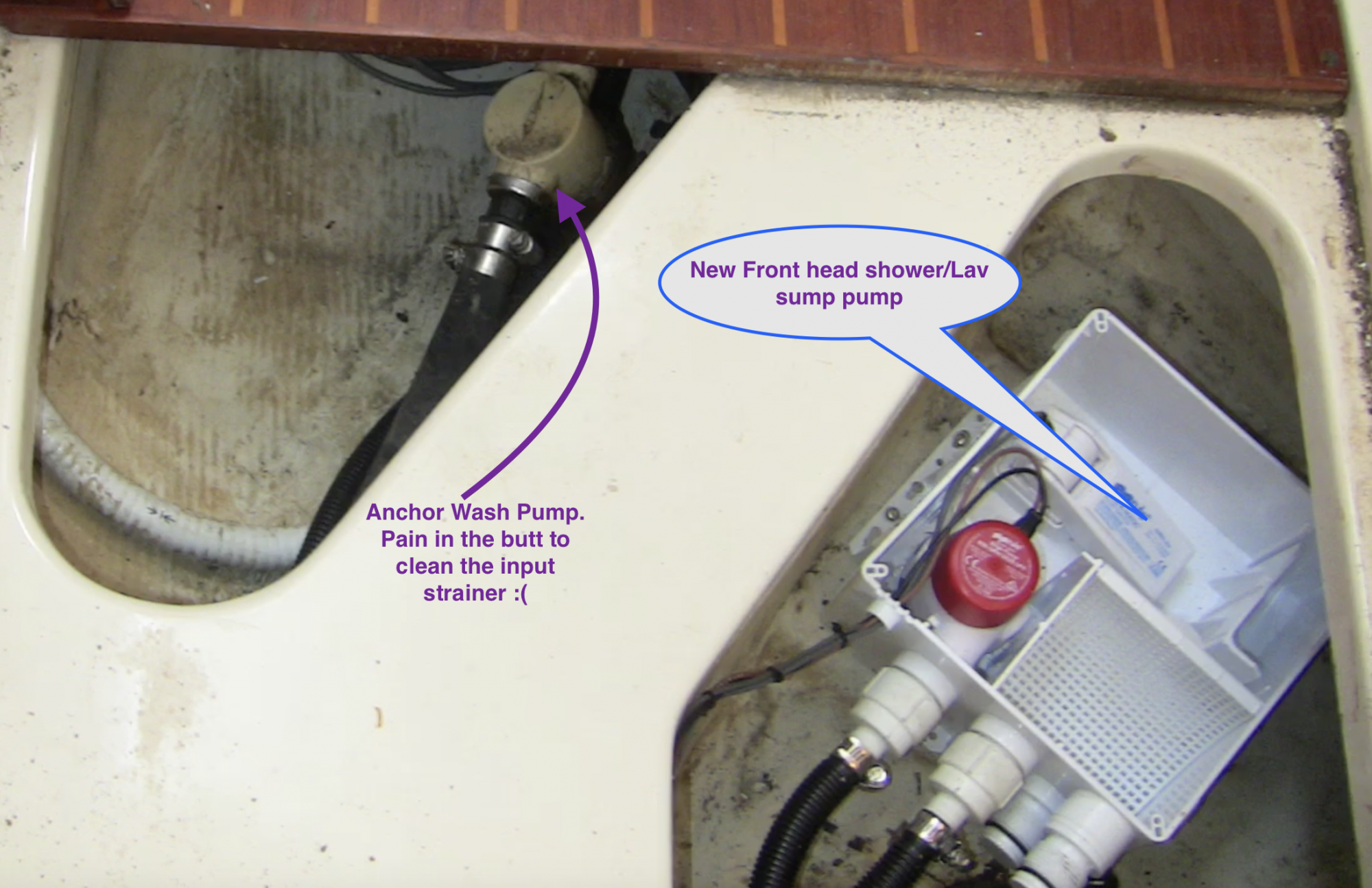

JamesG161
Feb 14, 2014
8,111
Hunter 430 Waveland, MS
A Few pictures of my installation, now.
and the discharge area
Hope this helps.
Jim...
