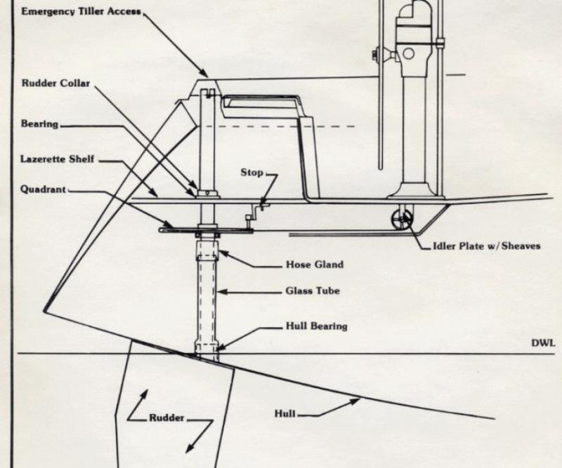

Yes a rudder can be installed in the water. The tube it runs in ends above the water line. The attached drawing of the 37's rudder installation displays how the rudder system is designed.

wow, the 37's rudder is way aft of the 33's. on my 33' it is directly under your feet as you stand at the wheel.
