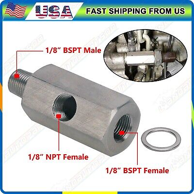

@Rick D I think I found an adapter that would allow both my 1/8 in BSPT sensor and a 1/8 in NPT oil pressure gauge to be attached. Does this look like it would work?
  • Helpful
Rick D
Jun 14, 2008
7,207
Sure, why not try? Certainly cheap enough.

@Hello Below Thanks for the link. I'm still a little confused as the article doesn't specifically say it is a male 1/8 BSPT or a male 10-1 BSPT. I've found adapters for both 1/8 inch BSPT male to 1/8 in NPT female and also 10-1 BSPT to 1/8 in NPT female. Not sure which one is correct. Anybody out there have an authoritative answer?
