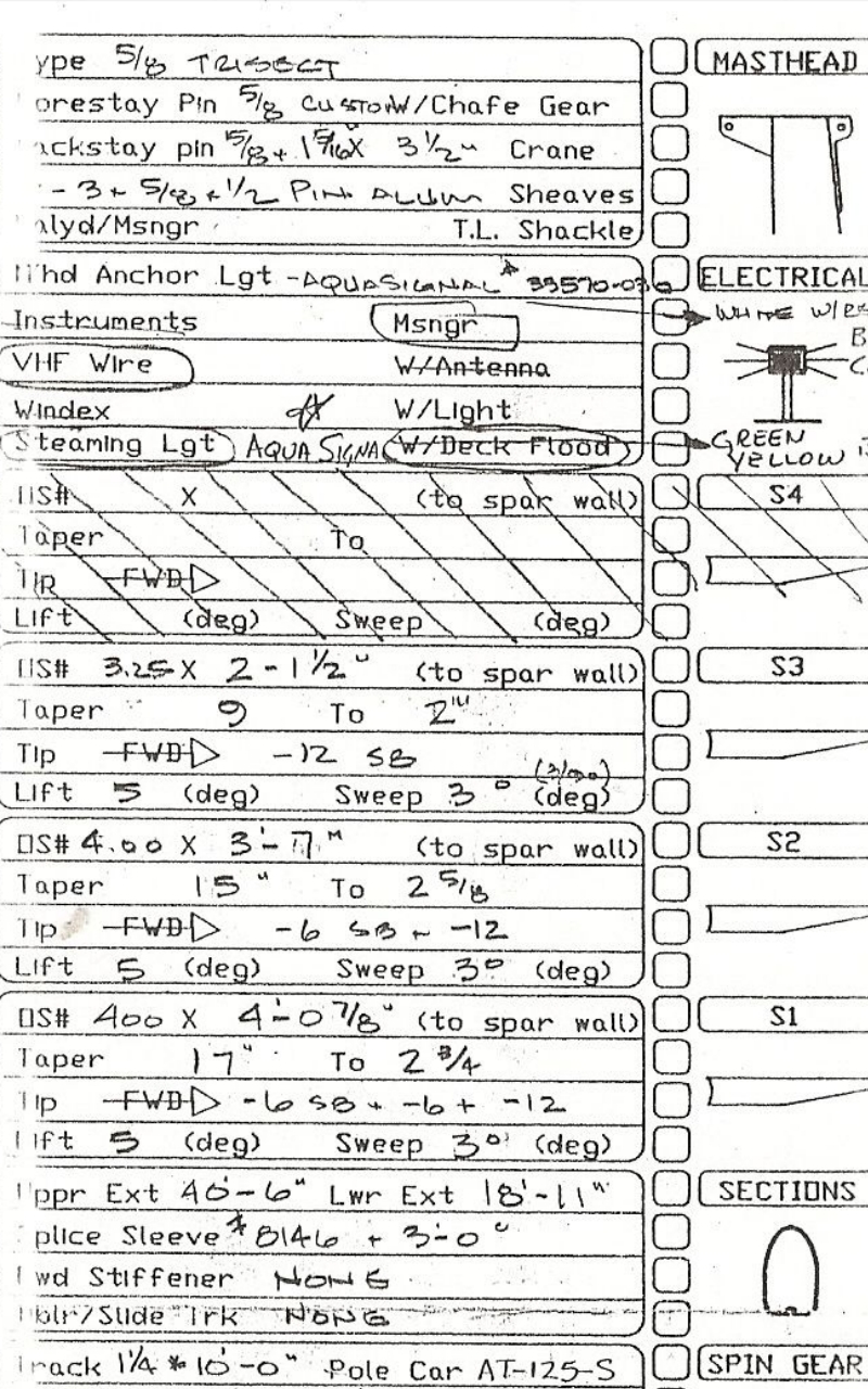

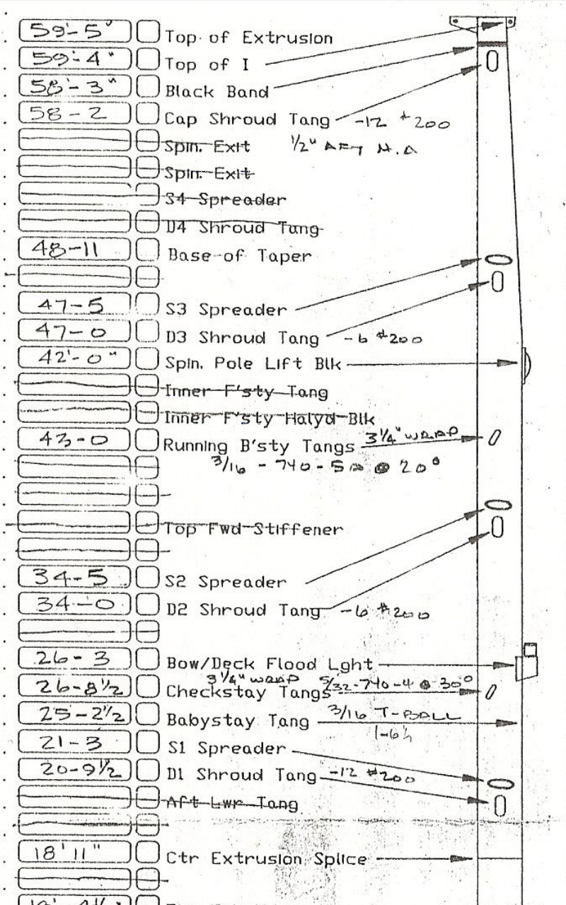

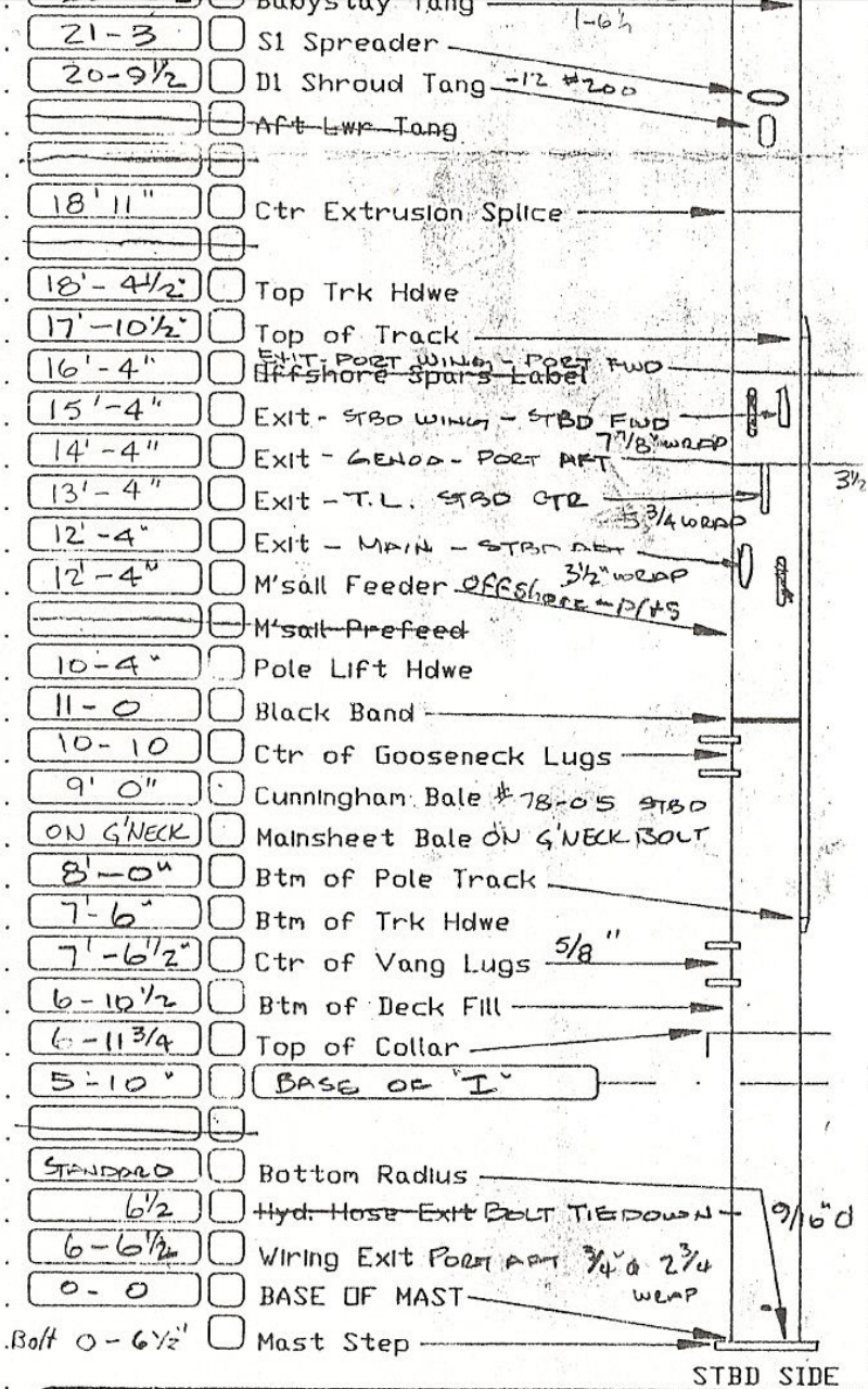

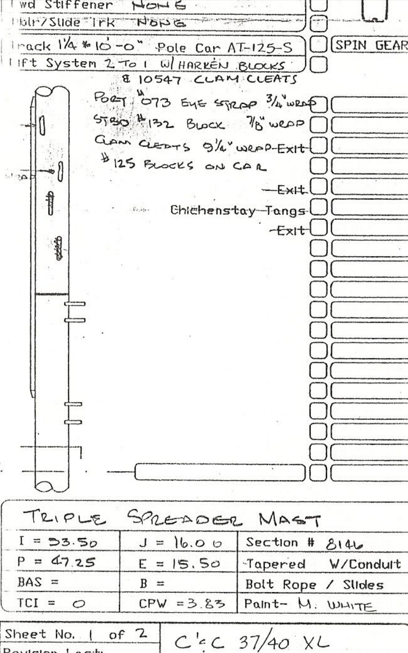

Greetings seafarers, I acquired this mast gratie. Have mast build diagram and need cut off for deck step. 3 speader "racing" rig made by Offshore Spars. Was going to put zspar original classic mast and raise roller unit above deck the way I like it. Figure if I get the fore/aft stays/height correct I could use dyneema port & starboard and replace spreaders 2&3 and new wire.

Actually I want to keep the 3 spreaders but expect to lengthen bottom 2 sets for 13' beam of Oc 400. Intend to get take measurements of old boat deck. Dyneema only temp, would purchase new stays.
