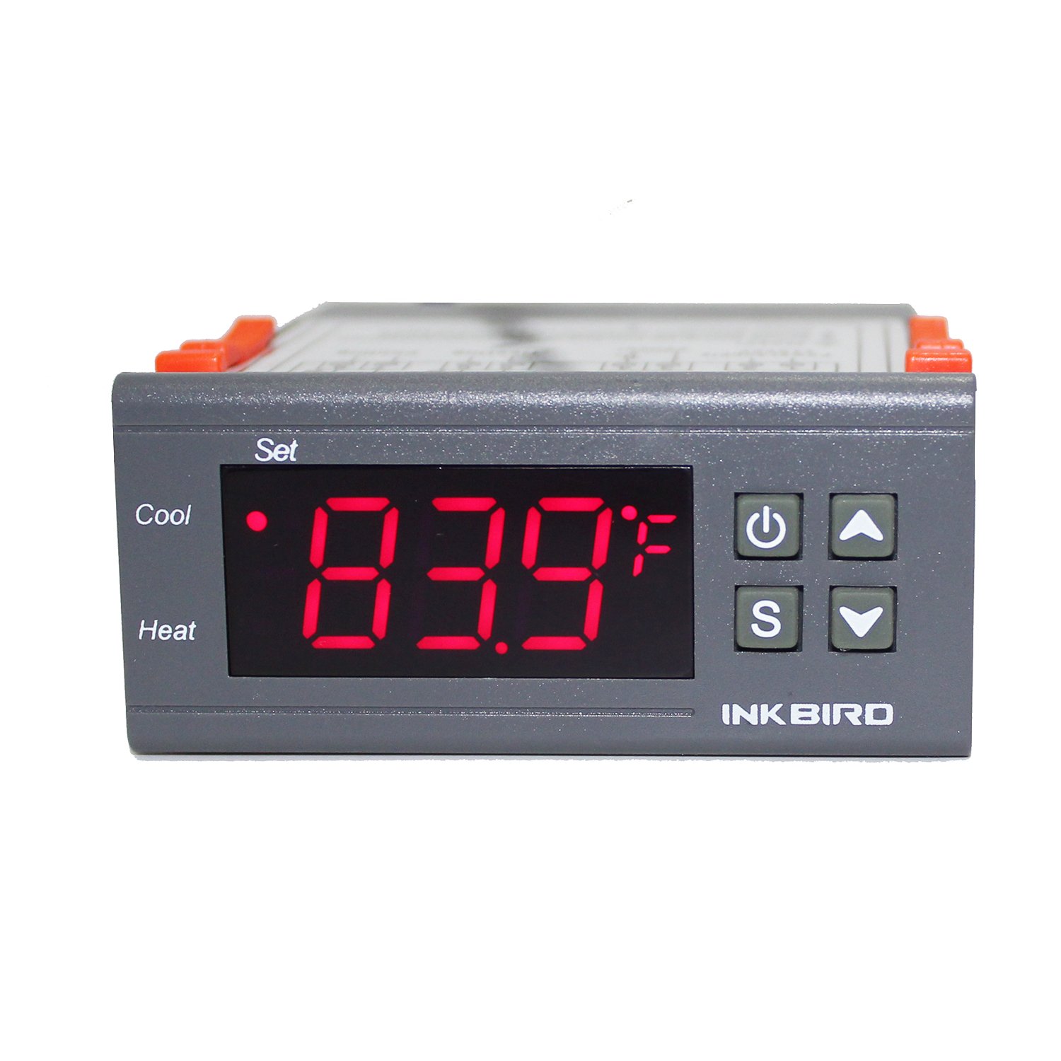

I have plans to install an Inkbird controller in mine, but it's a new refrigerator system, and I have to do some research as to how it's controller.
Here's the Inkbird - only about $15 on eBay or Amazon. Note that these are available in 110VAC, 220VAC, 12VDC, and also ºF and ºC.
I have a more complex plan to install two, one for normal operation, set at 38 to 40º F for the main box, and another that is active when the engine is running, set at 32º F, to chill things further without freezing them.
