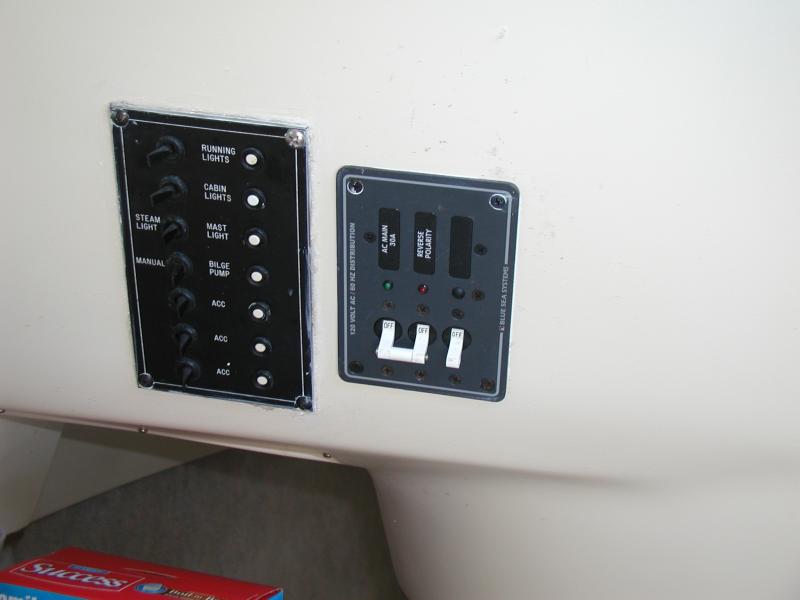

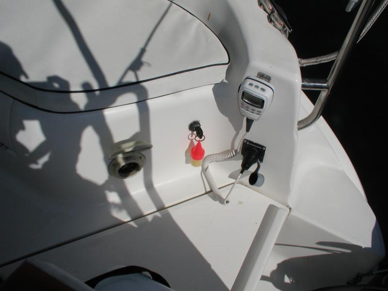

Here's a shot of the panel. One breaker for the shore power, the other for the battery charger. Second shot is power inlet. Standard outlets were installed on galley island facing table and behind aft berth, on starboard side on wooden bulkhead. Charger installed there too.
