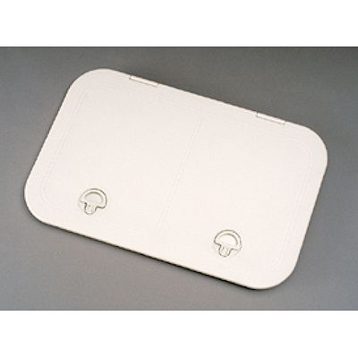

Hi All. I'm considering installing a small inspection hatch in one of the steps on the bulky fiberglass unit that serves as an engine cover / stairway on my 1981 H27. It would be used to access the raw water intake seacock for the inboard, rather than pulling that whole thing out every time.
Anyone foresee problems with that?

i would think as long as you don't weaken the structural integrity it should be no problem

Anything that makes pre-underway checks like checking the oil and coolant easier, so that you actually perform them every time, is worth doing. Oil should be checked before starting EVERY TIME, so you want it to be as easy as possible.
23,519
Inspection hatch? Have you considered getting a small door? We have one for our rw intake and another for our dipstick. Easier and less unsightly than a hatch. Could probably get one from Home Depot and stain it to look like teak.

Door, Stu?
How much room have you got on that 34?
But, thanks for prodding my imagination. It would be better to install a drop down door on the front riser if it's tall enough. An inexpensive rectangular inspection hatch would be better than trying to rig up something from HD...at least for me.
