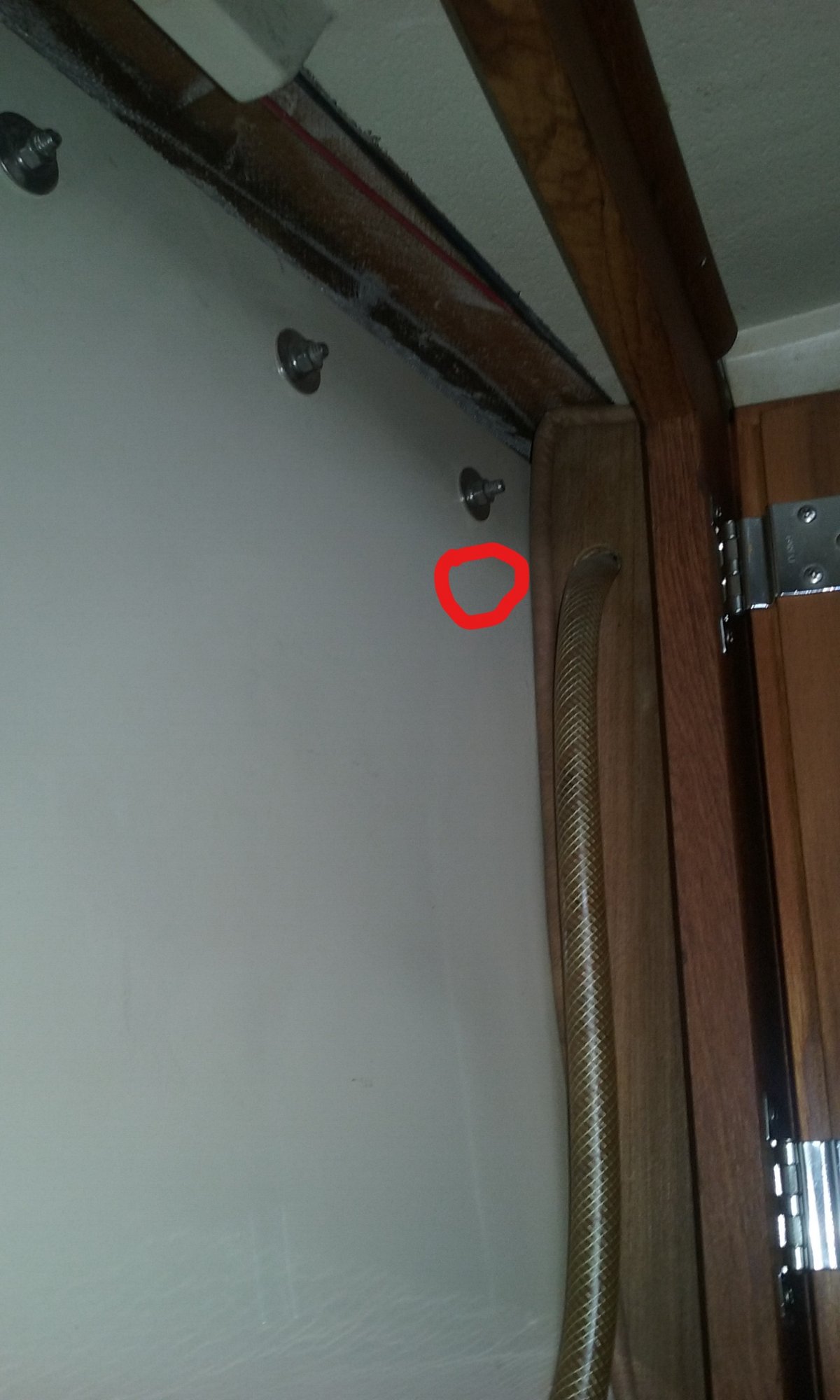

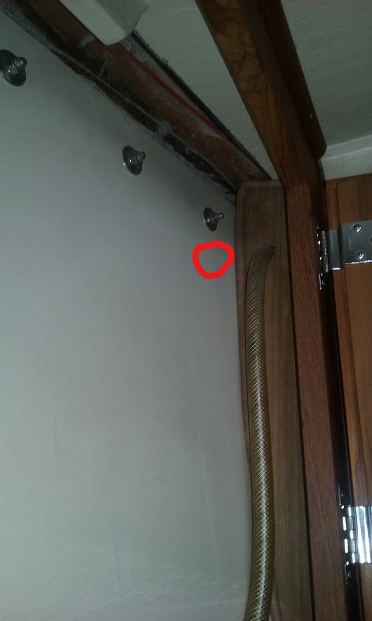

Peggie, I will be installing a clamshell to replace my stanchion holding tank vent. should the holding tank vent have a loop or just run down to the tank? my plan is to mount it right below the rub rail at the red circle. If I create a loop, it would have a very tight radius and I worry about kinking the hose. I have been told by the Galley Wench that the hose must not intrude into her cabinet any more than it is now or else.:kick:

The clamshell I plan to install has a removable screen. My thinking is that with the screen removed it will be almost as open as a regular mushroom but with the shell angled to the stern would keep much of the water from coming in when heeled. I am also not sure how much water could come in either way because when the vent is under water, the tank is unvented and cannot take on water. Seems to be a self-solving problem.:biggrin:

Although it's necessary to keep sea water out of water and fuel tanks, it doesn't matter if it gets into the holding tank...you can't take on enough thru the vent to matter unless you're in conditions that keep your decks awash for a day or longer. Because holding tanks need oxygen to prevent odor, holding tank vent thru-hulls should be open bulkhead or "mushroom" thru-hulls (see photo...can be any material except nylon)...No clamshells and the vent line should be as short, straight and as horizontal as possible...no loops.

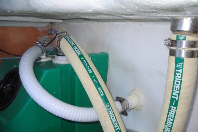

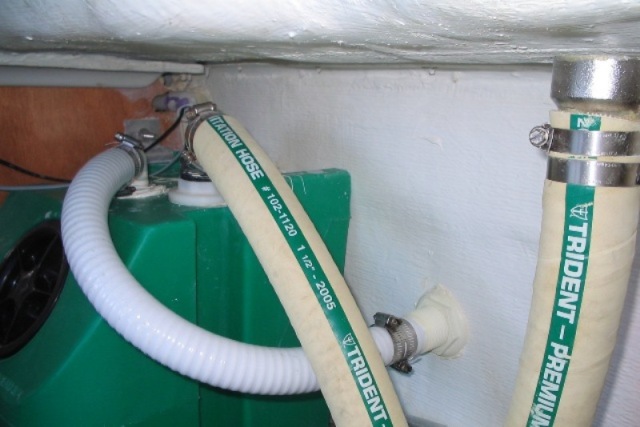

This is my B323 revamped to make use of the original thru-hull small hole and tank-top hole. The thru-hull is 1.25, big enough to stick the metal end of a garden hose into to back flush that 16 inches of hose. It is the best way I could work it in.HoldingTank.jpg
