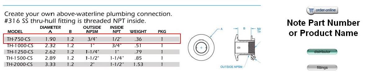

I just replaced the similar clamshell setup on my holding tank vent line with an 'open' thru hull fitting. I might still have it. The clamshell was part of the fitting. No need for more screw holes.
Jun 7, 2016
315
Catalina C30 Warwick, RI
Do you remember where you bought it from?

Do they come as one piece or is it something you screw into the hull over the thru hull?
They come in both flavours. I don't bother with a clam shell as the internal loop is high enough as it should take care of any waves slamming into the bow.

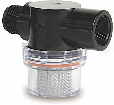

I added one of these in my vent line to trap insects. Read it in Practical Sailor.
