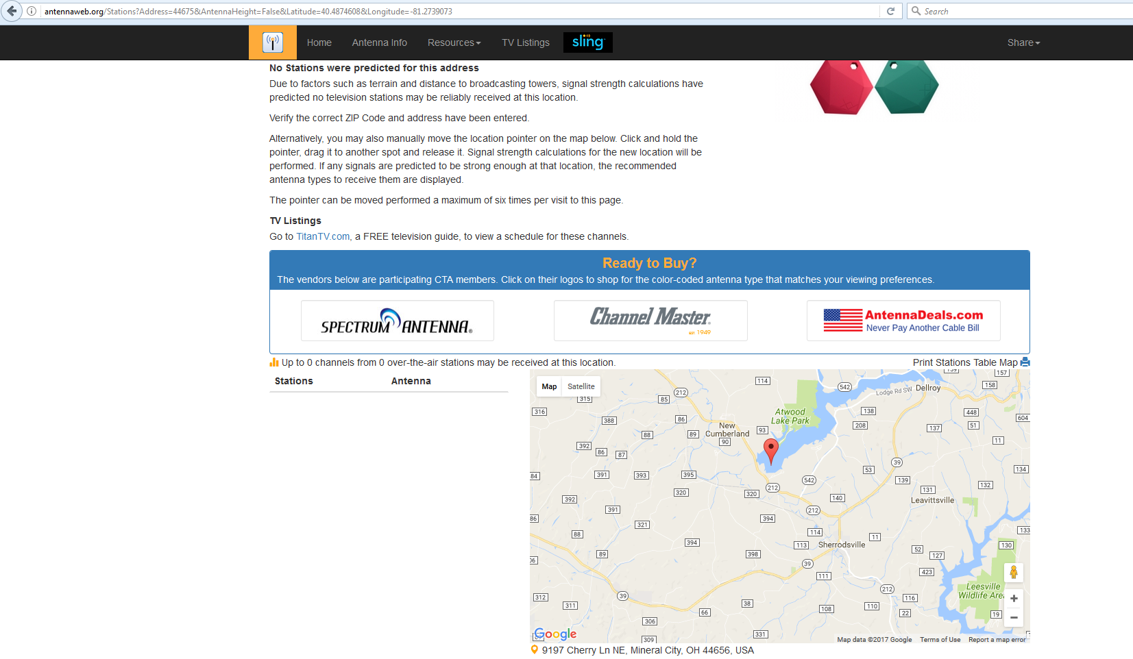

Before you waist any time or money trying to make this work check out antennaweb.org to see your possibilities. Its pretty accurate and will help you move forward or not. If you do have decent results it will help you pick the appropriate antenna.
https://www.antennaweb.org/

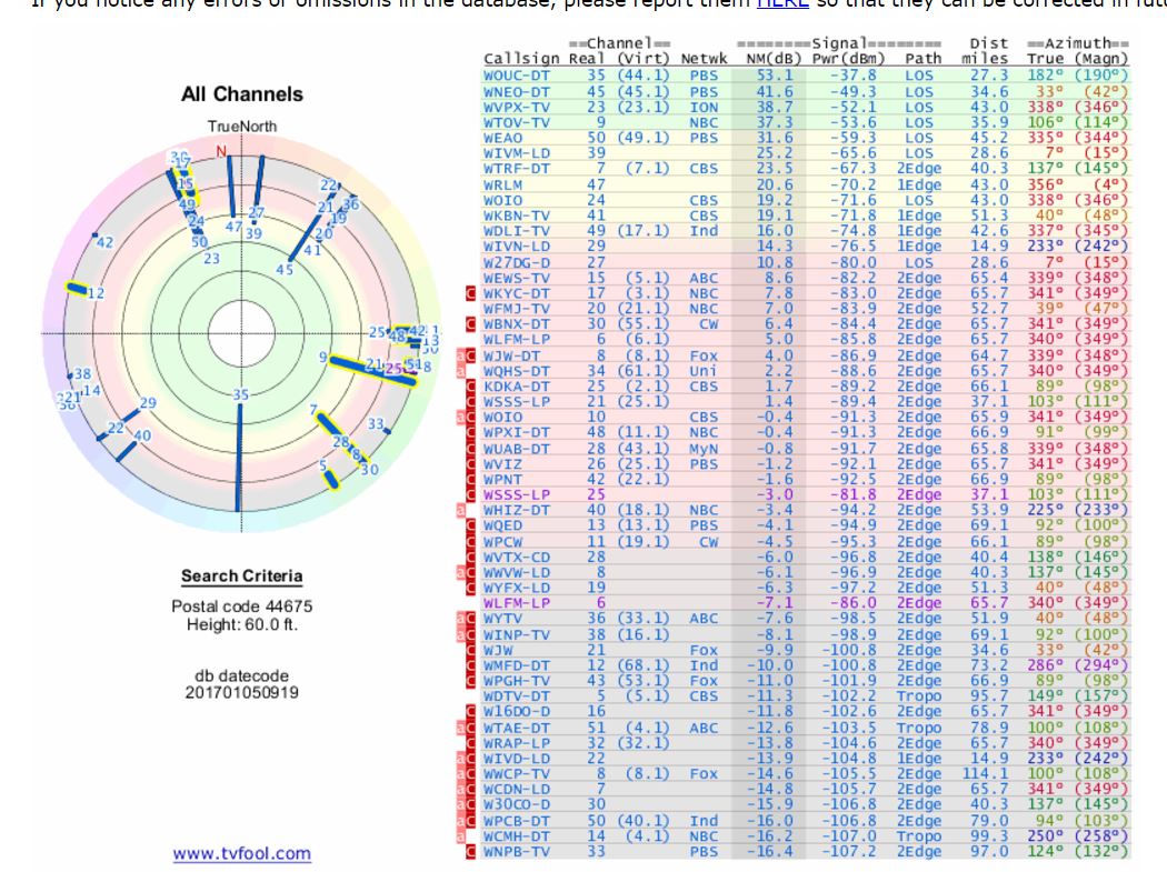

At sea level you will not be able to receive any OTA signals at that lake.. I just checked for 30' mast, and still nothing available by the Lake

You would be much better off going for something aloft based on this information and even at that it sure doesn't look hopeful, every try radio?
