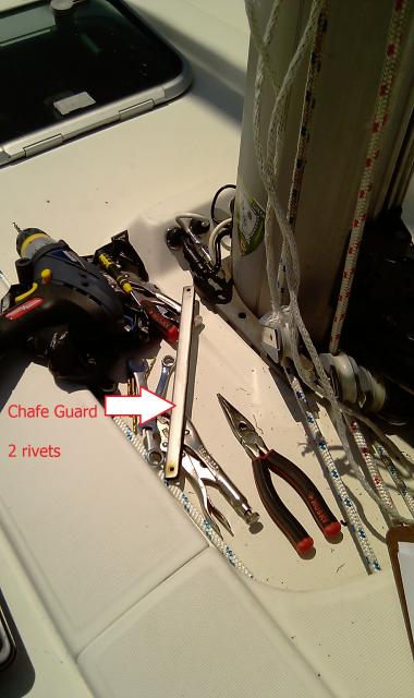

Drill out the two pop rivets and remove the chafe guard from the port side of the worm gear opening.

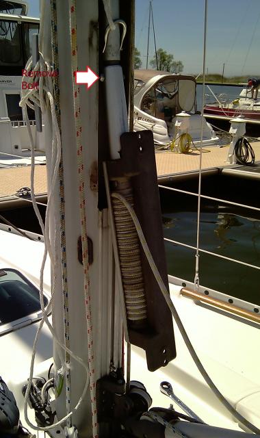

Rotate the gear/tube so that bolt you mentioned is aligned port-starboard.

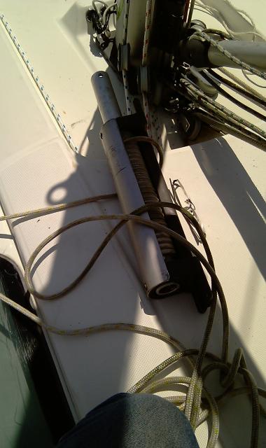

I just come back to get some more tools.
I got the drum out and that took some effort. That was wedged in there real good.
I removed the bolt. The problem is the drum won't separate from the foil.
Is there a trick or is brute force required???
Update: Liberal use of WD40 and a lot of tugging, it let go.

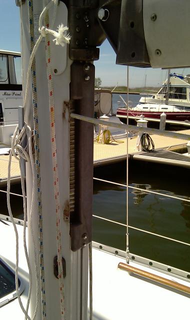

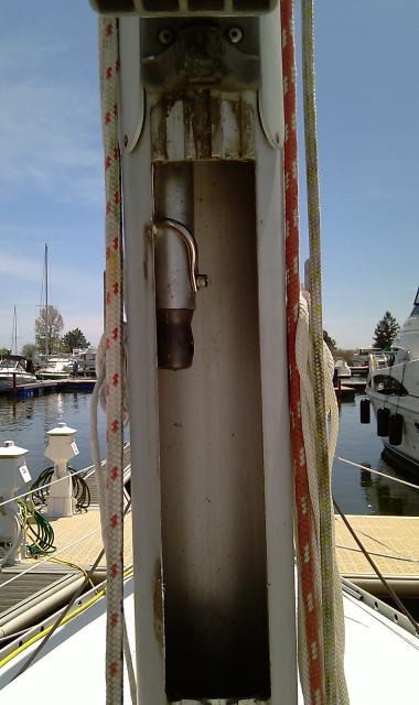

Added a few pics for those that might do this in the future.
Now the fun part of, disassembly.
Did you use any light grease to hold the ball bearings in place during reassembly??
Did you pop rivet the chafe guard back in place or bolt ??

Apr 27, 2010
970
Beneteau 352 Hull #276 Ontario
Thanks Again for the description. It helped.
I only used a bit silcone spray on the bearings and it turns much more freely than it did.
Still have to install the unit back in the mast. I don't know about yours but you can't slip a piece of paper between the unit and the mast, it's that tight.

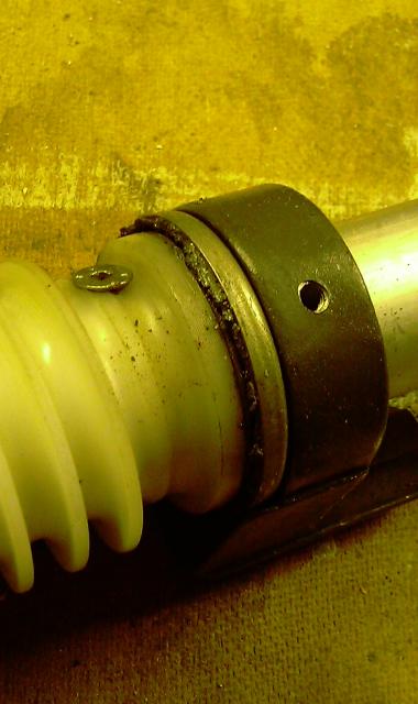

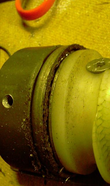

Yes, very close fit. The bearings, by design for a wet environment, are supposed to "cleaned" periodically with a fresh water flush. That is the reason you don't want to use a "wet" lube (grease, silcone) as they tend to attract/hold dirt. Your photo's look like the previous owner used a spray lube and that tends to get stiff in the elements. Dry film lubricants, such as McLube's Sailkote, should be used and not very often on the bearings. Now the plastic gear and the line that regularly wraps on the worm gear loves Sailkote.
